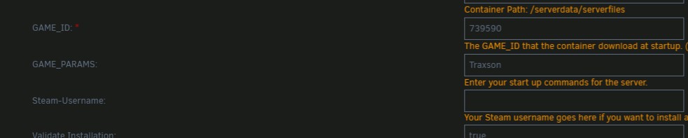

Also please post a picture from your Docker template for ECO.

What is this startup command in there 'Traxons'?
Can you try to remove it?
Should be possible but I have to look into this.
were would i find the start uo command
Can you see what I mean?
What is 'Traxons'?
Please try to delete this value.
Does removing the Value 'Traxons' from 'GAME_PARAMS' solve the problem?
And yes it should be possible to delete everything and start fresh with your old save:
  1. Stop the Container
  2. Go to your eco directory and save the folder 'Storage' somewhere locally on your computer
  3. Delete the Container from Unraid and also delete the folder 'eco' in your 'appdata' directory
  4. Redownload the Container from the CA App and wait for it to fully start up
  5. Stop the container
  6. Delete the folder 'Storage' that lives in your 'eco' folder and copy it in your 'eco' directory it with the locally saved folder from step 3
  7. Start the Container
