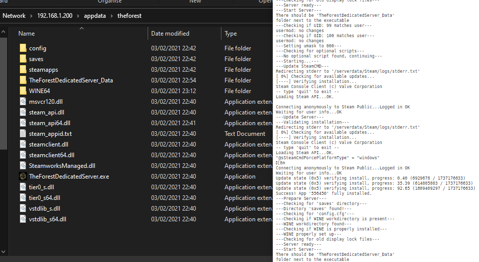

Hi there,
Hopefully you can help me out with this one, ive looked everywhere but struggling. the error is below.
I got the forest docker, made sure the IDs were correct from the pervious messages, added my token into the docker config.
the server downloaded no problems, however, when I restarted this was the following error:
---Start Server---
There should be 'TheForestDedicatedServer_Data'
folder next to the executable
Ive checked in the appdata folder, and appdata\theforest\TheForestDedicatedServer_Data exists and is populated with all the files, im confused as to why it doesnt recognise the folder in the same location as the exe. any ideas? thanks.

Regarding the template, Nothing was changed. the game ID is the same as what was on the template.
the logs are below. the --Start Server-- isnt the issue, its the line after it:
you can see it at the bottom of the log. thanks for the help

I can not reproduce this error, I also attached the log of a TheForest container installed from scratch: theforest.log
I can brows the server in the Steam Server browser and it's successfully started.
Have you installed a Cache drive in your server if so, is the folder where TheForest is located set to use Cache 'Only' or 'Prefer'?

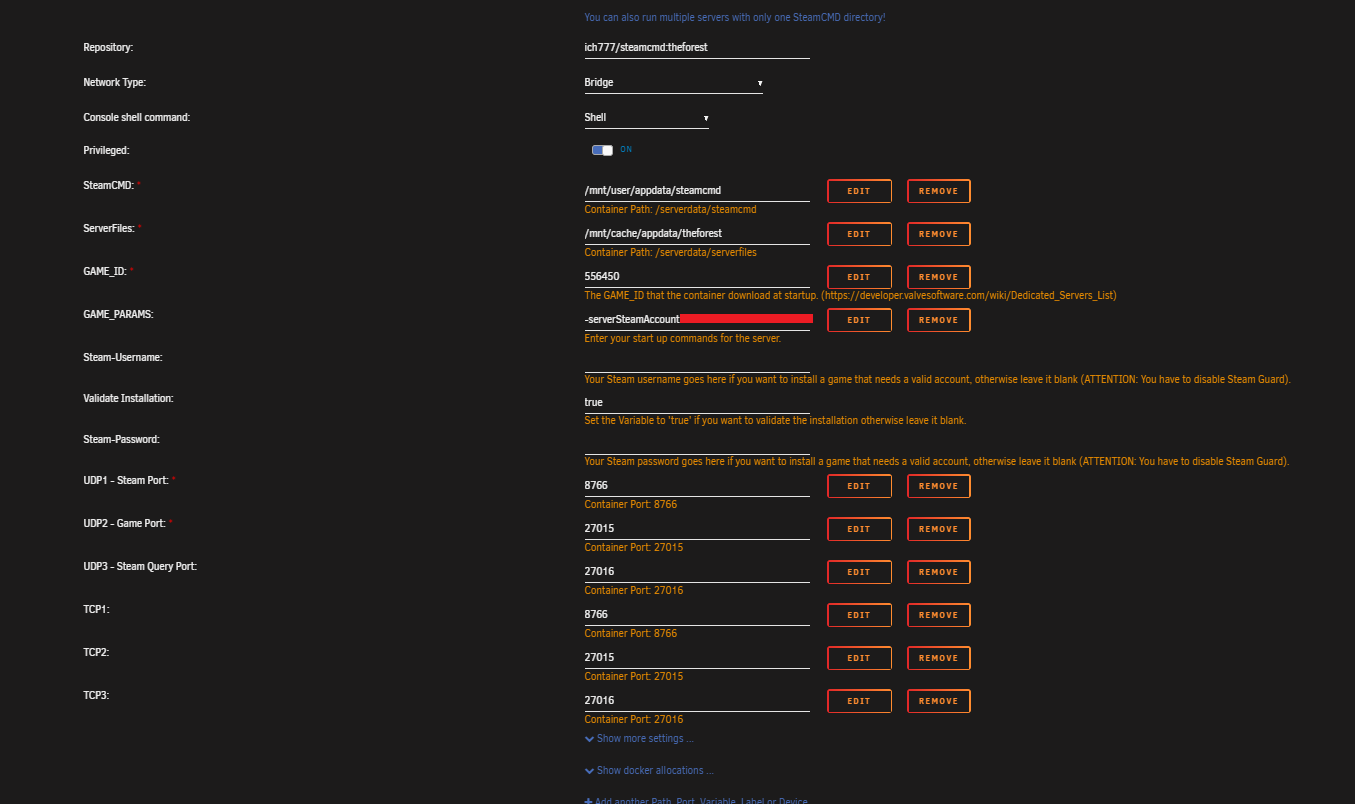

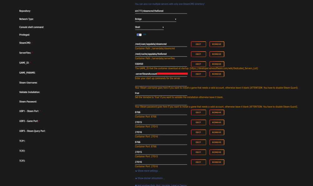

Please post a screenshot from the template itself.
Have you entered a Steam username and password, if so please remove it, the Steam credentials are only needed when they are marked as necessary with the red *. Forget that have seen from your log that you login anonymous.
EDIT: Try to start over, delete the container and also the directory 'theforest' that was created in your 'appdata' folder.
the cache settings are set to "prefer" could that be it? its moved the files off the cache and onto the main stoage.
attached are the template and the error. I can try changing the settings from "Prefer" to "Only" see if that solves it.
If it's set to "Prefer" then it should not move it off of the Cache.
If it's really moved off of the Cache that's the problem, since I think some files are on the Cache and some files on the Array and so it basically can't find the files on the Cache drive even if it seems like if you browse the files that the files are on there but they are actually spread over multiple disks and that's what TheForest doesn't like.
If you do that you have to run the Mover so that it actually moves the files back on the Cache.
EDIT: And because I've saw it you don't have to put the TCP ports in the template, they are not necessary.
right, so I left it on "prefer" and checked all the files. They were all in the correct location on the cache drive.
I went ahead and deleted the docker, backed up my config and save files and deleted all files regarding the forest and steamCMD.
pulling it fresh from the community center seems to have worked. I modified the config file to double check and it all seems to be working again.
thanks for the help. its a really strange one. dont really know what caused it since I deleted the forest folder yesterday and redownloaded it from the community center, but I didnt delete the steamCMD folder. however, this time it worked.
