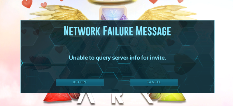

Hi, i'm trying to get the ark survival evolved server to work but all i can get is "unable to query server info for invite", the server shows up in steam but whenever i connect i just get the previous message. i'm using all default settings except the steam port is 27016 instead of 27015 and the RCON port is 27021. i did also try with the steam port as 27015 as a testing step but that didn't seem to fix it
If you need to change any of the port mappings they need to be deleted and recreated not just changed. I would recommend deleting that container and starting with a fresh new install. I would advise that you also forward the UDP ports in from your router as well (7777&7778 by default).

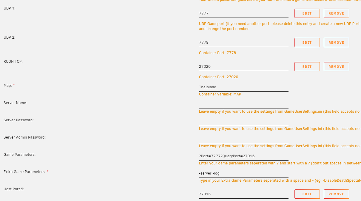

44 minutes ago, nmills3 said:
i've already tried that too. the container get's deleted every time i make a change by unraid anyway and port forwarding shouldn't matter because currently i'm just trying to get it to work on my local network
You need to make sure that you tell Ark what ports you are using eg. `?Port=7785?QueryPort=27064` and it's not just that you need to remove and re-add them, the port inside the container needs to be the same port exposed externally.  This is because ARK reports it's ports back to steam and you can't change the container port without adding a new port mapping.  So from a fresh setup, you should remove the query port and add a 27016<>27016 mapping.
In addition, there is no command line argument for the second UDP port (following 7777), it's always the first UDP port +1.  So when you tell Ark ?Port=7785 you are also saying UDP2 port is 7786.  Then ?QueryPort=27064 is obvious what it does.  If you want RCON (do you need this?), then there is more you have to do such as adding ?RCONPort=27075?RCONEnabled=True?ServerAdminPassword=<yourpass> to the commandline.

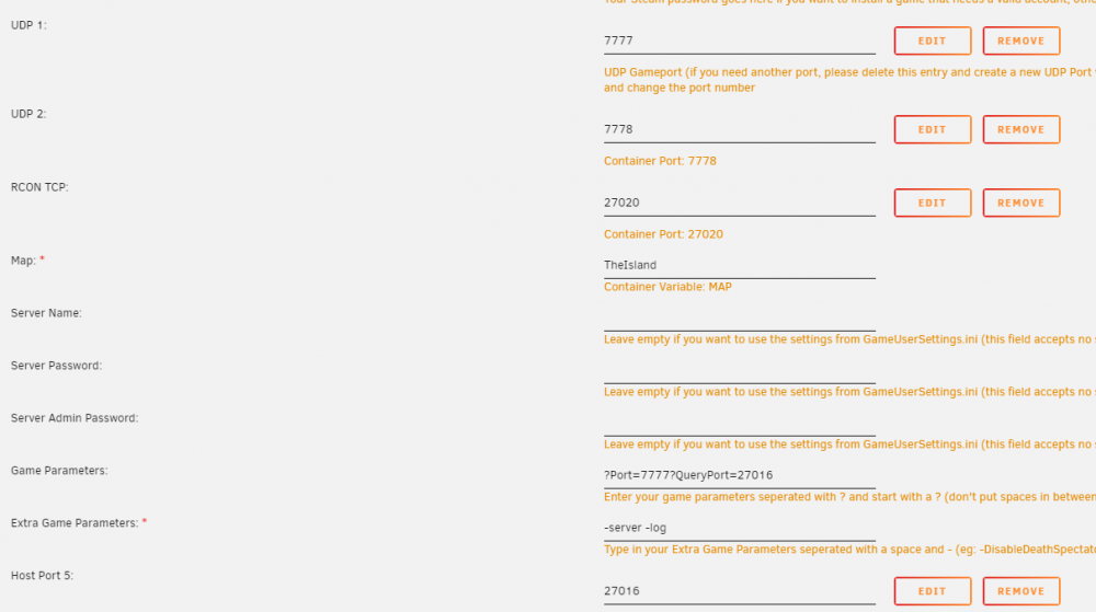

this what i've just set the settings as but now steam can't even query the server info to find it. my unraid server is running on 192.168.1.208 and i'm querying 192.168.1.208:27016 on my pc but i'm not getting anything in the steam server browser
Edit: So apparantly if I just query the IP 192.168.1.208 in the steam server browser then the server shows up but i still get the same error when joining the server about being unable to query for an invite
Edited by nmills3
Ok, so i've got my ark server responding on port 27016 but every time i try and connect i still get this error
Ok, so i can join my ark server through the in game server browser menu and it works fine but when using the steam server browser to connect i get the error. is there a known fix for this or am i just stuck with it this way?
Edit: Fixed it. "netsh winsock reset" made it start working via the steam menu
