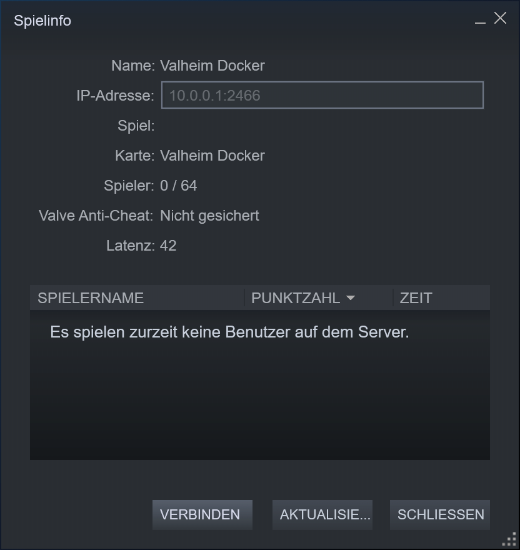

On 2/10/2021 at 2:54 PM, ich777 said:
ou also have to change the ports, to do that, delete the entry 'UDP - Game Port Range' entirely, then click on 'Show more settings ...' and change the 'GAME_PORT' to something different (keep in mind that if you set it for example to 2469 the next two port are also reserved to that game server that means 2469-2471 are now reserverd for that container) and at last create a new port entry like for in this example for the ports 2469-2471 UDP to do that click on 'Add another Path, Port, Variable, Label or Device' select 'Port' from the drop down and both at container and host port '2469-2471' and select 'UDP' at 'Connection Type', click on 'Add' and 'Apply' and the container should start up.
Now the last thing you have to do is open the corresponding UDP ports in your Router/Firewall, like in this example: 2469-2471 UDP.
I've tried the above by changing the GamePort to 2466 and removed and created a new line for UDP 2466-2468.
Opened the port on the router but it doesn't appear in the server list. Both ingame and steam.
Any other tips i could try?

2 hours ago, Joop said:
No i was not able to find it in the list, the old one that is running default is appearing in the list.
Are you sure that you entered all right, I now tried it and I just can see it fine in my server browser (please note that you have to enter not the port that is displayed below, you have to enter the port 2467 since the serverport +1 is the query port):
