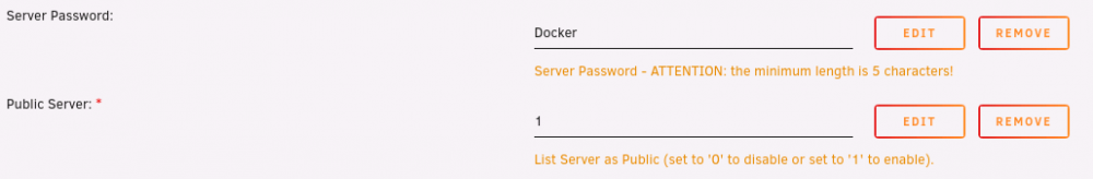

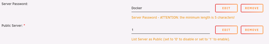

I still think you should remove the "public" property and clearly state that password is required however! :)
The public property is still in there but if you look at the password I have removed that you can leave it empty (I won't change too much because this game is in pretty early alpha and I don't know what changes next).
