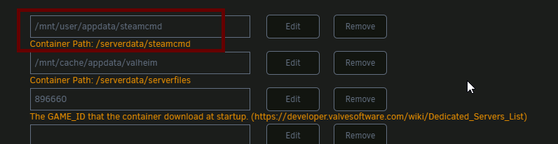

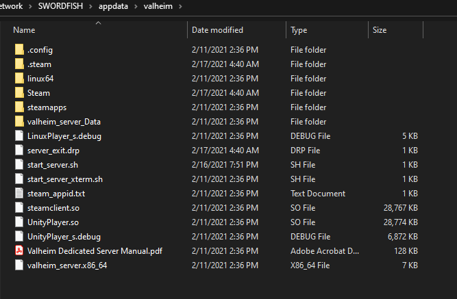

@ich777 I don't have a backups folder in my main Valheim directory. Is this something new that you added?image.png.c1a011a6099db2b4517cdde10f0a446f.png
I also just noticed that a couple of my different game servers share the same steamcmd directory. Could that cause problems? Should I have each container use a different steamcmd directory? I apologize, I should have noticed that before and looked into it.
Then you have to force an update of the container of the Docker page (looks like you have the old version).
That is actually a feature, you can share SteamCMD over multiple container since it's only needed at the startup of the containers and can be used from multiple containers at once. ;)
