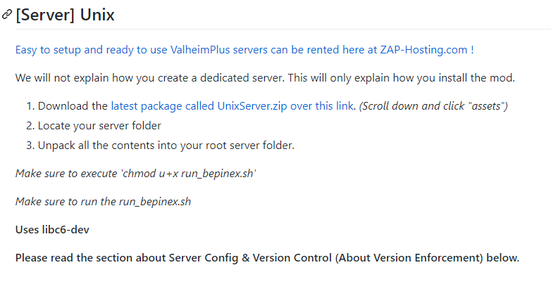

For ValheimPlus when I enable it on docker configs should I do something else? I really don't understand why no settings apply not only the carry limit but everything else about valheimplus..
I don't know if these steps are required too with the docker installation..unix.PNG.8c5c9b0e6af093eb4c6f8d09c92b317d.PNG
No these steps are not necessary because the container does that for you, also the container even checks for updates on every start/restart of ValheimPlus.
I really can't tell why it's not working but other people gere are running it and everything seems to work fine for them.

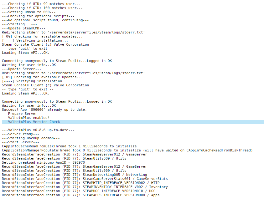

I'm stuck in some sort of steam boot loop following the server update - is anyone else getting a similar issue?
Connecting anonymously to Steam Public...Logged in OK
Waiting for user info...OK
Update state (0x5) verifying install, progress: 0.40 (4194304 / 1051291779)
Update state (0x5) verifying install, progress: 23.22 (244075002 / 1051291779)
Update state (0x5) verifying install, progress: 58.42 (614155467 / 1051291779)
Update state (0x5) verifying install, progress: 93.19 (979748331 / 1051291779)
Success! App '896660' fully installed.
---Prepare Server---
---Server ready---
---Start Server---
[S_API] SteamAPI_Init(): Loaded local 'steamclient.so' OK.
CAppInfoCacheReadFromDiskThread took 0 milliseconds to initialize
CApplicationManagerPopulateThread took 0 milliseconds to initialize (will have waited on CAppInfoCacheReadFromDiskThread)
RecordSteamInterfaceCreation (PID 67): SteamGameServer013 /
RecordSteamInterfaceCreation (PID 67): SteamUtils009 /
Setting breakpad minidump AppID = 892970
RecordSteamInterfaceCreation (PID 67): SteamGameServer013 / GameServer
RecordSteamInterfaceCreation (PID 67): SteamUtils009 / Utils
RecordSteamInterfaceCreation (PID 67): SteamNetworking006 / Networking
RecordSteamInterfaceCreation (PID 67): SteamGameServerStats001 / GameServerStats
RecordSteamInterfaceCreation (PID 67): STEAMHTTP_INTERFACE_VERSION003 / HTTP
RecordSteamInterfaceCreation (PID 67): STEAMINVENTORY_INTERFACE_V003 / Inventory
RecordSteamInterfaceCreation (PID 67): STEAMUGC_INTERFACE_VERSION014 / UGC
RecordSteamInterfaceCreation (PID 67): STEAMAPPS_INTERFACE_VERSION008 / Apps
[S_API FAIL] Tried to access Steam interface SteamNetworkingUtils003 before SteamAPI_Init succeeded.
RecordSteamInterfaceCreation (PID 67): SteamNetworkingUtils003 /
RecordSteamInterfaceCreation (PID 67): SteamNetworkingSockets008 /
---Checking if UID: 99 matches user---
usermod: no changes
---Checking if GID: 100 matches user---
usermod: no changes
---Setting umask to 000---
---Starting...---
usermod: no changes
usermod: no changes
---Starting...---
---Update SteamCMD---
Redirecting stderr to '/serverdata/serverfiles/Steam/logs/stderr.txt'
[ 0%] Checking for available updates...
[----] Verifying installation...
Steam Console Client (c) Valve Corporation
-- type 'quit' to exit --
Loading Steam API...OK.
---Update Server---
---Validating installation---
Update state (0x5) verifying install, progress: 0.30 (3151074 / 1051291779)
Update state (0x5) verifying install, progress: 31.46 (330726495 / 1051291779)
Update state (0x5) verifying install, progress: 66.63 (700496295 / 1051291779)
---Server ready---
---Start Server---
