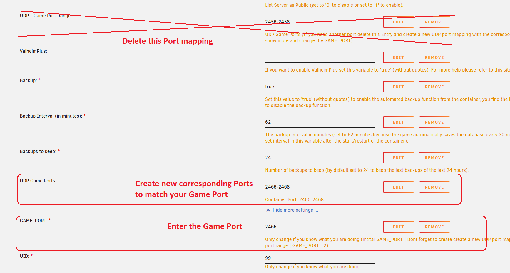

I'm wondering if anyone has been able to run multiple Valheim servers on the same box. I tryign to run two Valheim instances, one running Valheim and another running Valheim plus. They are both pointed the same appdata/steamcmd source. Each have their own Game Port and Game Port Range, 2456-2458 and 2466-2468.
The server running on the standard 2456-2458 ports works like a champ, no connection issues and shows up in the public Server browser, peachy.
The server running on 2466-2468 I can try to manual connect using the IP:PORT and I get the connecting screen for about 5 seconds before I get disconnected, never get to the server password prompt. Server appears to be listening to the correct port as I get to the connecting window. Log below

I'm also figuring out how to deploy a second instance of valheim for testing purposes and haven't already tried it but definetively I'll put an eye on this.
@ich777 Dude, I really thanks a lot all the work made on the Unraid and docker scene. I'm sure it's not as easy as it may seems as we actually just see the final steps where filling some gaps with the needed data to deploy it, but there has to be a lot of hard work behind it.
Two things have to happen (three really):
1 Delete the port mapping and create the corresponding new ones.
2 Tell the valheim server what ports you want it to use by providing the '-port' command line argument.
3 forward the correct ports of course.
Yes, but you do this with the Variable in the 'Show More Settings' section of the Template.
Keep in mind that for every container the Game Port itself has to be set in the GAME_PORT variable like mentioned above.
On 3/2/2021 at 9:17 PM, blure007 said:
2466-2468
This is the way you would do it (this is tested and working btw):
