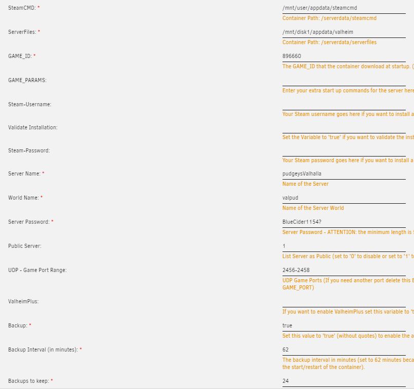

Hi and thank you so much for the container! I'm having an issue connecting to my Valheim server.
I have forwarded UDP ports 2456-2458 to my unraid server
Here's the log 10-15mins after starting the container:

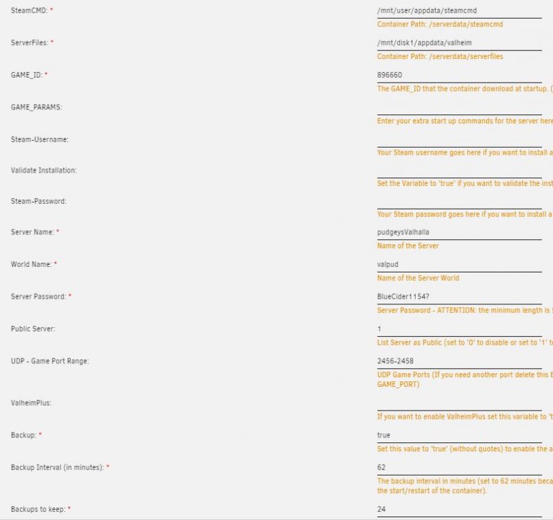

Here's a picture of my docker setup:
Any suggestions? I tried connecting to the server through the steam server viewer with <PUBLICIP>:2457 and <PUBLICIP>:2458
The log and the configuration looks good and indicate a successfull startup.
If your Router/Firewall doesn't support NAT Reflection then you can't connect from your local network with your PUBLICIP:2457, I would first try to connect to with your LOCALIP:2457
If you forwarded the ports correctly in your Router/Firewall 2456-2458 UDP (and only UDP) then you should be able to connect to the server from outside with PUBLICIP:2457
Was the server running before because I see you are using a old template, version of the Container, if it was running before eventually you are affected by the world destroy bug (I built in a backup function in the Container so that you can restore the world if needed - see the second recommended post in this thread on the top for more information).

I had downloaded the old template before but could never get the server working.
After seeing you say I had an old version I just removed the container / files completely and re-downloaded from the community app store. Used all of my old settings and it instantly started up 😃
Thanks so much again!

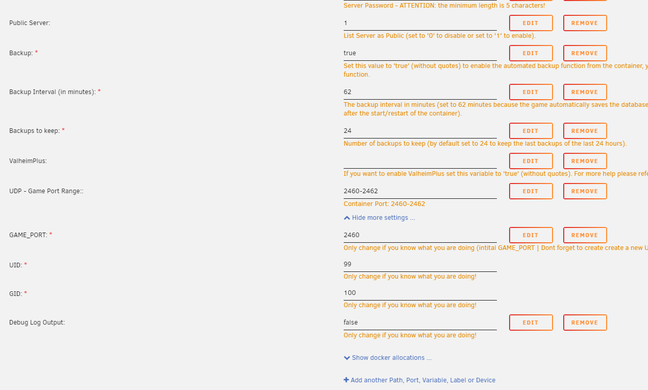

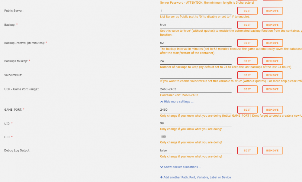

Tried searching this thread for help but search wasn't much help.
Trying to run a second server for Valheim and am just getting this loop
Connecting anonymously to Steam Public...Logged in OK
Waiting for user info...OK
Update state (0x5) verifying install, progress: 0.20 (2102498 / 1051599543)
Update state (0x5) verifying install, progress: 18.02 (189461290 / 1051599543)
Update state (0x5) verifying install, progress: 49.91 (524853563 / 1051599543)
Update state (0x5) verifying install, progress: 82.05 (862813403 / 1051599543)
Success! App '896660' fully installed.

Only settings different from default are game port range (2460-2462), game port(2460) and folder location for server files.
The installer metions no need to change/add a second steamcmd directory.

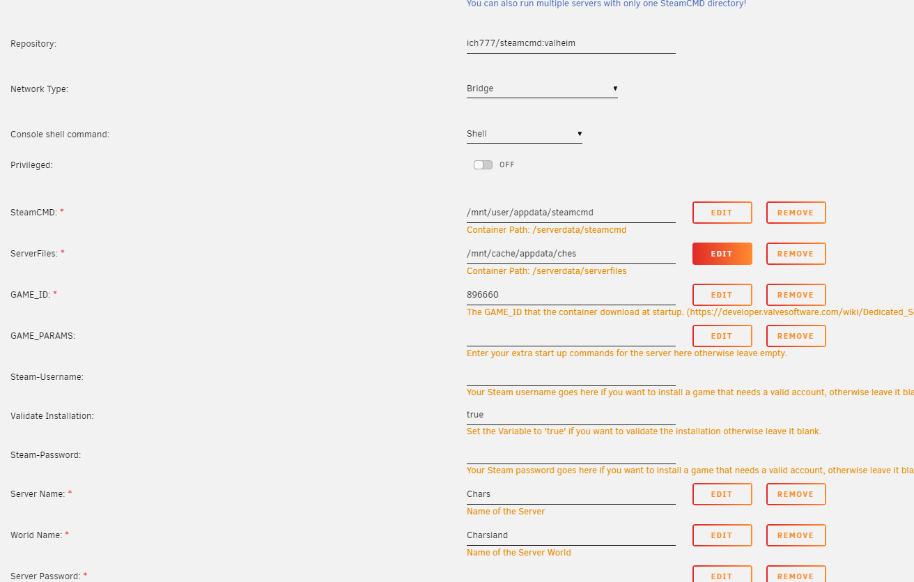

Can you post the config for this container?
Yeah,
Repository:	ich777/steamcmd:valheim
Network Type:	bridge
Console shell command:	shell
SteamCMD:	/mnt/user/appdata/steamcmd
ServerFiles:	/mnt/cache/appdata/val2
GAME_ID:	896660
GAME_PARAMS:
Steam-Username:
Validate Installation:
Steam-Password:
Server Name:	Chars
World Name:	Charland
Server Password:	***
Public Server:	1
Backup:	true
Backup Interval (in minutes):	62
Backups to keep:	24
ValheimPlus:
UDP - Game Port Range::	2460-2462
GAME_PORT:	2460
UID:	99
GID:	100
Debug Log Output:	false
Hey ich777,

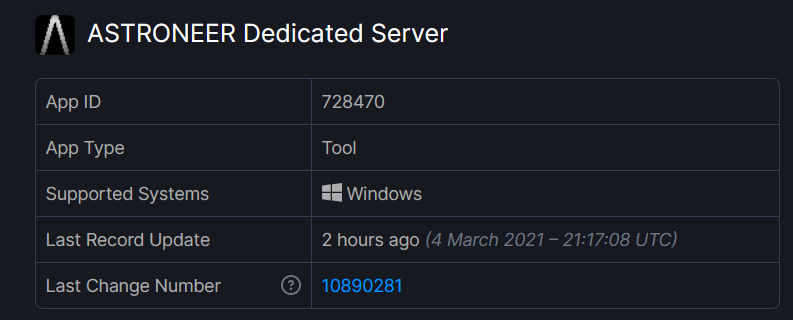

Would you be able to create one for an Astroneer Server? Or point me to directions on how to modify one of your existing steamcmd docker images to download it?  Thanks!
5 minutes ago, ptyler said:
Hey ich777,
Actually that's a game that I want a server for...
From what I've know the Dedicated Server for Linux hasn't released or am I wrong?
The Windows version of the Dedicated Server doesn't run stable with WINE.
If they release a Linux Dedicated Server feel free to contact me and I will create one.

can you post a screen shot. theres missing info i need to see.
Oh yeah I forgot it doesn't run on Linux yet. My mistake! I will keep an eye on it and report back if I notice the change. Thanks for the quick response
7 minutes ago, theagain said:
Everything looks good in the config as far as I can tell. Try removing true from verify.
Edited by Spectral Force
Was  one of the first things I had tried. Still continues to loop.
Thinking it's to do with the game ports which is the only thing that's really changed.
Defaults are already in use though
