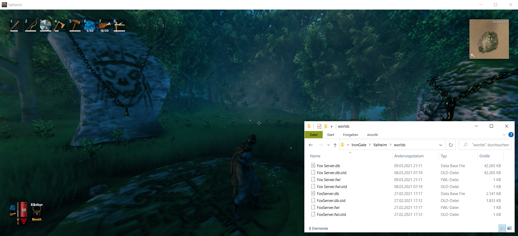

Ok to confirm.
If i restore my backup directly back into the appdata folder. files are 42mb each. if i start the container and join the server. the files reset to 3mb.
if i restore locally then copy over my world works. However all spawn points are reset.
You have to ask on the Valheim Discord/Forums/Steam Community Hub if this is a known problem...
Have you checked the Docker template if everything matches your save game?
I don't think it's a problem with the container since I run it also and have no problems so far.
the docker template hasnt been changed and names etc match up.
my container just stopped and now the game save is 3mb again and its reset!!
i dont think its your docker. must be the game some how. just a bit gutted after time ive put in. copy of my save if you want to look.
Don't know if that looks right to you (on the right side is water and on the left it goes up I think a mountain... :D, doesn't reset in my case):
8 minutes ago, ich777 said:
Don't know if that looks right to you (on the right side is water and on the left it goes up I think a mountain... :D, doesn't reset in my case😞
doesnt look right. the server is Fox Server
the very old one is FoxServer. At lest i know my backup issue was caused by a conflict with CA backup. Think ill have to accept that ive lost around 4 hours of game play
Edited by dfox1787
But Fox Server is 42 MB and FoxServer is 2MB...
yes so the one that is correct is the 42mb one
