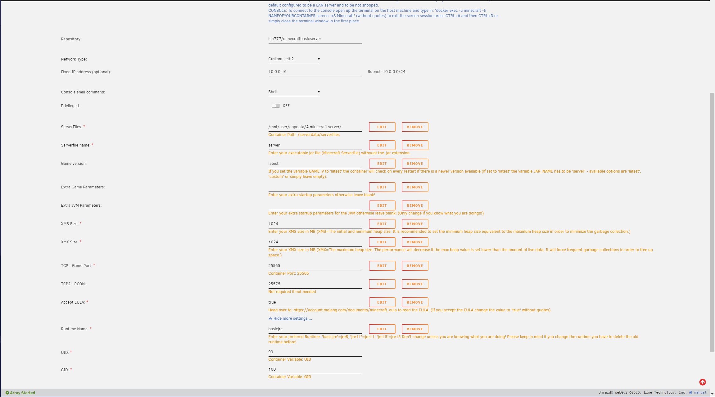

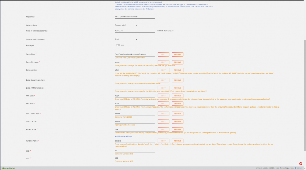

soo, now i dont have any server, when i try install the docker nothing happening. I dont know why... The docker dont install any files for the minecraft server. My settings are like this: image.thumb.png.85bf0b2c791a500778d612c286cd835b.png

1 hour ago, sebbi said:
---Something went wrong, can't download Runtime, putting server in sleep mode---
Have you stopped the container  at the very first start once?
Please look in your gamedirectory if there is a file called runtime in there, if so, please remove this file and restart the container and wait for it to finish the startup.
Have you any kind of firewall or something like PiHole in front of the Server? The Minecraft server needs exclusive internet access on the very first start since it tries to download the runtime and minecraft itself.

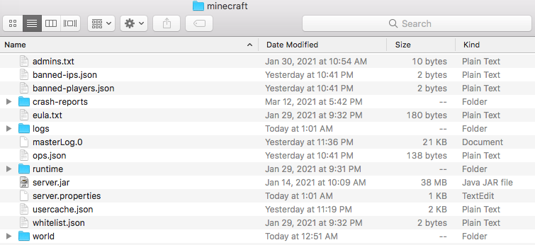

Running a Minecraft server, and I decided to edit the server.properties file while the container was off. I've done it several times before. This time, however, none of the users are able to connect to the server after I restarted the container, and the log reads:

You can see in the attached image that server.properties is in its correct spot in the Minecraft folder; furthermore, I checked through the file to make sure all the syntax was correct. What could be the issue?
Can you try to delete the 'server.properties' file (save it somewhere save before you delete it)? Eventually the permissions are messed up.
