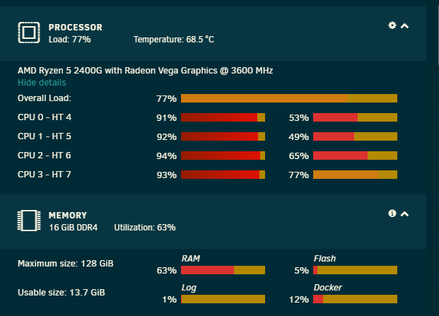

why is valheim killing my server? only just started to happen.
I don't know but it don't have to be Valheim, have you tried to connect to the Valheim Server?
Have you noticed that you also running out of RAM and this can cause the problem too? 13,2GB from 13,7GB are used (btw. the 10% for Valheim are just normal should be about 1.4 GB)
It's also eating up some resources and  on my system but I have 12 threads instead of your 4 threads.

no it wouldnt let me connect. good after a restart. whats the best way to troubleshoot whats using all my system resources next time it happens? did the same last night.

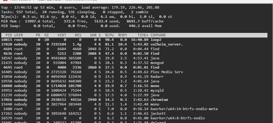

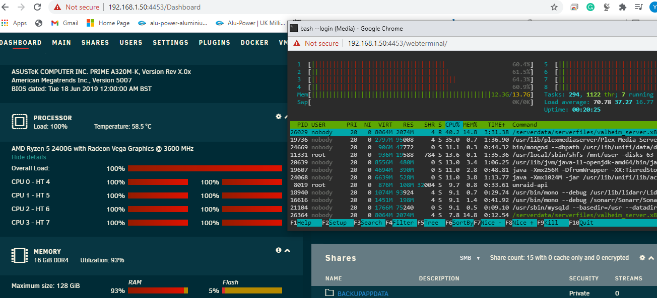

literally just happened again. the htop cpu usage doesnt match the unraid dash.
no vms running
no idea whats going off atmCapture99.thumb.PNG.45dd536f6f400ddd1d87abbf41dd9ec5.PNG

Can you try to go to the Docker page and see how much RAM it consumes?
I've seen this in the past with thesting the 'amdgpu' drivers with my Jellyfin container that makes use of the iGPU from the APU for transcoding that the Unraid Dashboard doesn't always reflect the usage from htop.
This seems like a memory leak of some kind...
Can you try to shutdown the container and set up a fresh install of Valheim for testing purposes (just be sure to give it another Name, path to the Gamefiles and other ports - you don't have to set up the ports completely correctly since it's only for testing).

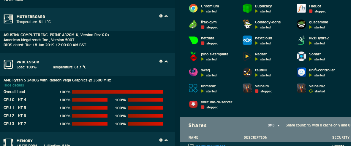

yeah can do,
atm 100% cpu with valheim running. If i turn off plex for example leave valheim off my cpu is still 100%. stopping the valheim container cpu drops.

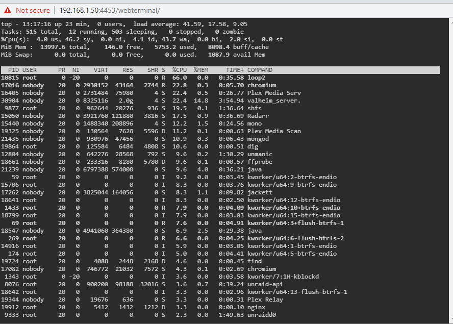

Can you try to do a 'top' instead of 'htop' and post the screenshot here when this happens again?
I really can't see what's causing that...
16 minutes ago, ich777 said:
Can you try to do a 'top' instead of 'htop' and post the screenshot here?

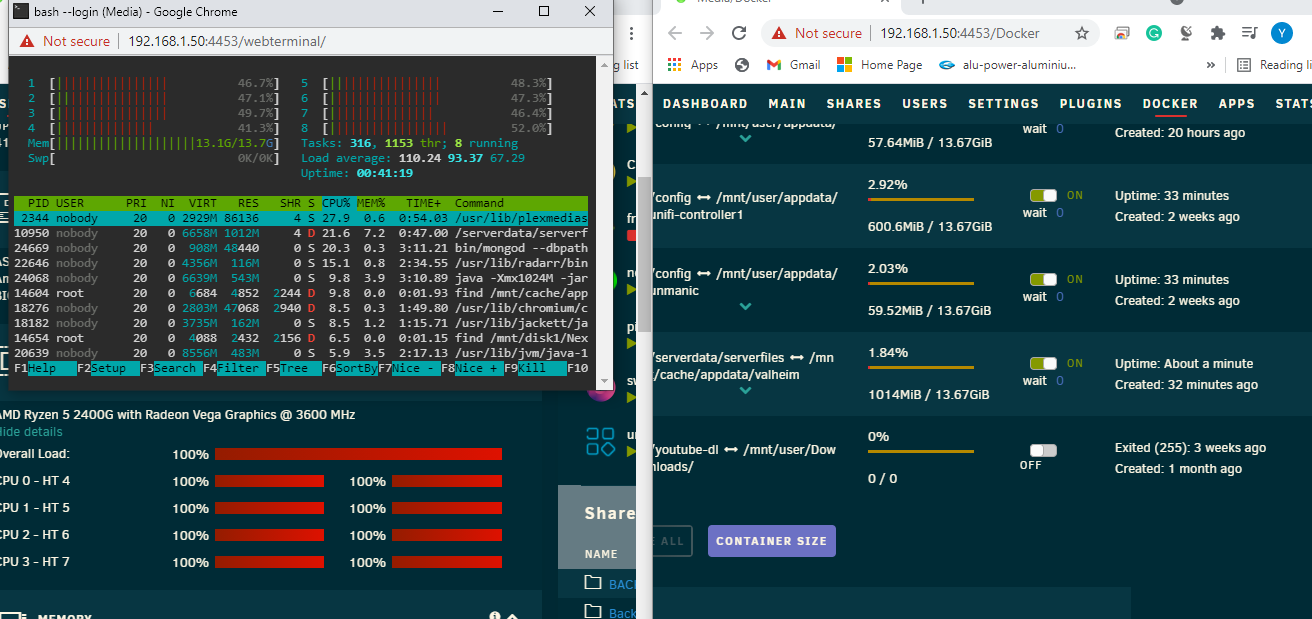

5 minutes ago, dfox1787 said:
what is loop2?
Loop 2 should be the mount point for the Docker image if I'm not mistaken.

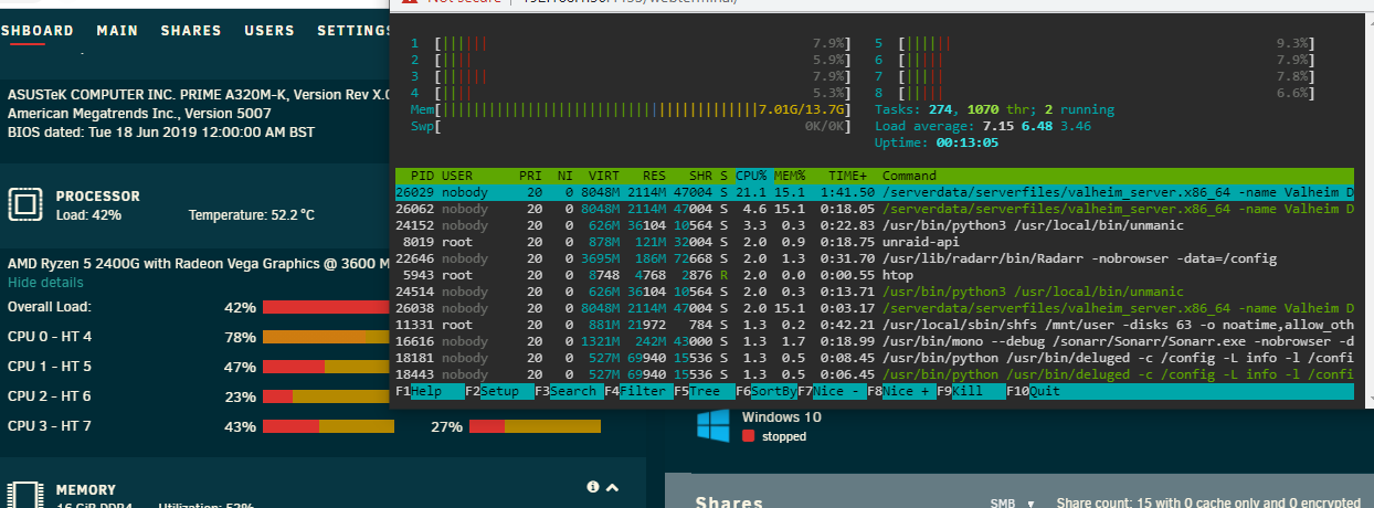

***update*** ive deleted my docker image and recreated it on a new drive and touch wood so far everything is running ok
ignore the 4 cores on the left they are dedicated to unmanic
