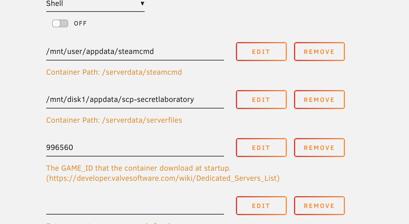

I am trying to install SCP Secret Laboratory for my son and I am just completely LOST!
I open console and run 'docker exec -u steam -ti SCP-SecretLaboratory screen -xS SCP' and I am seeing the error:
Can't find game executable "SCPSL.x86_64", the working directory must be the game directory
I have no clue what I am doing here or where to even START to get this going for him. Is there a tutorial or a walkthrough, or a video or ANYTHING to help?

The container says it is up and running. Here is the log
---Checking if UID: 99 matches user---
---Checking if GID: 100 matches user---
---Setting umask to 000---
---Starting...---
---Update SteamCMD---
Redirecting stderr to '/serverdata/serverfiles/Steam/logs/stderr.txt'
[ 0%] Checking for available updates...
[----] Verifying installation...
Steam Console Client (c) Valve Corporation
-- type 'quit' to exit --
Loading Steam API...OK.
Logging in user 'etherbunny337' to Steam Public ...
Logged in OK
Waiting for user info...OK
---Update Server---
---Validating installation---
Logged in OK
ERROR! Failed to install app '996560' (No subscription)
---Installing MultiAdmin---
---MultiAdmin sucessfully verified---
---Installing ServerMod---
---ServerMod sucessfully verified---
---Prepare Server---
---Checking for old logs---
---Server ready---
---Start Server---
[17:29:15] Using global config "/serverdata/serverfiles/scp_multiadmin.cfg"...
[17:29:15] Can't find game executable "SCPSL.x86_64", the working directory must be the game directory
[17:29:15] Startup failed! Waiting for 10000 ms before retrying...
My son has the game but I do not. I am just trying to install a server for him. Would I need to put his creds in?
I will look into this, I think there has something changed with multiadmin that I use in this container and the container is now not working anymore, will report back. ;)
Thanks for the log and report. :)

I tried it now on my server and can't reproduce this behaviour.
Have you installed a cache drive in your server? If yes to what is the Use Cache setting set for the folder where SCP is located in?
If no what path is set for your appdata and on which disk is it?
Have you changed anything else in the template (eventually a screenshot of the template would be helpful).
Here is my log: scp.log
I do have a Cache drive set up. 512 SSD.
I have not altered the template at all. Like I said, I am VERY new to this. I have left EVERYTHNG default minus my steam creds.
Is your appdata directory on your cache drive? Please go to your Share settings for the appdata directory and check to what Use Cache is set (please set it to "Only" or "Prefer" since the container won't work when the files are spread across multiple disks).
The problem in your case is the location where the files are located, once we figure this out you can actually play on it.
