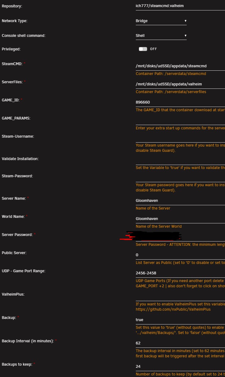

I have been struggling to get the Valheim docker working.  I *think* I followed the setup guide properly, but I am unable to connect to my dedicated server on my home network.  I've attached  screenshot of my docker settings.  I've also quoted a copy of the entire log, which appears to be showing something weird that I didn't seen anyone else mention (6th line from the bottom):
You are having the game set to Public '0' please set this to '1' and you will be able to reach the server from your local network and also from "outside" (don't know why this has everybody set to 0 when the default value is 1).
Also with which port are you trying to connect? The default would be LOCALIP:PORT+1 = LOCALIP:2757

First off, I'd like to apologize for not saying thank you to ich777 first prior to asking for help.  This is a great community and members like ich777's willingness to create such dockers and maintain them is very much appreciated.  Thank you.

Should the log not be longer?  Mine gets to there and that's it, but the logs I'd seen other people post seemed to have much more in them.  Even when I left the docker running overnight, there was nothing more added to the log.
I changed to 1 as you directed and I'm still not able to connect.  As for why I changed it (and why likely others have, too) is I misinterpreted the description for that value and thought that was how you made it a community server, which I didn't want.  I thought public=community.
I am attempting to connect to port 2457.  If we pretend my server's static IP is 192.168.1.10, then I'm entering 192.168.1.10:2457 in Valheim when I click "Join IP".
Is there anything else you can suggest I check or change?  I will try deleting the docker and the appdata folders and starting over, but I'm not optimistic at this point that I'll have a different outcome.
One more bit of info, when I attempt to connect I get a "connecting" screen for ~8 seconds, then I get a "disconnected" message.  Not sure if that's unique to anything, or if that's the generic fail screen.
EDIT:  On my local network, if I ONLY enter the IP address (and not a port number) I can connect to the server.  When I add a port number that's when I get can't connect and get the "disconnected" message.
No, this is the basic log.
You can set Debug log to 'true' but that will completely bloat your log (in the template click on 'Show more').
Yes, the log will not get longer, but this is a good indicator that everything is working.
Please try the Steam Server Browser (View -> Server -> Favourites -> Add Server -> Enter your IP eg: 192.168.1.10:2457 -> Add server -> Refresh).
If you try it from ingame it's really buggy...
Keep in mind this game is in early alpha and such bugs are very likely to happen. Your server is definetely running and people can connect.
EDIT: Please keep in mind, most questions here asked related to the game and not to the container itself, so this questions should be asked on the Valheim Discord/Forums/Steam Community Hub.
Also please read the second recommended post on the top of the Thread.
You were 100% correct.  I didn't know about steam's server browser, but that worked perfectly for me connecting over my local IP and my external IP from within my house.

3 minutes ago, ich777 said:
You have to add the manually add the Variable otherwise it will not show up in the template, but it's enabled by default...
You can check that if you open up the log and see if you got messages that say:
UPDATE CHECK: ---Nothing to do, Valheim up-to-date---
If you get this messages everything is working and the container checks for updates.
Some routers are not capable of NAT reflection and then you can't connect with your external IP from your local network.
If you forwarded the ports correctly (all 3 ports UDP) in your router/firewall try to connect from externally to your server with your public IP.
Thanks for the clarification. I see exactly that in the logs, thanks for the awesome work. My Valheim server has been rock solid since day 1 using your docker (knock on core wood).
