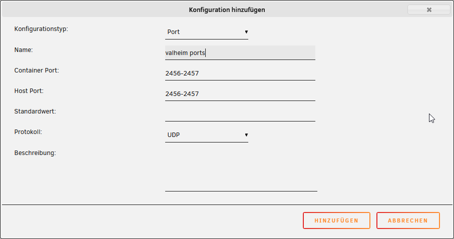

Hi guys, does anyone know how to route the valheim gameserver docker through a vpn container?
I am stuck to mobile broadband, so I can't foward my ports. But I heard it should be possible if the gameserver is routed through a vpn that supports port fowarding.
My binhex-delugevpn is running fine with Private Internet Access, thx to Spaceinvader One ☺️
But if i try to route the valheim docker through it, it doesn't connect.
I added the valheim ports 2456-2458 to the delugevpn docker as described in Spaceinvader One's video "How to route any docker container through a VPN container":
I also set the valheim network to "none" and added "--net=container:binhex-delugevpn" to the extra parameters.
Is it even possible to route a gameserver through delugevpn?
If not how can I make the valheim server work with vpn? Do i need to set up a virtual vpn router?
Any help would be much appreciated 😟

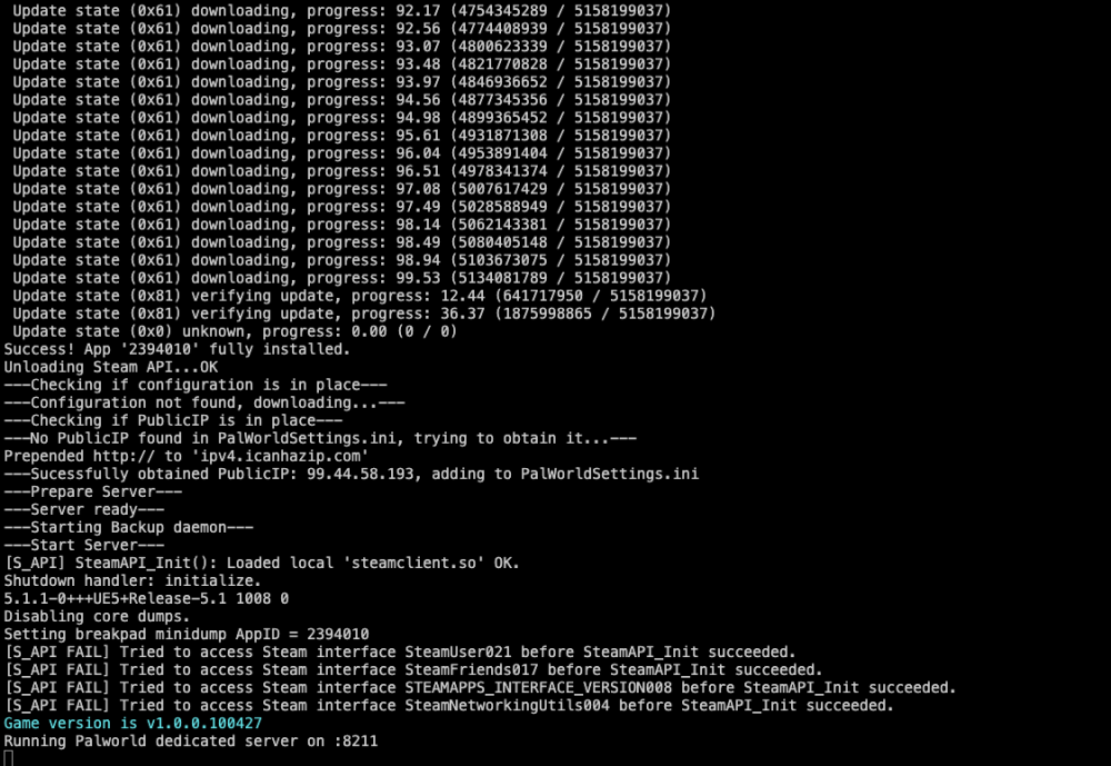

Error in Valhaim server log at startup?
[S_API FAIL] Tried to access Steam interface SteamNetworkingUtils003 before SteamAPI_Init succeeded.
Full log:
---Checking if UID: 99 matches user---
This is a warning and not an error, nothing to worry about or that prevents the Container from running.
Your log looks like a perfect fine start of the Container with ValheimPlus.

3 hours ago, xflo4444 said:
I guess i have to open the ports as you said.
Sorry wasn't clear enough in my previous answer.
You should be able to connect to the server via the Steam Server Browser with 'YOURINTERNALIPOFDELUGEVPN:2457' if you also created a port entry for the ports UDP 2456-2458 in your delugevpn template.

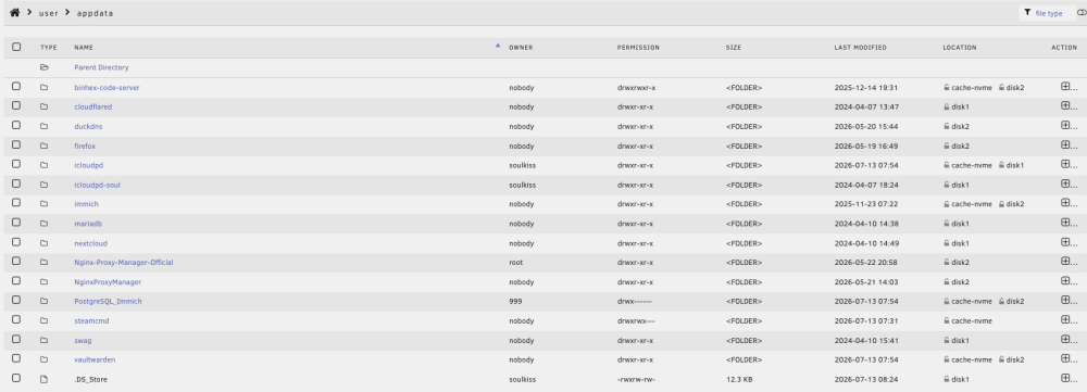

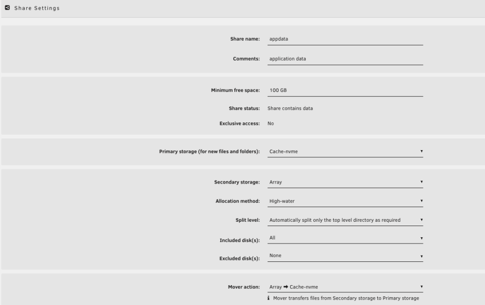

8 minutes ago, kristian221 said:
I'm getting this weird bug where my Valheim world is generating a "WorldName.db.new" file
Are you restarting the Container frequently?
We are losing our progress every couple days to this bug.
Have you enabled to move your appdata directory off of the cache to the Array?
It restarts every day, and I'm not sure honestly. My cache is pretty small, I haven't messed with it much. Where would I check that?
I don't recommend that because  the world destroyer bug is still out there as far as I know.
Are you restarting it with a script?
Go to your share settings and click on the appdata share and look what the setting 'Use Cache Drive' says.
It restarts due to CA auto-update, so I'll disable the auto-update on it for now. Also, it is set to "Preferred".
