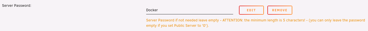

3 hours ago, Roma4593 said:
equivalent so that I can manually change server name, instance name and password etc besides going through the UNRAID docker GUI.
Are you running Valheim on Unraid?
To change the server name please look in the template you can change the name and the password in there (click on the icon on the Docker page and then Edit).

6 hours ago, ich777 said:
Please read this post:
I am running it in unraid. I was just wondering where the file was that the template modifies that includes the server name, password, ports, etc.
Thanks
2 hours ago, Durin said:
I got it confirmed on the Valheim Discord channel that the property "public" is not in use (servers are always public).
Nice, then please tell them to remove this from their installation instructions that ship with the dedicated servers... :D
But one thing that I've discovered is that when public is set to '1' and no password is entered the server won't start but if you set public to '0' you can actually leave the password empty and connect to it.
I will leave it in because it hurts no one by now... :D
Could you update the description of the fields in the Unraid docker container for Valheim?
This is already in there, eventually you got an old template:
