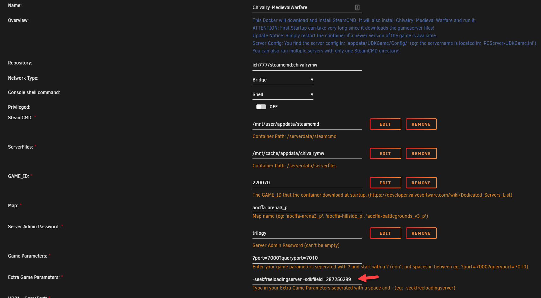

Hey, one issue I am running into on the Chivalry Server is when I add the -sdkfileid=xxxxxx to the gameparams the content is not being downloaded. It should be added to the chivalrymw>UDKGame>CookedSDK folder. If I manually add a folder from my desktop the content is there in game but it wont refresh or add it based on the game params.
The container isn't made for autodownloading community mods.
You have to do that from the command line and then you can add it.
