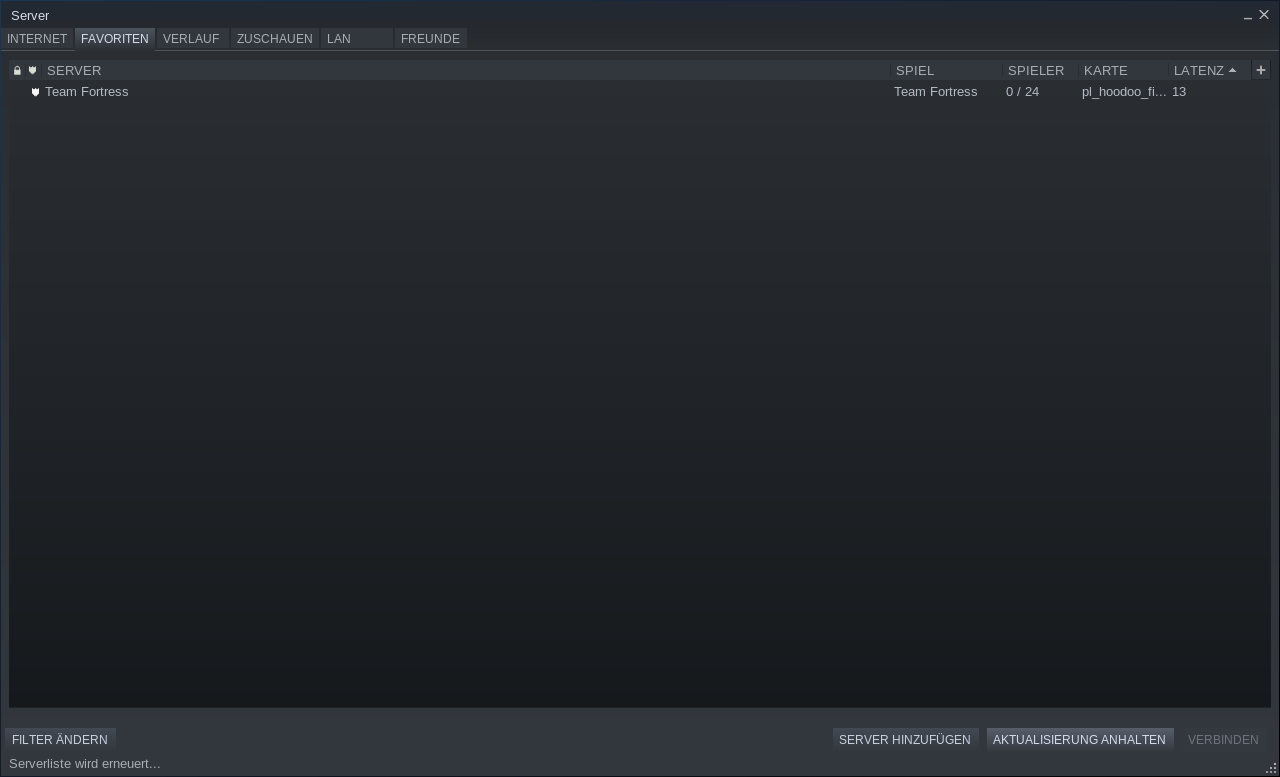

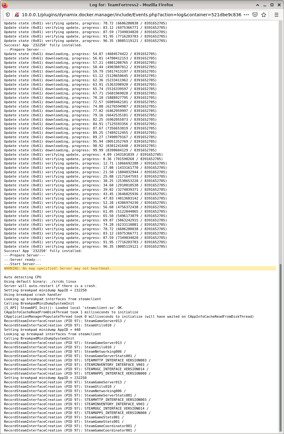

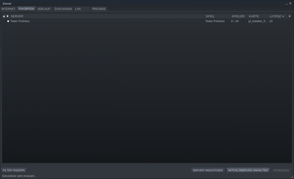

On 2/8/2021 at 4:37 PM, ich777 said:
I try this now on my own, can you please try to use a share that has no space in it, yours is named 'Game Server' can you try to make a folder named 'GameServers' and also make sure that the folder 'GameServers' is set to includ only disk2 in your 'Shares'?
EDIT: Server runs just fine and I see it in the Steam Server browser, attached a screenshot from the log and the Steam Server browser (please try to remove the '+map MAPNAME' from your GAME_PARAMS just for testing purposes):

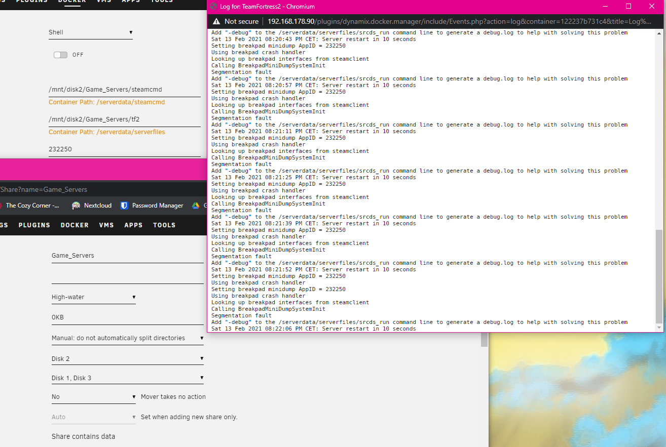

Its still doing it sorry for the late response😬

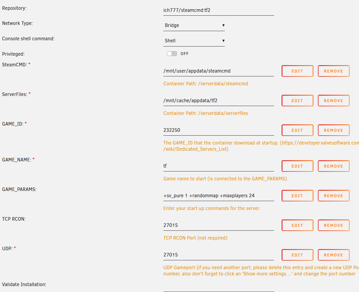

I would recommend to try to start over again and delete the folder that is created for TF2 and the container, tried it again and everything is working perfectly fine: tf2.log and I can connct to it and play on it.
I think in your case it can't access all the files.
Please try to start over and delete everything related to the TeamFortress container.

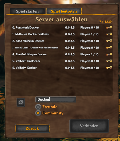

So this whole thing with dedicated servers in Valheim is kind of buggy in the community list in the game right now.
Yesterday, I set up the docker and everything worked fine. The docker showed up in the community list and my friend (X) an I were both able to connect.
Yesterday evening another friend (Y) wanted to join but wasn't able to seed the server in the community list. For me the server was still visible. So I tried to restart the docker. After the restart, even I couldn't see the server on the list anymore.
I tried to reinstall the docker, change the ports but wasn't able to get it to show up on the in game list since then.
Now here is the strange thing > my friend (X) who saw the docker at the beginning, can still see it in the list and connect from there :)
But I also don't trust this list .. the amount of servers always stands around 5000. I think the list is incomplete and runs in some kind of timeout while loading.
Another issue I could imagine is that the docker can't register properly as it is on some kind of blocked list since the first restart. As it is signed in anonymously I could only imagine that my IP gets blocked from listing again. I might try to change my public IP to verify this Idea.
I know about the workaround but wasn't able to check this with the public IP as friend (X) still connects trough the community list and friend (Y) hasn't tried since. I'm able to connect trough my local IP.
Please see one post above your's there are many more bugs, this game is in alpha state I think and the developers have a lot of work to do.
