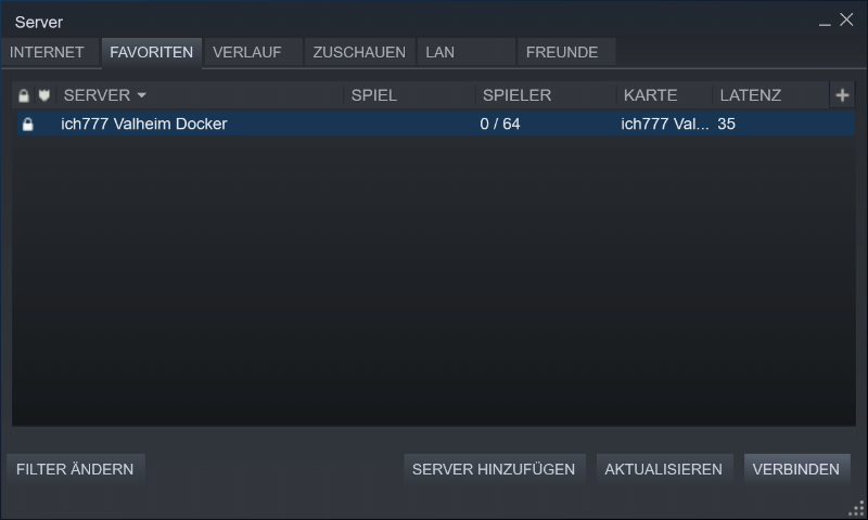

You should always be able to connect to the server from the Steam Server browser (second recommended post in this thread at the top) even if you are connecting from outside if the port forwarding is done correctly.

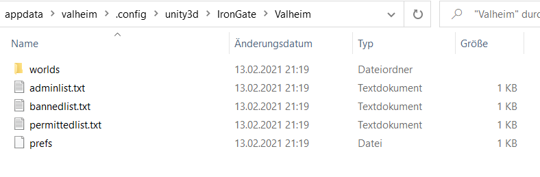

Running in to an issue with valheim - when I stop/restart the container, it renames the current {world}.db file to {world}.db.backup and then generates a new db file that is significantly smaller than the existing one. When the server does load with that db, the world is reset back to normal. Any idea what's causing this?

I am unable to see my valhiem server in the server list.
In the ingame server list or im the Steam Server Browser?
Please read the second recommended post in this thread at the top.
The server startup looks just fine. ;)
Are you running a world that you have imported?
Has the worldname changed?
Please also keep in mind that this server is in alpha and the developers know this bug, see the third recommended post in this thread at the top.

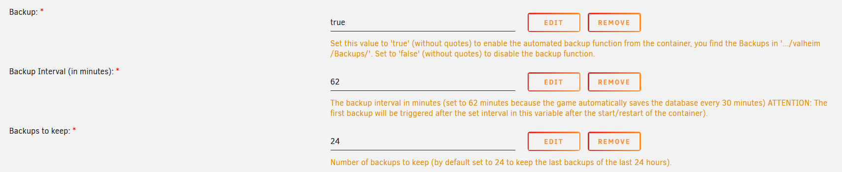

I now implemented a Backup function into the container itself to prevent or at least to somewhat solve the world corruption bug that is present in the gameserver itself.
It is set to create a backup after every 62 minutes after the start/restart of the container you will find the Backups in '.../valheim/Backups' and will keep by default the last 24 backups (this will keep you always a full day of Backups in case something goes wrong).
To enable this function you have to force an update of the container (ATTENTION: PLEASE KEEP IN MIND IF YOU FORCE AN UPDATE THE CONTAINER IS EVENTUALLY NOT STOPPED THE WAY IT SHOULD STOP, I WOULD RECOMMEND TO STOP IT IN THE FIRST PLACE AND THEN FORCE THE UPDATE ON THE DOCKER PAGE).
If you don't want to use this function I've update the template (but you have to pull it again from the CA App or add the variables manually, be default it is always enabled with as said above 62 minutes and keep the last 24 backups.
The variables are:
Key: BACKUP_FILES | Value: true
Key: BACKUP_INTERVAL | Value: 62
Key: BACKUP_TO_KEEP | Value: 24
Please keep in mind that Valheim is an early alpha game and such bugs are likely to happen most of the times...
