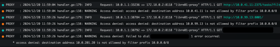

After updating to latest proxy-server I keep seeing this in logs,
WARNING Access denied: access denied: destination address 10.0.41.11 is not allowed by filter prefix 10.0.0.0/8
I can't seem to find where to allow specific networks/hosts.
Anyone with and idea?
Edited by makkish

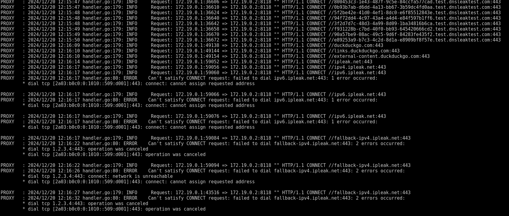

Can you please post a screenshot from that?
Do you use http/https or socks5 proxy?
Do you have users set up?
I am using http with user/pw as envs (HTTP_PROXY_USER/HTTP_PROXY_PWD)
This is really strange since nothing changed in terms of the http/https proxy.
I've now also tried it on my machine and all is working fine so far...
Are you sure you haven't set up any filter rules in your Firewall/Router?
I only know such denied messages from sites like https://ipleak.net/ but this is normal:
I look into that and report back.

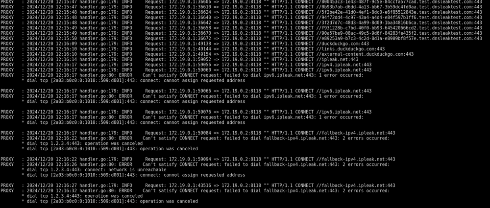

My use case for this is that uptime kuma connects to proxy server (installed as a container on Debian, not Unraid) through a VPN tunnel so the traffic is filtered through a firewall. The firewall rules are however the same, no change there.
I tried a restart and recreation of the continer, no difference. A couple of minutes ago I did a restore of the VM that runs proxy server and all started working again, this points to some change after the latest version, in my use case at least. I will dig some more and see if I can find something else.
Edited by makkish
Okay, then I'll revert the change that I just did.
Thanks for taking the time looking into it and let me know.

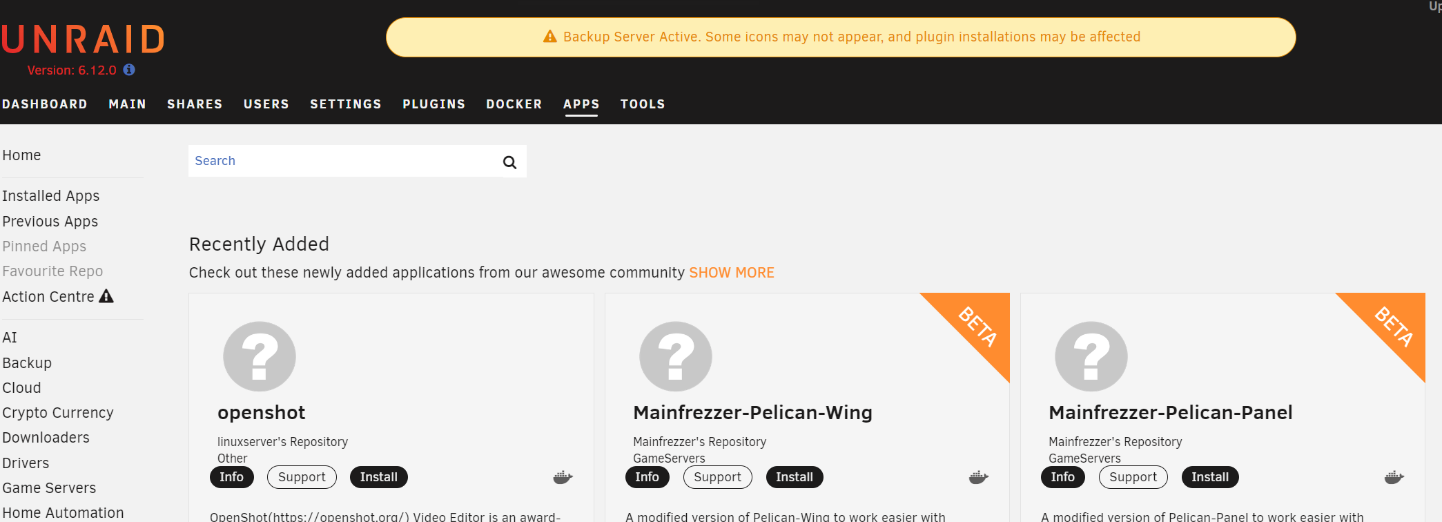

_20241225153639.thumb.png.dc0904d298f1d38b05a61b5067b9f349.pngRecently, I could not install any docker app include LuckyBackup in which 0 byte of the image files could be pulled.  On the top of apps' field, there always is an alarm says "
 Backup Server Active. Some icons may not appear, and plugin installations may be affected
I don't know what happened. Could anyone give me a help and thanks.
this is coming from CA Apps .. so wrong Thread here ;) goes into CA Apps plugin Thread.
Are you probably based in China? Do you use a proxy server?
This is mostly an issue with your Internet connection of some sort.
Yes. I undertand what the issue means. So I use proxy servers from China but it doesn't work. Do I have any other ways to it?
Are you sure that your proxy is working proplery since it doesn't seem like it is...
Make also sure the time from the server is correct.
Again, as @alturismo already said, it would be probably best to ask in the support thread from Community Applications.
THANKS.
