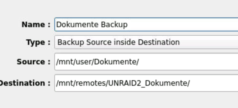

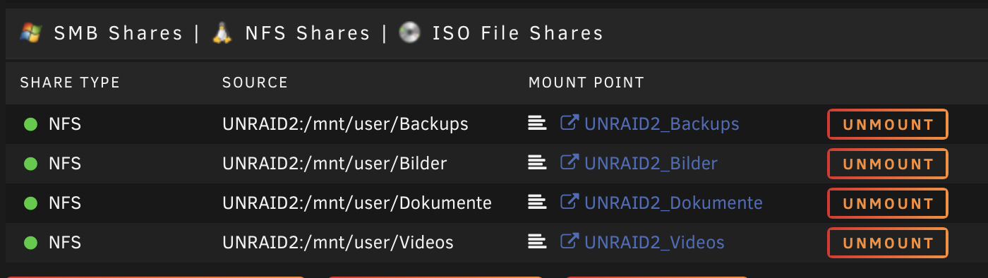

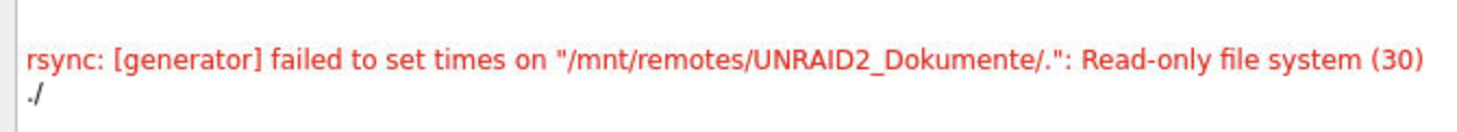

I have a second Unraid server on which I want to backup my pictures and documents etc. I have mounted the second Unraid server as individual nfs shares( pictures/docs/videos etc.) . Luckybackup tells me that the path is read only.
NFS shares are mounted under: mnt/remotes/UNRAID2_Bilder etc. Every share has read/write permissions for groups/owner/others.
It's actually not difficult but somehow I can't figure out where it sticks...
I'm not 100% if this is possibly a NFS issue, have you yet tried it with SMB if possible?
Can you please also try to enable Destination is FAT/NTFS? It seems that it has trouble to set the time on the files, I'm not sure if NFS does actually support that.
When I search for the shares it only finds nfs shares, so I haven't tried smb at all.
But then I can't mount the shares via UD?
You have to select Windows to see the SMB shares within UD and of course share on the second server.
Have you tried yet to enable FAT/NTFS as pointed out in my previous answer in the luckyBackup sync settings (enable Advanced).
lucky works fine with mounted smb Shares through UAD (i dont use NFS, so cant speak therefore)

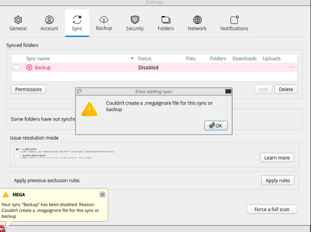

Hello, I installed megasync with the default settings on the template and I get this error. How to fix this? I tried to use UMASK 022 but still the same.
Also when I try to sync a folder, I get this error. Maybe this is related to the error above about permissions?
Edited by HHUBS
Please update the container itself, the error including message is now fixed.
