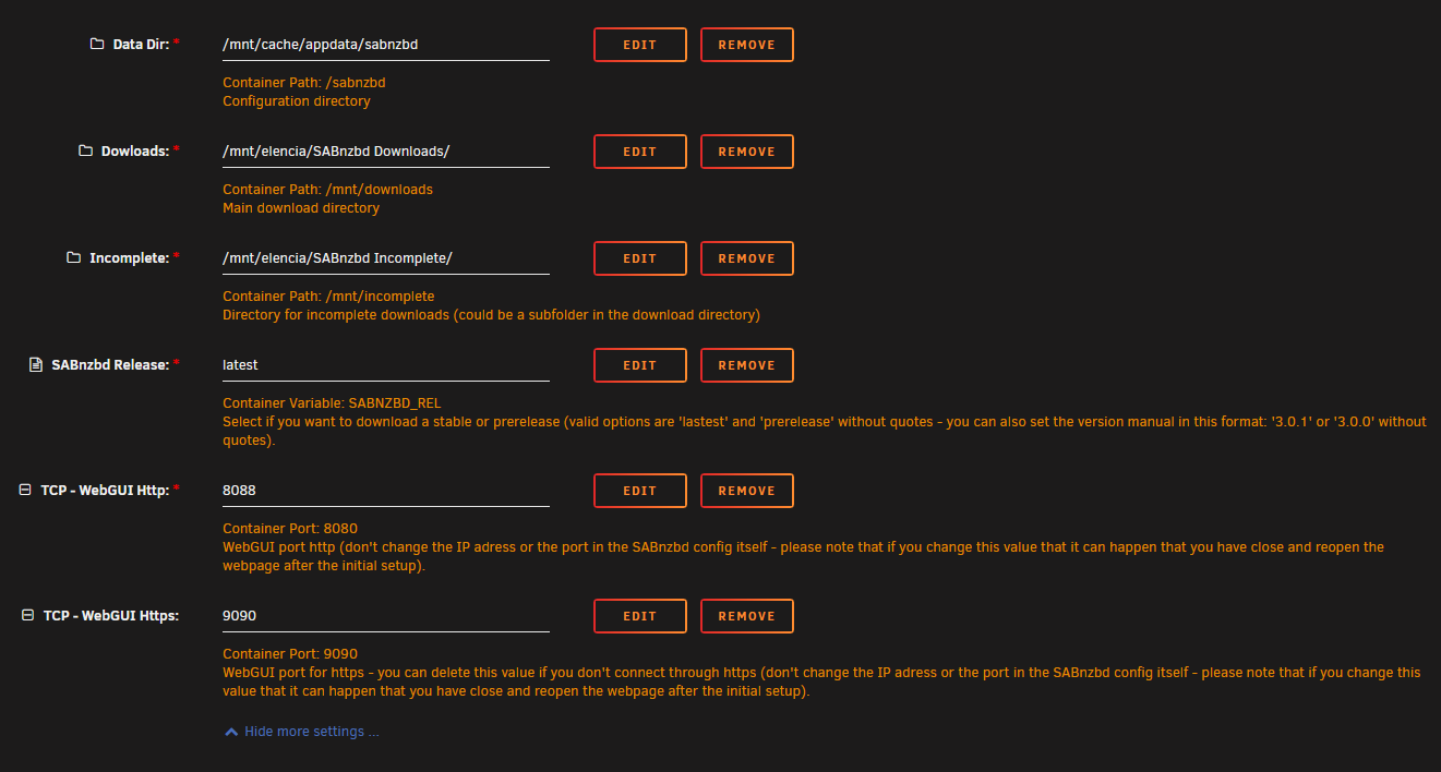

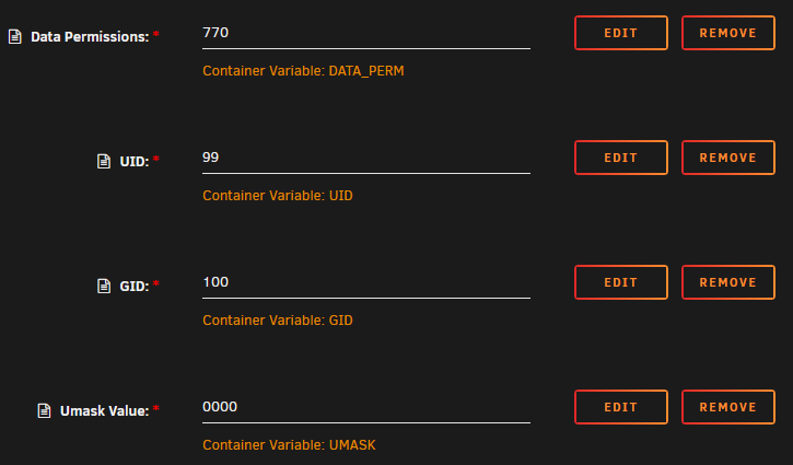

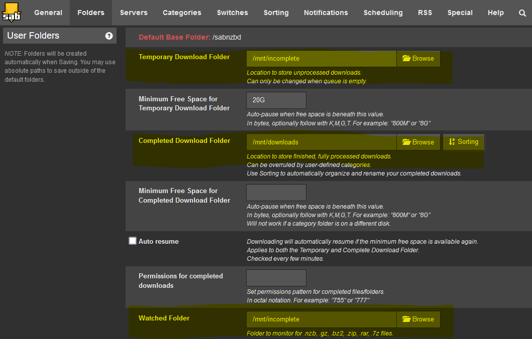

Hello folks,
I've been using SABnzbd for quite a while now. But since I have changed the monitored folders in “Docker > SABnzbd > Configure” to another pool in SABnzbd's own settings, it no longer monitors the desired folder. The downloads are processed, whenn adding the .nzb file manually in the webGUI, but I have not looked at where the downloads are temporarily stored (incomplete). Probably in the old pool “cache”
I tried for a while today with ChatGPT to find out the problem, but could not solve it. What I did notice is the fact that the container creates data as root:root. But it should be 99:100. Is that how it should be? I Dont tthink so.
Setup:
SABnzbd settings:
“Settings > Folder” I have set the temporary download folder to ‘/mnt/incomplete’.
The folder for completed downloads is set to “/mnt/downloads”.
The “Watched folder” to automatically load the .nzb files is set to “/mnt/incomplete”.
SABnzbd Docker settings:
Data Dir: /mnt/cache/appdata/sabnzbd
Dowloads: /mnt/elencia/SABnzbd Downloads/
Incomplete: /mnt/elencia/SABnzbd Incomplete/
SABnzbd Release: latest
TCP - WebGUI http: 8080
TCP - WebGUI https: 9090
Data Permissions: 770
UID: 99
GID: 100
Umask Value: 0000
I am very grateful for your help.
alent-diagnostics-20250117-2146.zip
Edited by AceBurn90
That always depends on how it was packed.
From what I see in your settings everything should work as it should, however what you can try to do (if you want to) is to change the host path so to speak:
to:
Incomplete: /mnt/elencia/SABnzbd Downloads/Incomplete
this would just save one folder and but is in my opinion better because you have everything in one spot.
What I would also recommend to do is not do use spaces in your share names because that can cause sometimes trouble.
to:
I have now put everything in the SABnzbd and the subdirectories as you recommended, because I like the idea of having fewer shares.
I now have a “Download” share and in it are e.g. the download folders of “jDownlaoder 2” and “SABnzbd” with subfolders for “# Incomplete ‘ and ’NZB Grabber” in the folder “# Incomplete”.
Now everything works. Thanks for the neat idea.

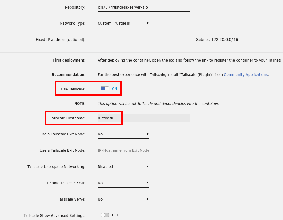

Would there be a way of adding Tailscale to the RustDeskServer-AiO image?
I would love to host the server/relay version within Tailscale to connect to other machines on the same Tailnet.
Are you using Unraid V7?
In addition to @trurl, if you are using Unraid 7.0.0 you can simply enable the Tailscale Docker Integration in the Docker template and follow the instructions:
