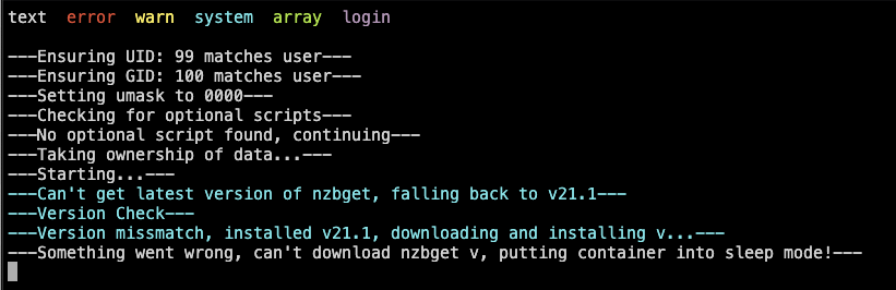

Will this also fix NZBGet which has broken for me this morning?
error output attached. Was working perfectly up until yesterday and I've not changed anything
Are you using my container? I deprecated it a long time ago since it‘s not actively maintained any more.
Are you sure that nothing is blocking access to GitHub or the GitHub API?
Getting the same error. Noticed it today.
Do you changed your network gear or do you have any Unifi network gear on your network?
Hi @ich777
Started having this issue (noticed it today). I do have Unifi gear on my network (but have for quite a while and no changes have been made).
nzbget is deprecated by the maintainer and therefore I deprecated the container too, please switch over to another nzbget container.
