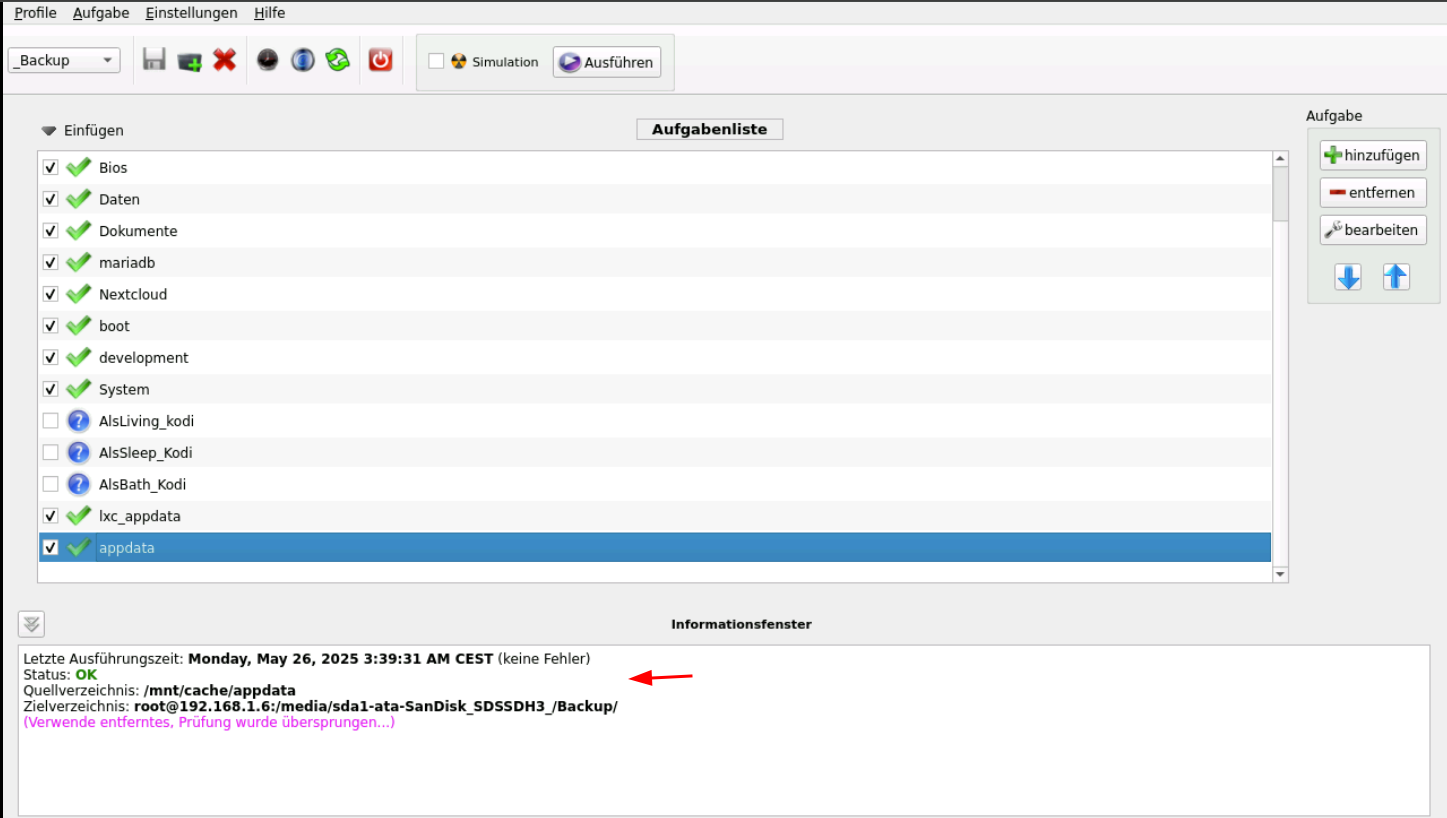

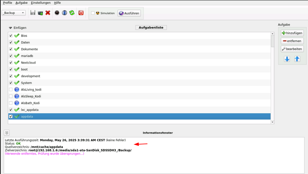

Hello, since several months I noticed that cron jobs not working. Therefore I did it by do it manually by pressing the run button but now I wanted to try to solve this issue. Anyone with the same issue or a helping hand?
I assume you are talking about luckyBackup correct?
Please provide more information on that, did you made sure to enable console mode when clicking Cron IT?
Hey @ich777, sorry I've not mentiond it but you identified it :)
There is nothing in the logs when I cron it. This is the only thing I see:
WebSocket server settings:
- Listen on :8080
- Web server. Web root: /usr/share/novnc
- No SSL/TLS support (no cert file)
- Backgrounding (daemon)
---Starting ssh daemon---
---Starting luckyBackup---
Edited by umitnice
This is just normal since luckyBackup is just a frontend for rsync and it was never designed for a Docker container, however the logs should fill when you restart the container after a cron job was executed, this is a known issue.
Another question, do you have CA Backup installed if yes, please keep in mind that by default the containers are stopped to create a backup and if that time overlaps with your backup schedule that might cause the issue.
I assume the container is running when you have set to execute the schedule correct?

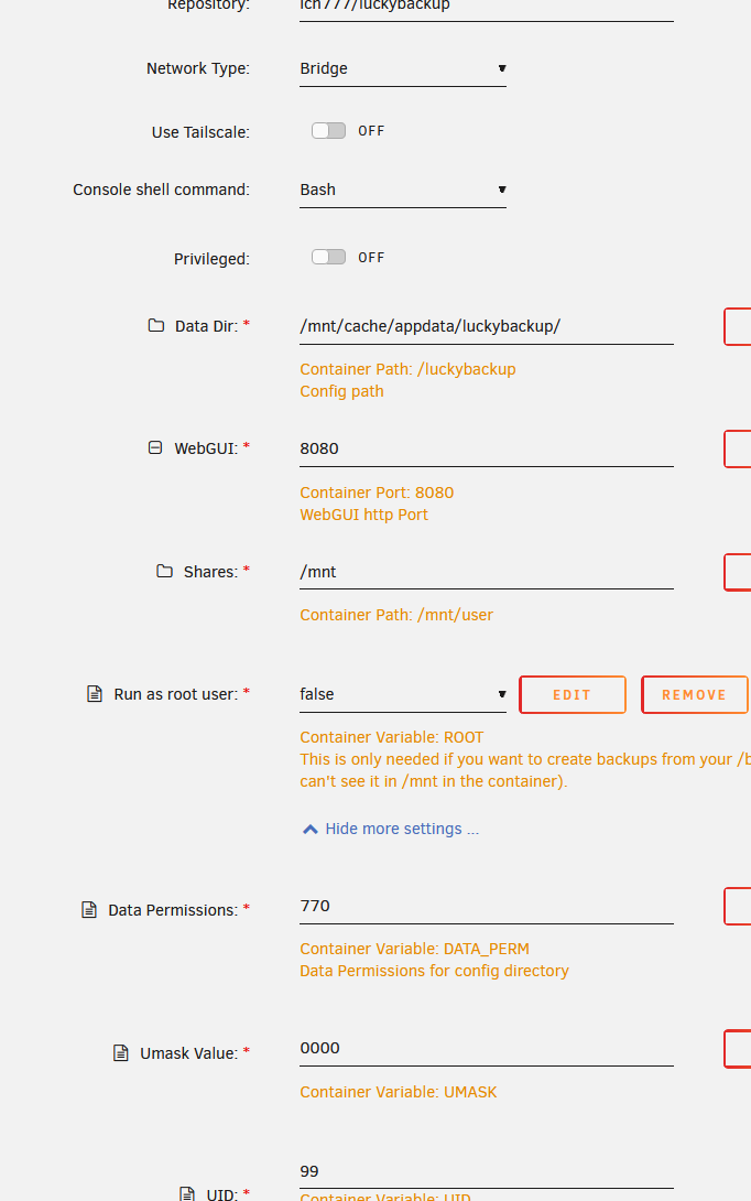

10 hours ago, ich777 said:
Do you have this option enabled or disabled:
Enabled; "True". The container setting for "Shares" is set to "/mnt"; the source, within LBU, is set to "/mnt/user"; destination is set to a pool via "/mnt/user/onsitebu/".
How did you do that? Is that probably related to the exclusion of the files?
However I would recommend that you just create a sync for each share with that you have more granular control what data you want to sync.
This are backups, not syncs (onsite and later an offsite component; 2 separate profiles; i am focusing on the onsite for sake of argument here.). I am only excluding the shares that i do not want (ie. appdata, docker, etc, and the wildcard of ".Recycle.Bin"; but even without that wildcard, things are not operating as it seems to be setup). I would rather have it set up this way, so that if I, or others, add a share down the road, i don't have to remember to add a new entry to the backup. It would be ideal to always back up everything, besides the shares i tell it not to. I have ensured there is plenty of space in the backup server(s) for this.
Hey, sorry for my late response. I've set a cron to 15:20 and waited but in the logs nothing changes because the job isn't starting:
Nothing to do, noVNC resizing set to default
Nothing to do, noVNC qaulity set to default
Nothing to do, noVNC compression set to default
---Starting cron---
---Taking ownership of data...---
---Starting...---
---Preparing Server---
---ssh_host_rsa_key keys found!---
---ssh_host_ecdsa_key found!---
---ssh_host_ed25519_key found!---
---Resolution check---
---Checking for old logfiles---
---Starting TurboVNC server---
---Starting Fluxbox---
---Starting noVNC server---
Container is running fine when the original cron job should run.
Sorry, I maybe wasn't clear enough. You wont see anything in the container log, after a cronjob is finished you have to restart the container and then you have to open the logs in the WebUI from luckyBackup and there you will see the log from the executed cron job but as said only after a restart from the container.
take a look here (after container restart)
Now I got it :)
this is the content of default-LastCronLog.log
No protocol specified
qt.qpa.xcb: could not connect to display :0
qt.qpa.plugin: Could not load the Qt platform plugin "xcb" in "" even though it was found.
This application failed to start because no Qt platform plugin could be initialized. Reinstalling the application may fix this problem.
Available platform plugins are: eglfs, linuxfb, minimal, minimalegl, offscreen, vnc, xcb.
Aborted
