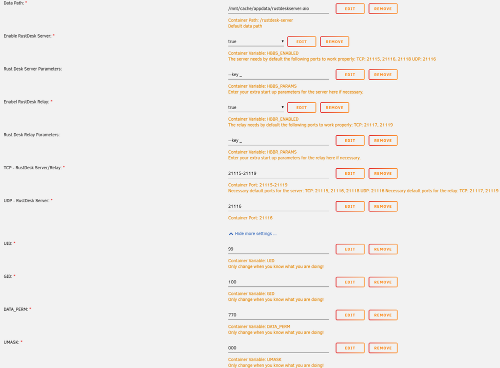

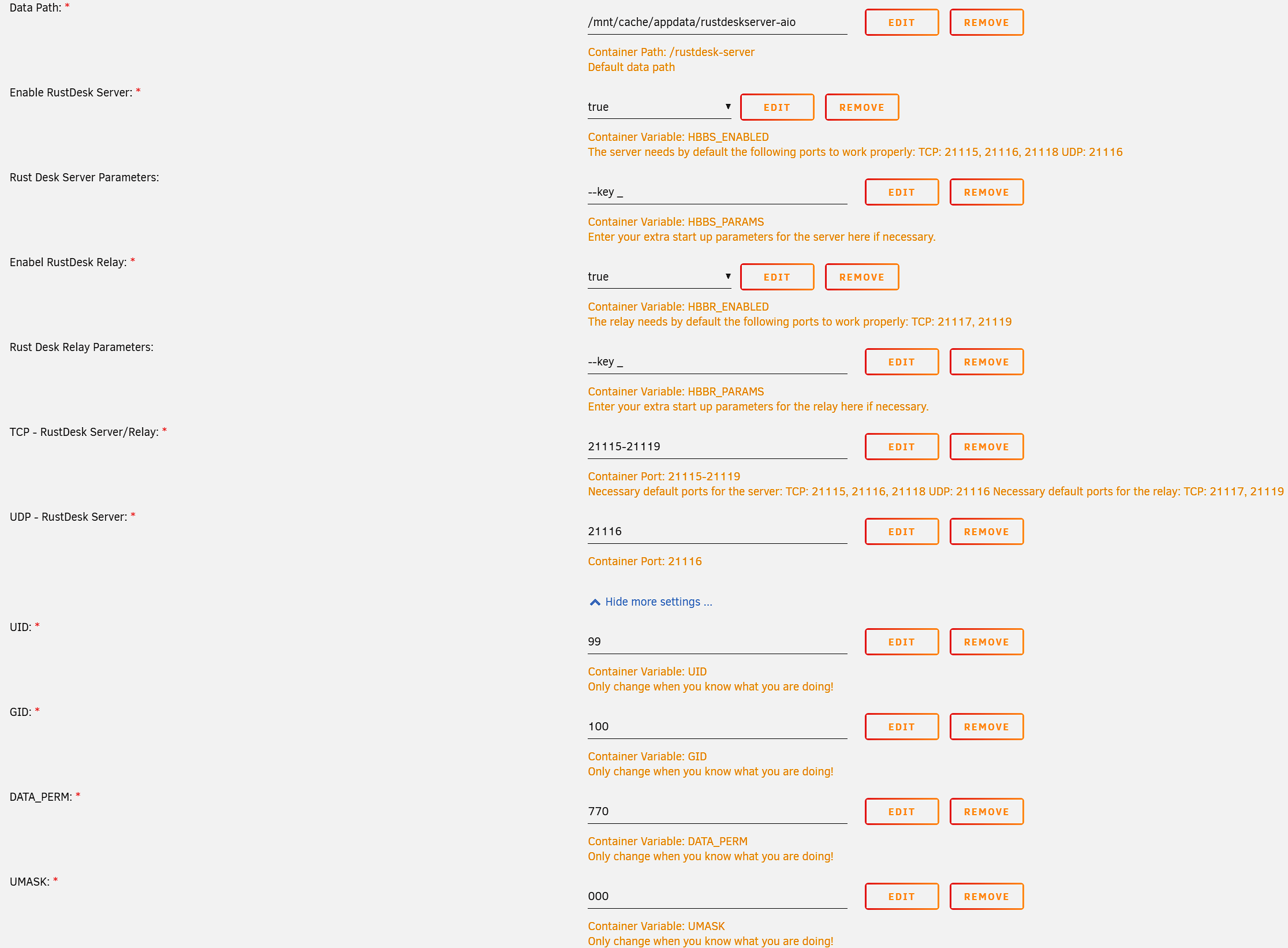

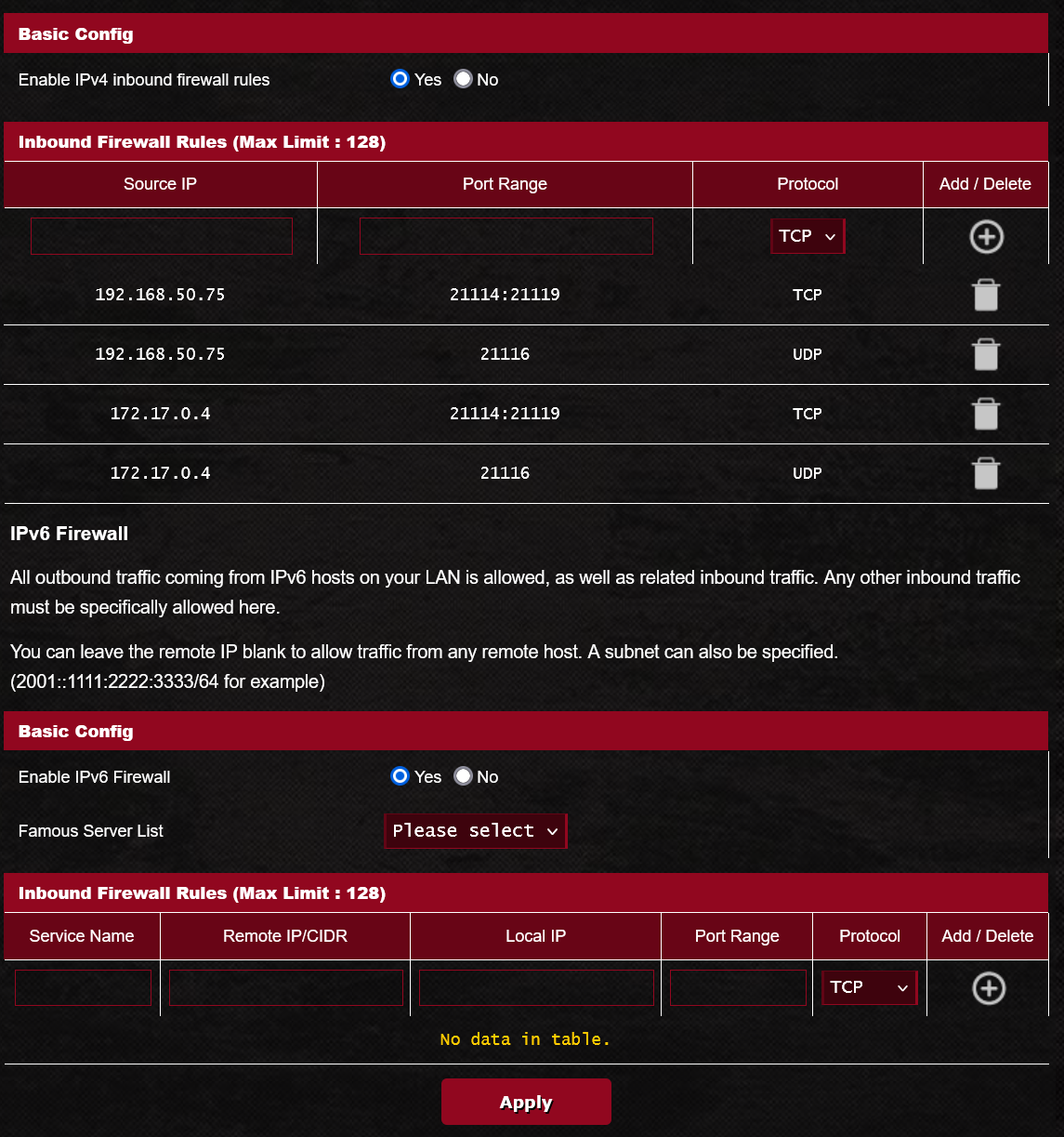

I can't get RustDesk to work with computers outside my local network.
I followed this guide: https://www.reddit.com/r/unRAID/comments/1e9syfu/setting_up_rustdesk_with_docker_image/
I am able to remote control computers on my local network, but I can't use an outside computer to control one of my local computers. I want to be able to use my laptop to control my main PC when I am away from home.
My Unraid docker settings:
My router firewall settings:
What am I doing wrong? What do I need to change?
Do you have other applications outside from your network running and working?
Please note that you need a public IP which is reachable from the outside world for this to work.
Remove the last two entries please, I assume these IP addresses are from your Docker network which is not reachable, these addresses are only used by Docker to route the traffic.
Is 192.168.50.75 your server? Then this is the correct IP to route through but the source should be WAN and the destination should be your server.

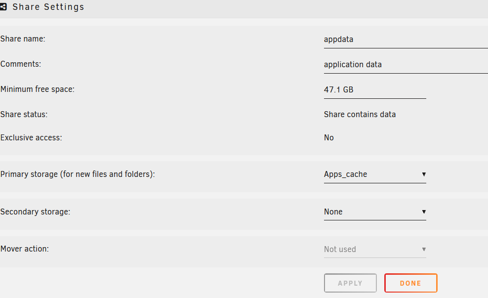

Hm. I don't think either one is the here, see shots below. Any other suggestions?

From what I see from the pictures, your pool is named apps_cache and you point the container in the template to /mnt/cache/appdata/... shouldn't it be /mnt/apps_cache/appdata/...

Found my mistake. /mnt/cache/appdata/... - > /mnt/user/appdata/...  Left over of very old setup. Thanks
