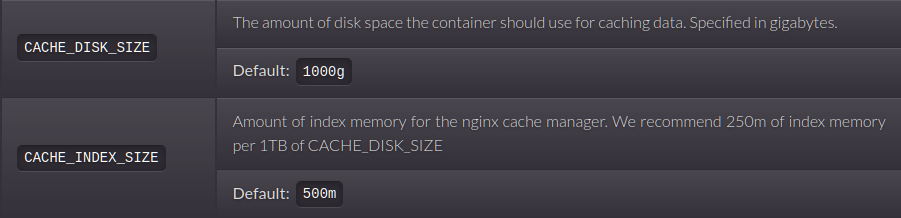

Hello, can you please advice how to remove lancache prefill limits, it stuck on 2.38tb no matter what I am doing. Ending up overwritting my data
29 minutes ago, ich777 said:
Please refer to the docs:
https://lancache.net/docs/containers/monolithic/variables/
Especially these two:
However, this is a LANCache issue not a prefill issue.
Thank you, I missed cache index size, will try that
