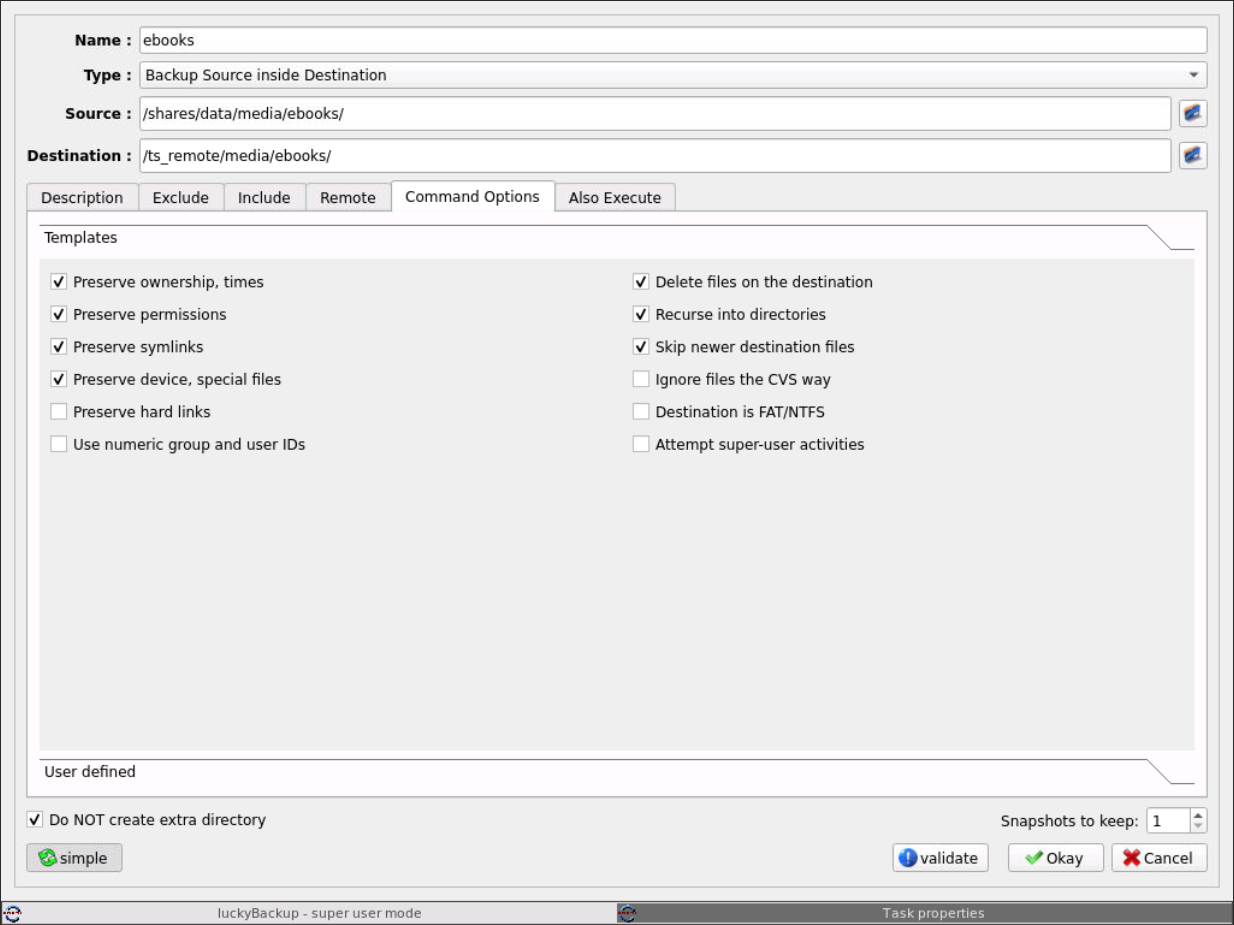

Howdy All,
I had backups of various media folders (tv, movies, audiobooks, etc) successfully backing up to another Unraid box at my office via SMB share over a Tailscale VPN. It was working great until 2 days ago when I accidentally deleted the backup profile rather than just one of the individual tasks that I was trying to remove.
So I painstakingly recreated all my backup tasks, but now when I try to run Luckybackup I get errors and can't figure out how to fix it. A dry run seems to work fine without any issues, but when I do an actual run of just one task (doesn't matter which), I get the following errors:
rsync: [receiver] write failed on "/ts_remote/media/ebooks/metadata.db": No space left on device (28) rsync error: error in file IO (code 11) at receiver.c(380) [receiver=3.2.7]
rsync: [sender] write error: Broken pipe (32)
My ebooks folder, which I used in this example, only has a total of 6.25GB of total used space. The receiving server has 29.8 TB free, and the cache drive that my backups share uses has 1.02TB free. So it's definitely nowhere near being out of space.
I verified that the tailscale connection was good and the drive is properly mounted on my main server in unassigned devices. I mounted the destination share via SMB over Tailscale on my laptop and I was able to write a test file to the folder using the same "backups" user that I have setup for this task. So it's definitely not a permissions issue. I'm at a loss for what it could be or how to fix it. Luckily I haven't lost any data and I have other backup methods in place for my critical data, but I would sleep much better if I could get this working again. Any advice would be greatly appreciated!
IO error as in your error message indicates no permissions to write or no free space however if space is not a concern it might be a permission issue.
It also says receiver so I assume you are sending the files with luckyBackup to another server correct?
Are you using luckyBackup with root or without?

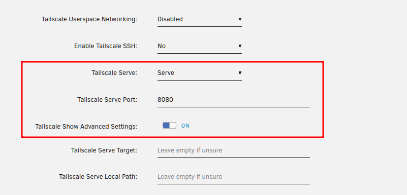

How did you add the container to Tailscale?
If you did it with the Unraid WebUI with the Tailscale toggle switch then it should just work right OOB without you needing to do anything.
To what URL/Port does Serve point?
Yes via the toggle.
Pretty sure i tried as default bridge networking AND Custom, but i did have to change the port mapping from 8080, to 8666 in the WebUI config parameter section - though this shouldn't be a breaking change Tailnet is created inside the NAT so it shouldn't matter,
Dont waste too much brain time on it - this is the first time ive tried the feature inside a container and something tells me there's additional config required to allow a docker IP to route to a public address (even though Tailnet is reserved range)
Hmm. So I didn't change anything from when it was working except recreating the tasks that I had in place before. The way I have things configured is my main server (UnRaidPlex) backs up via Luckybackup to an SMB share called /backups that is on my remote server (UnRaidBackups). The /backups share on UnRaidBackups has a user with read/write permissions to the share called backups. That is the user that is authenticating to the SMB share over Tailscale.
I didn't delete or recreate the container, and nothing was changed except the accidental deletion and manual recreation of the "default" profile within the GUI for Luckybackup. What started all this was I was trying to delete just one task that I no longer needed but accidentally clicked Delete at the top of the GUI instead of Remove Task on the right side. I recreated the tasks the exact same as before. The SMB mount was never changed, I've verified that the backups user can add/edit/delete files over SMB to the /backups share over Tailscale, etc. Attached is a screenshot of my container settings which are unchanged.
Edited by Sup3rTr00p
Added additional screenshot of one of my backup tasks
Okay, so this makes absolutely no sense. I haven't changed anything at all from yesterday when I started experiencing these errors, but right after posting my screenshots I decided to run the ebooks task again just for giggles, and now it's working...albeit very slowly.
I'll try working through each of the tasks one at a time and circle back if it starts throwing errors again.
That shouldn't matter.
Exactly, just leave as is, so to speak:
You just have to make sure that the second machine is also in the Tailnet and has Tailscale DNS enabled.
Please double check if you have https and MagicDNS enabled in your Tailscale Admin Dashboard otherwise it won't work.

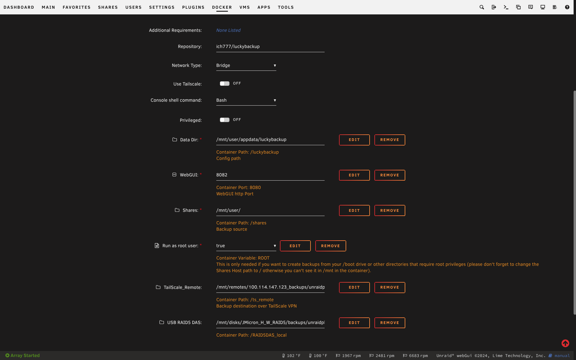

Yeah, SSH, SMB and all the protocols can get very slow even over Tailscale since latency here is crucial for those protocols.
Please also take into consideration if you have chosen to use /mnt/user/... on the backup machine that you might run into some kind of limitation on the FUSE filesystem that you can set in the Share settings (min. available disk space, or even some setting with the Cache).
I'm not sure what you mean. The shares container path for /mnt/usr on the originating server as that is where I'm wanting to backup from. I'm creating tasks that all start in /mnt/usr so as to make navigating to each origin share easier.
So for example:
To backup my audiobooks which are located in /mnt/usr/data/media/audiobooks I have my task setup for /shares/data/media/audiobooks backup to  /ts_remote/media/audiobooks.
I mapped /shares to /mnt/usr because I also backup other shares like /appdata-backup, /nextcloud-backup, /isos, etc.
Should I have created multiple folder mappings in Docker for each separate share on the host server rather than generically as /mnt/usr? I can do that but it seems like a lot of extra work. I am not knowledgeable about FUSE or the implications you're referencing. On my destination server, I have an NVME cache pool that is 1TB and the /backups share is set to write to it with 100GB minimum space. I have mover set to run daily, so as long as I don't have more than 900GB to backup in a single day I shouldn't run into any issues I would think.
I meant on the server that you are sending files to since you got a IO receive error with no free space.
Usually there are a lot of variables involved, both on the sending and on the receiving system and it‘s always hard to tell for me what went wrong.

Thanks in advance for any tip!
3 minutes ago, CamilloCox said:
I also have a suspicion that it might have something to do with the Unraid upgrade to 7.x.x that I did a few weeks ago o.O
I don't think so.
4 minutes ago, CamilloCox said:
P.S. Before that, LuckyBackup ran very reliably and I was very happy.
Does the sync work when you run it manually?
