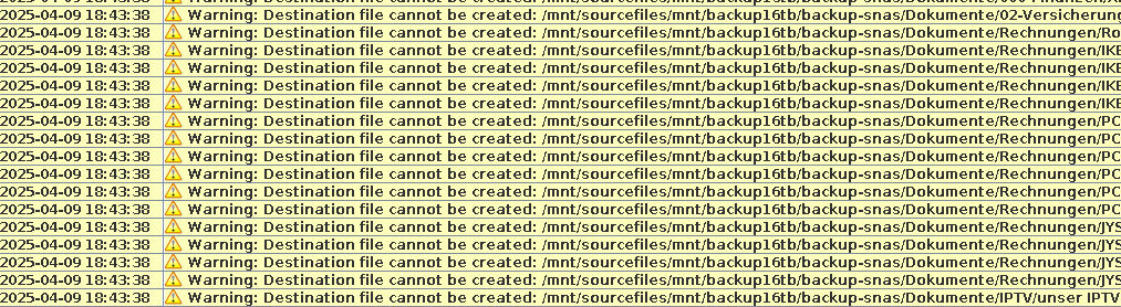

Hello Ich777, i got problems with the DirSyncPro Docker.
It worked finde, now i realized by checking the backups, that i wont work anymore since 2 month.
it says:

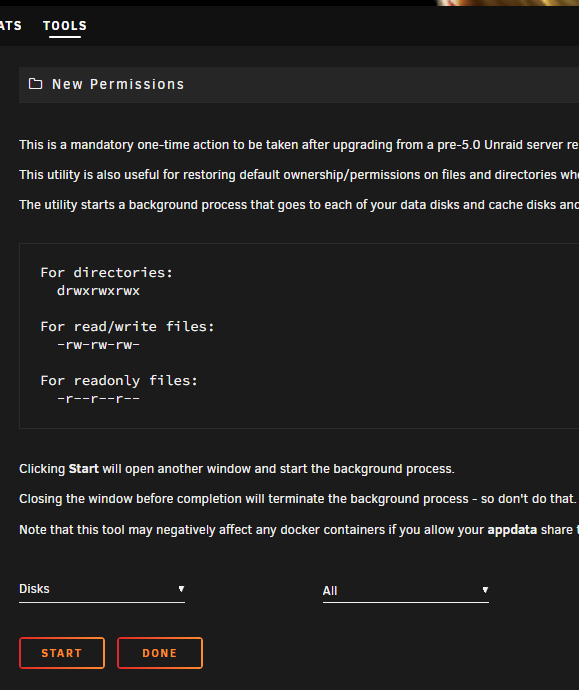

i have already tried to give new permissions over the tools Section via Unraid.. but it didn't helped.. maybe you know what i am doing wrong.. thx for the help
Just a stupid question, disk space is not a concern?
I'm not 100% sure what could cause this.

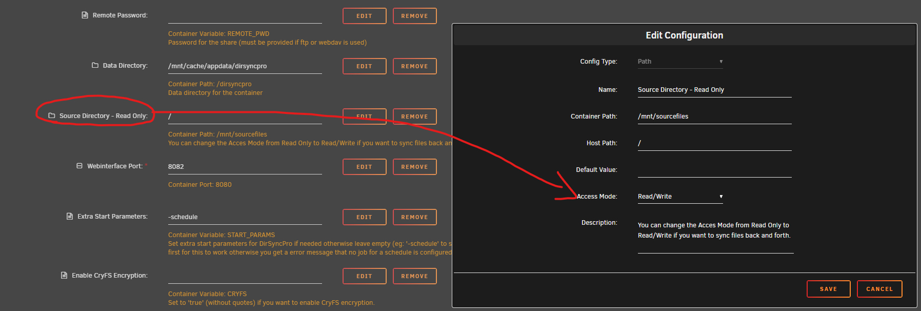

Disk Space is not a concern, i got "plenty" .. oh okey.. if u cant imagine whats wrong.. i am not able to find it by myself i guess :)
but thx anyway trying to help me out
EDIT.. okey sometimes i am lucky and try things out.. and find a solution i gues..
Don't know why... never touched this setting almost 2 years and it worked fine.. but now i have to change.. like you Commented in the Docker to Read/Write.. now it workes
but i am only reading from source file, dont know why i have to change it.. its just a "stupid-- Copy from A to B" rule.. nothing spacial.. no bi directional sync.
but never the less.. it workes again for me
