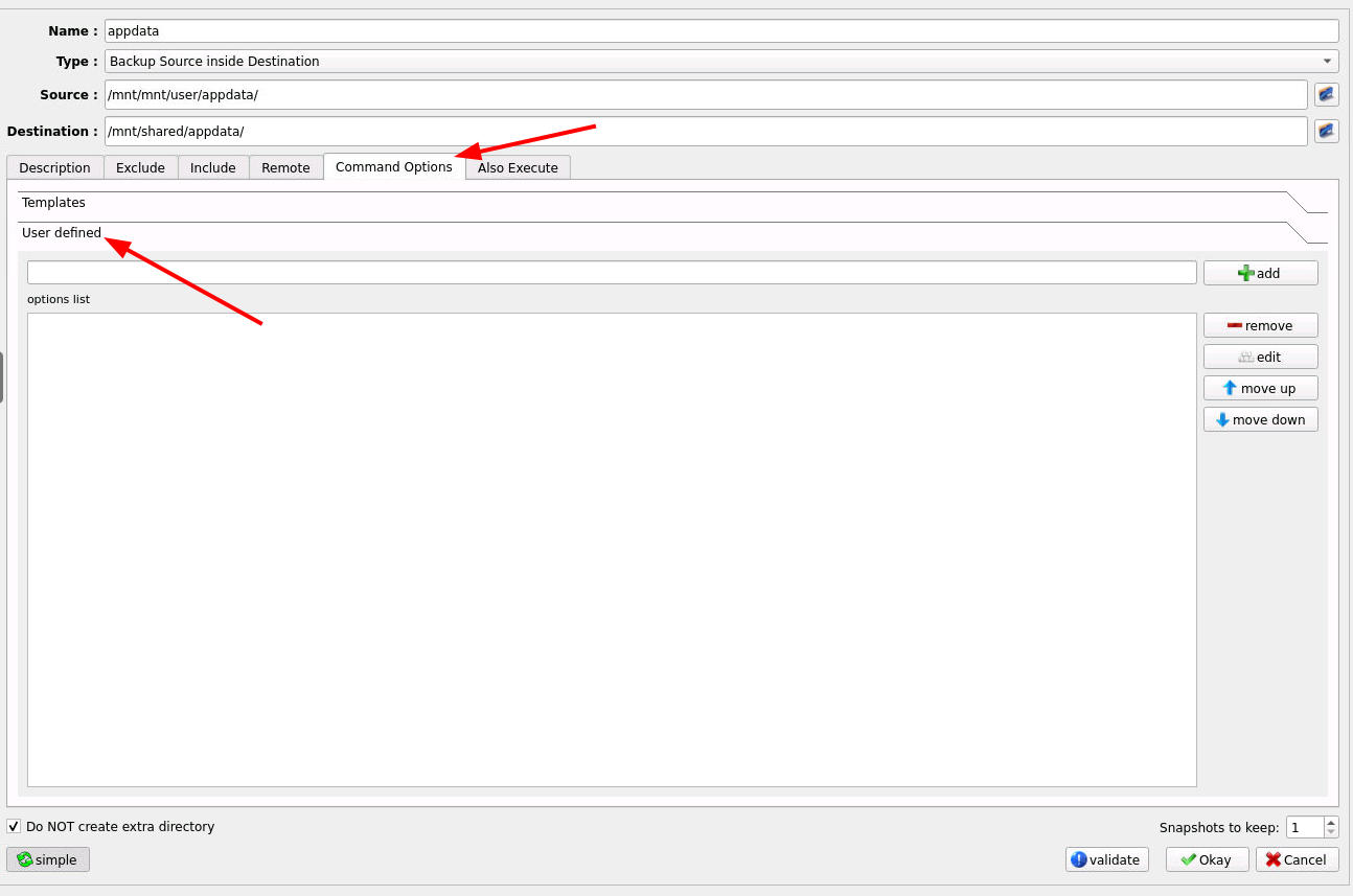

HI @ich777 is there a way to change the SSH encryption to speed up LuckyBackup? I can copy with SMB up to 600MB/s but LB does not go faster than 190MB/s.
Thanks.
That is up to you since luckyBackup is just a GUI for rsync and you can always add command line options here:

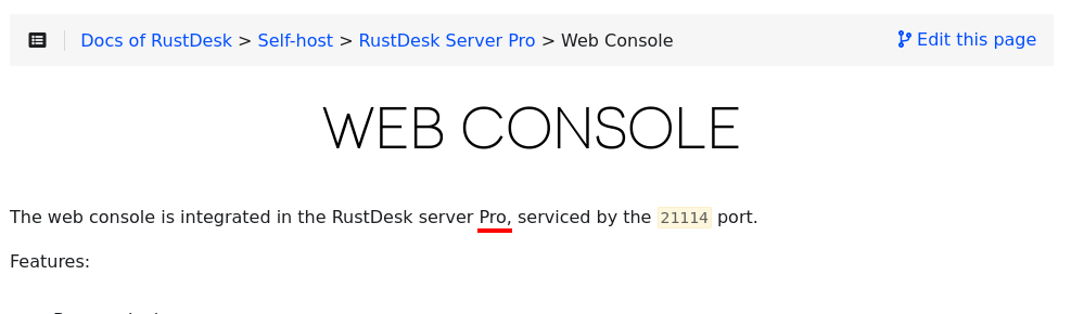

1 minute ago, Evilbuns said:
Any reason port 21114 for the web console is not mapped in setup? Is it possible to use the web console with this docker?
The web console is only available in the Pro version which the linked documentation also says:
This container is based on the free version and doesn't support the Pro version.
