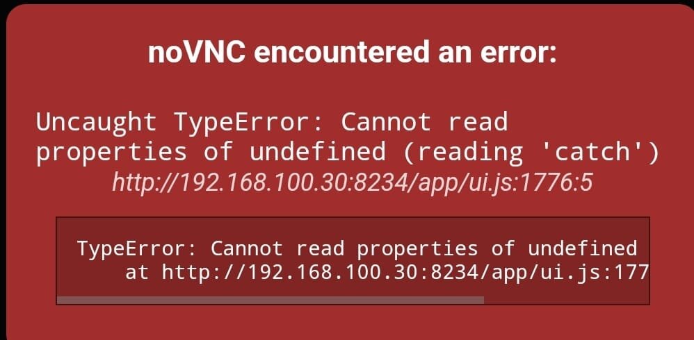

Since the last update of LB, I cannot open it on my phone anymore. It does work on the computer. Running Unraid 7 RC2
On my phone I get the error:
PC and phone is both Google Chrome
clear cache'S from your Browser (on the phone) ... theres been a major VNC update ...
This is not since RC2, this is since the update from the container a while back, please read this post:
