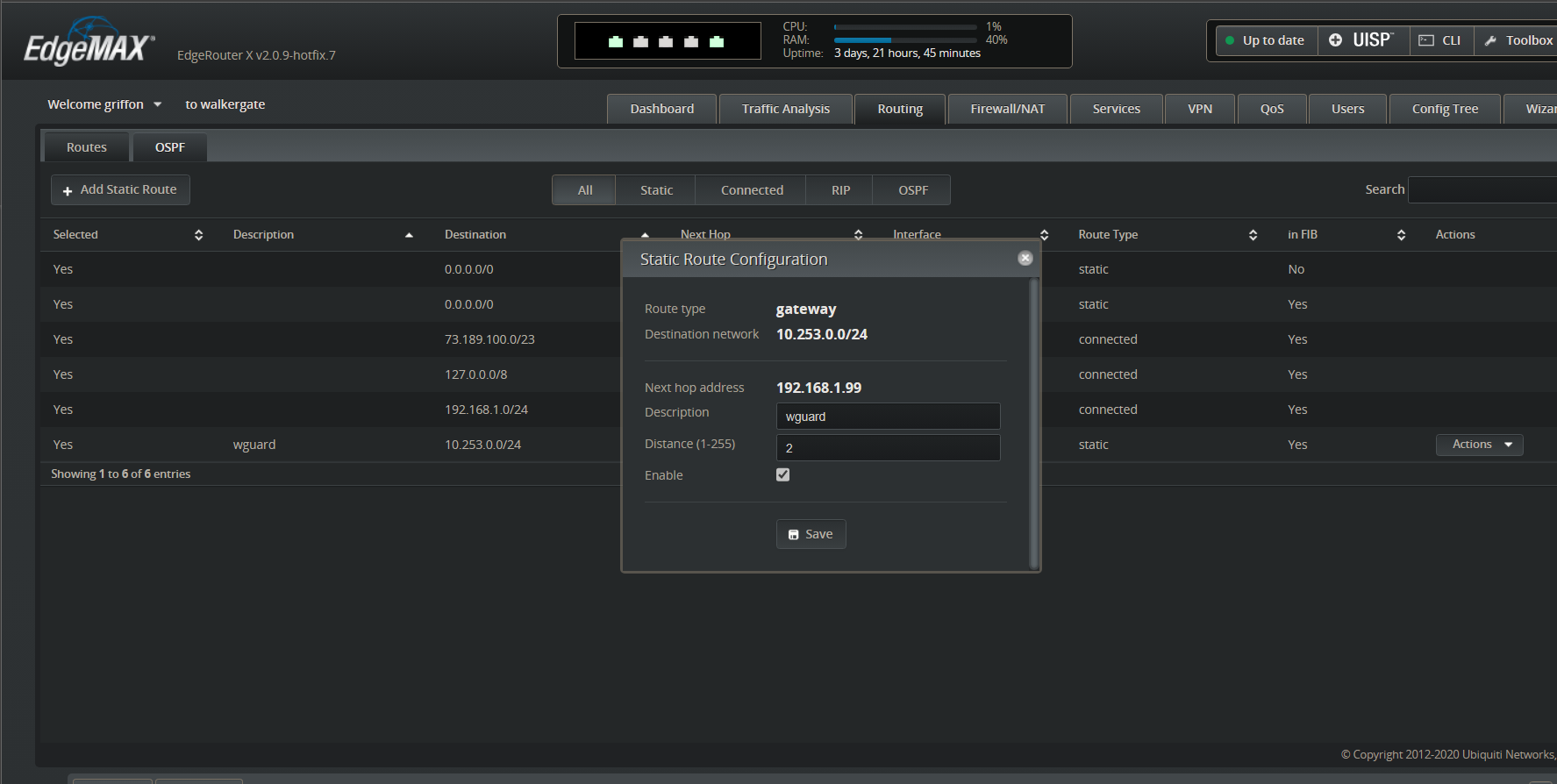

image.thumb.png.af980d0d3976e09e033e2920d264c62f.pngsame issue with docker access. screen shot of my router with the static route for wireguard.
root@nas-mass:~# ip route
default via 192.168.1.1 dev br0
10.253.0.2 dev wg0 scope link
172.17.0.0/16 dev docker0 proto kernel scope link src 172.17.0.1
172.31.200.0/24 dev br-6340e4198bc5 proto kernel scope link src 172.31.200.1 linkdown
192.168.1.0/24 dev br0 proto kernel scope link src 192.168.1.99 metric 1
192.168.122.0/24 dev virbr0 proto kernel scope link src 192.168.122.1 linkdown
Not sure what I'm missing. nat disabled in wg config. I tried adding the static route a could other way too with no luck.
Docker network is all the 192.168.1.x same as the gateway and other devices getting DHCP from the gateway.
Also see the route in the wireguard config.
Address=10.253.0.1 ListenPort=51821 PostUp=logger -t wireguard 'Tunnel WireGuard-wg0 started';/usr/local/emhttp/webGui/scripts/update_services PostDown=logger -t wireguard 'Tunnel WireGuard-wg0 stopped';/usr/local/emhttp/webGui/scripts/update_services PostUp=ip -4 route flush table 200 PostUp=ip -4 route add default via 10.253.0.1 dev wg0 table 200 PostUp=ip -4
route add 192.168.1.0/24 via 192.168.1.1 dev br0 table 200 PostDown=ip -4 route flush table 200 PostDown=ip -4 route add unreachable default table 200 PostDown=ip -4 route add 192.168.1.0/24 via 192.168.1.1 dev br0 table 200
So the answer is this is all correct BUT
In docker config you need to enable "host access to custom networks". Settings, docker, set enable to no to bring down hosts, turn off advanced config.
Which is documented here, off the beaten path of the main config. There are MANY reedit and other posts asking this quest.
Edited by Bushibot
