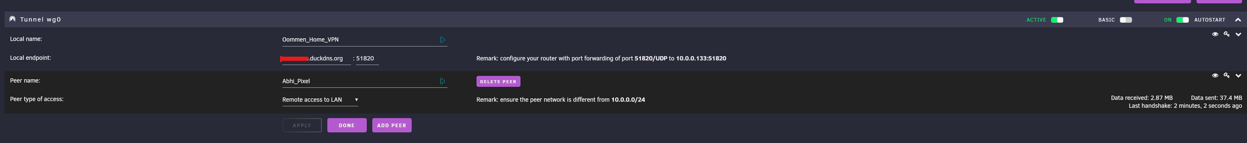

Hello - installed this plugin and it is working fine - Thanks for the work.
I am not super knowledgeable regarding networking - but I am using the remote access to LAN as shown below, followed the steps laid out in the very detailed write up, and I can connect to Unraid and docker containers (e.g. Plex, Emby etc.) well from outside my home network, so ports are forwarded correctly and everything seems to be working well. However I cannot access anything else connected to my LAN (e.g. Pi-Hole running on an R-Pi) or my router admin page.
I was using openVPN before this and could access all devices on the network easily. Any advice for me to try and get to everything connected to the LAN? Thanks in advance.
Edited by abhi.ko
added more info.
