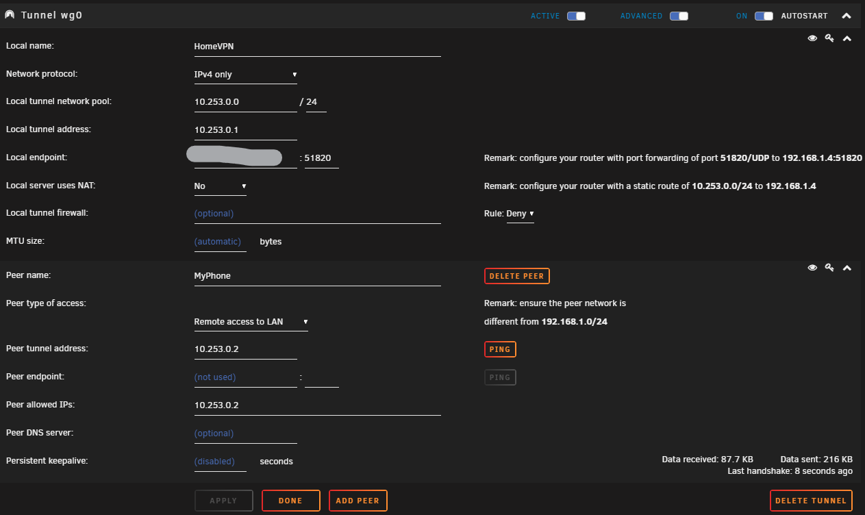

OK so i've done exactly this. I have a LAN connection via WG and can access everything normally, except for VLANS and custom dockers.
eg I have a Shinobi docker running on VLAN5 (192.168.5.2) with all CCTV cams as well which timeout on WG. Additionally, DelugeVPN and Jackett (routed through DelugeVPN) are not accessible either.
All of the above are accessible normally via this PC (192.168.1.5).
Would there be any other specific routing required?

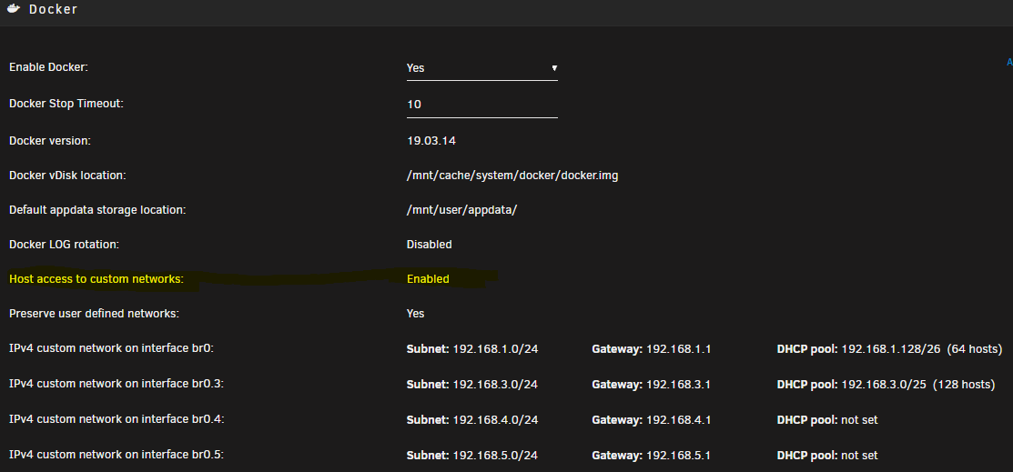

Couple of things I forgot to mention:
  1. WG configuration -> Local server uses NAT = No
  2. Docker configuration -> Host access to custom networks = Enabled

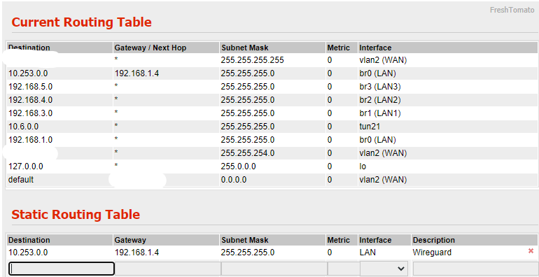

  3. The router needs a static route to forward the WG subnet (10.253.0.0/24) to the Unraid server (192.168.1.x)
I had these settings sorted already, including the static route. I've added the simplified AllowedIPs subnet on the client with no effect. Below is the static route set. Does anything glaring obvious stand out that i've done incorrectly? Unraid IP is 192.168.1.4.
On 4/3/2021 at 3:31 PM, Boo-urns said:
Unraid settings as follows:
Thanks again for your help.
I don't know how your router interprets a metric value of zero, but from a routing perspective this should be at least 1.

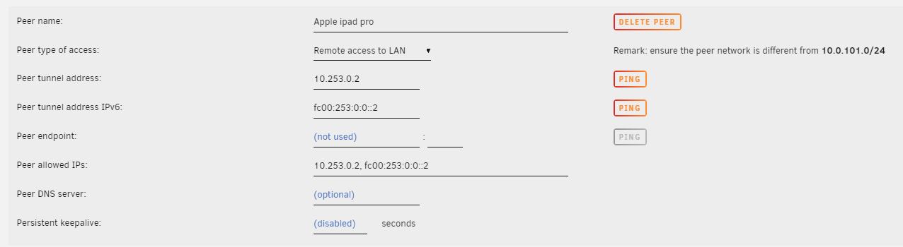

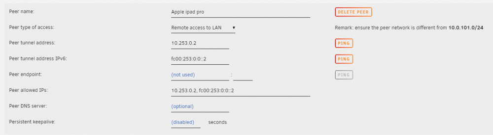

I'm trying to setup a remote tunneled access server using IPv4 + IPv6 and a local DNS (pihole) server. I run through the advanced configuration and my clients are successfully tunneling through IPv4, but it seems there is no IPv6 access through the tunnel. Is this a bug or am I misconfiguring something?
My config is almost all default settings:
Edited by bearattack
I struggled getting this working, all of the settings looked good and I tried various fixes but just couldn't get that initial handshake.  It ended up being super easy (of course).  In my Port Forwarding rule I had it set to use TCP instead of UDP.  I switched it to UDP and that fixed it.  Of course the instructions to use UDP is right there on the config page but I just didn't pay enough attention.  But maybe someone else will struggle and come here and this will help them.
The WG configuration looks okay, for IPv6 to work everything in your network environment needs to understand IPv6 and set up properly. Start your investigation there, and no it is not a bug. IPv6 with WireGuard does work.

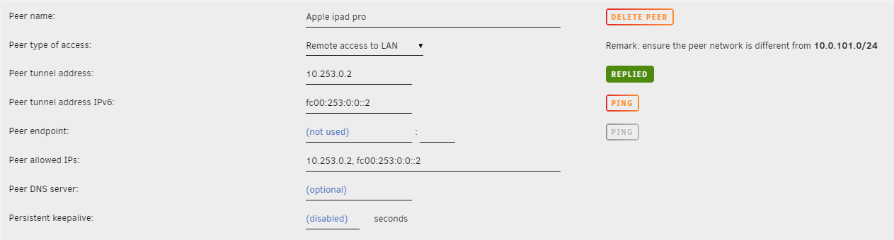

Switch to advanced mode and use the PING button to test reachability to the peer
(in my example I have both IPv4 and IPv6, but same principle with IPv4 only)
