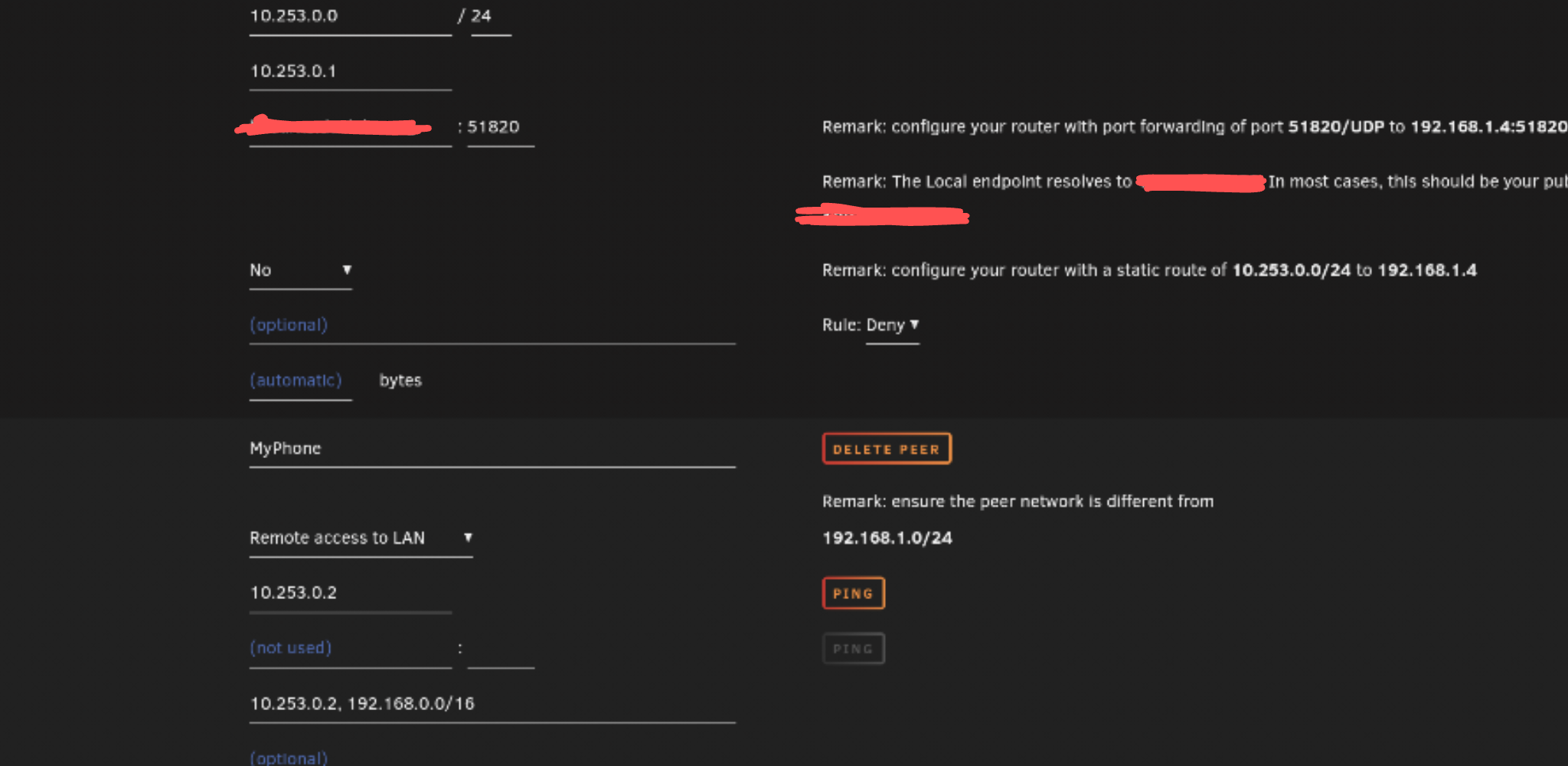

4 hours ago, ljm42 said:
Everyone's setup is different. Go to the VPN Settings page, enter advanced mode, and show a screenshot of the static route it tells you to setup.
Attached. Seems right, but isn't working. So I need to set up firewall rules also?
Yeah, I'd say that looks right.

Also, why are you ignoring the warning that the local endpoint you entered doesn't resolve to the correct IP?
It resolves to the correct IP. I just have it set to my DDNS address, which resolves to my public IP.
I have the static route set, host access enabled and Use NAT=No, however cannot access custom networks. These being other VLANs, DelugeVPN docker (which is set to bridge network), my CCTV VLAN. All of these I can access when connected to my LAN normally.
Are you saying the warning is incorrect? It says that your DDNS does not resolve to your public IP.
Would you mind PMing me the uncensored screenshot and helping me understand what is wrong about the warning? Is there something we need to change? Or do you have a complex setup with multiple public IPs?
cannot access ..  DelugeVPN docker (which is set to bridge network)
If you are able to access the webgui then you should be able to access another port on the webgui's host.
Are you accessing it by IP address or by hostname?  http://ipaddress:dockerport should work, or whatever hostname you use for the webgui followed by ":dockerport".
In general a hostname like "tower" will not work through the tunnel, see the "About DNS" section of the first post here: https://forums.unraid.net/topic/84226-wireguard-quickstart/
cannot access custom networks. These being other VLANs, ..., my CCTV VLAN. All of these I can access when connected to my LAN normally.
On the VPN Settings page, click the little "eye" icon next to the peer you are working on. It will bring up a window that says "Remote peer configuration" (if it says "Local server configuration" then you are looking at the wrong one)
It has an entry for "AllowedIPs" that lists all of the networks the client is allowed to access. If you are running the latest version of the plugin it should automatically add the networks that Unraid knows about to this field. Are the networks you are trying to access listed here?
If not, you will need to add them after you have downloaded the file to the client.
(note: some versions of the plugin had issues with this, so as an extra step make sure you have version 2021.04.12 of the plugin, then make a small change to the client and hit save to regenerate the client file. And of course, you need to install the updated client file on the client whenever you make changes)
