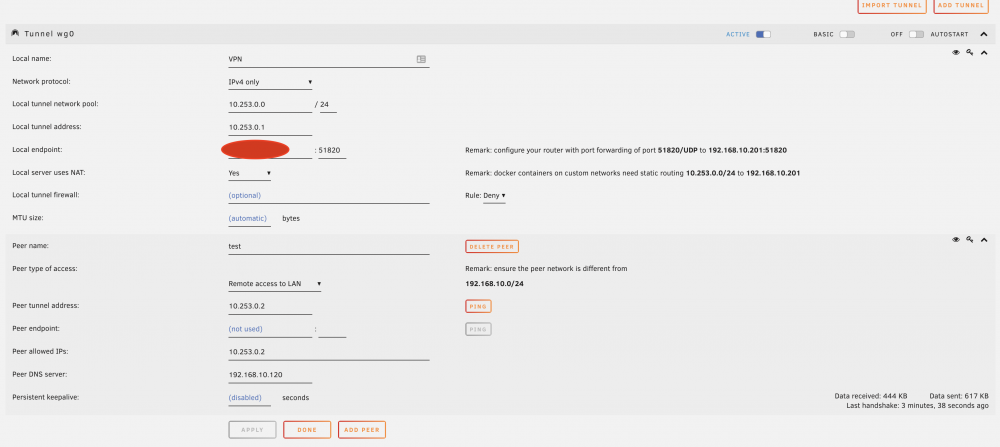

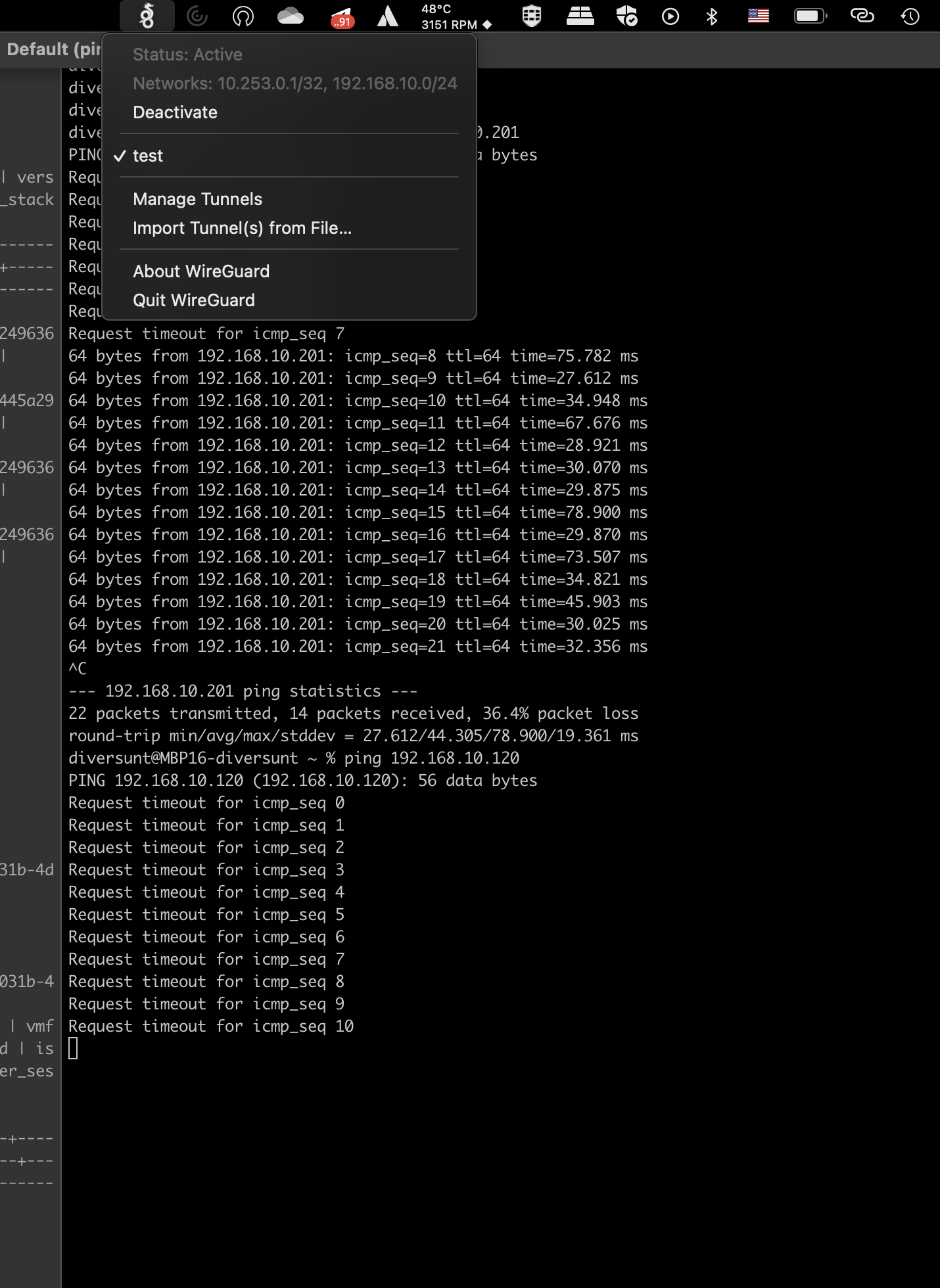

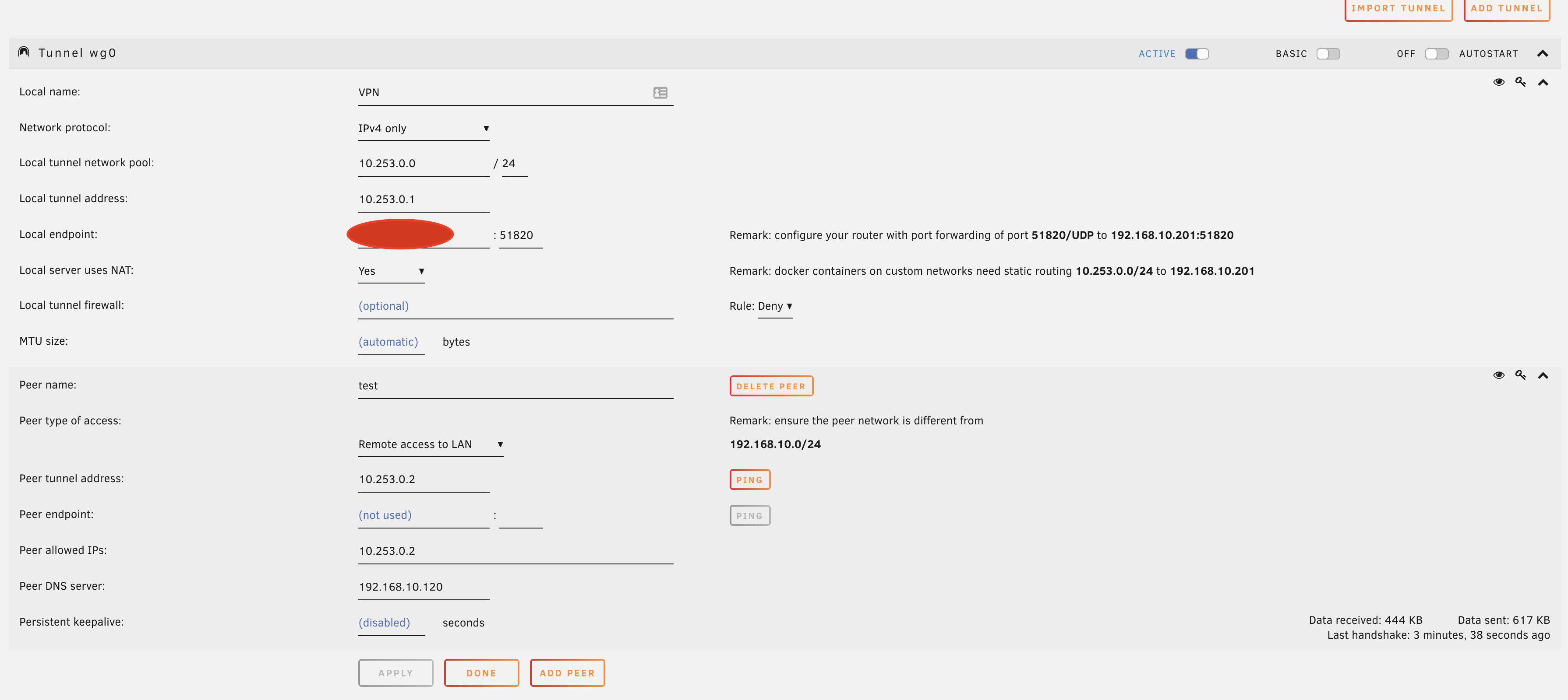

I installed the plugin, and when enabled, I can't even ping my UNRAID server on my local LAN. I can connect no problem, but when I am connected through my phone's data connection I can neither ping any local resources, nor access the Internet. I've tried uninstalling/reinstalling, and watched over a dozen different videos, and I'm pretty sure I've ran through just about every guide there is.
Router: 10.0.0.1 (TP Link ER-6120)
Unraid: 10.0.0.100
Internal LAN: 10.0.0.0/24
WireGuard LAN: 10.253.0.0/24
Public IP: myhost.duckdns.org (resolving properly)
NAT: Tried with NAT and without NAT (static route)
Please see the photos below:
I even tried widening the suggest /24 subnet mask to a /16. Is there something incredibly silly that I am missing?
$ ip route (UNRAID)
Traceroute/Ping from 10.0.0.100 -> 10.253.0.1 complete without issue

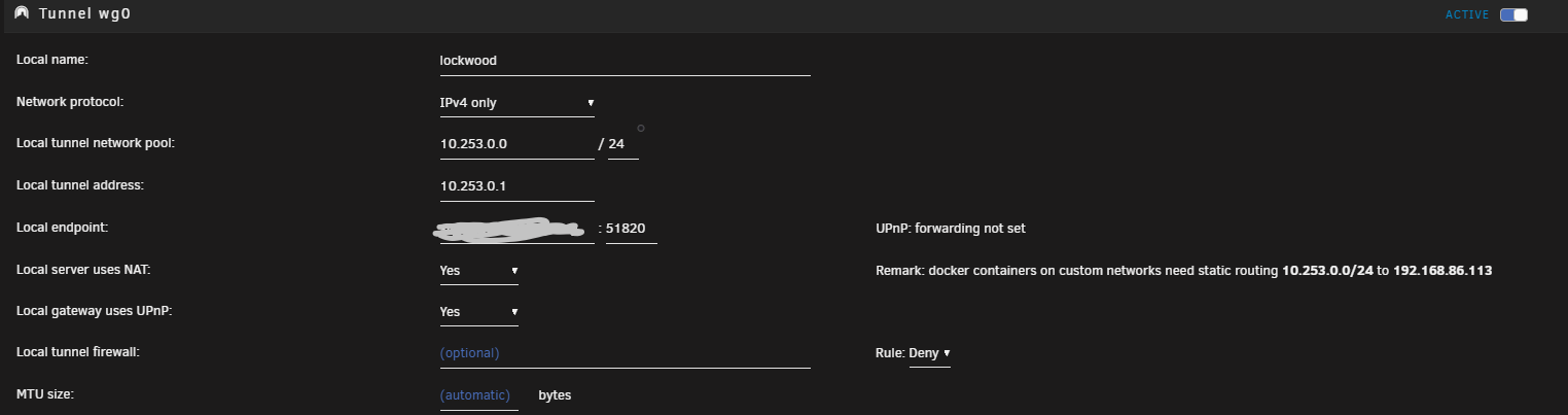

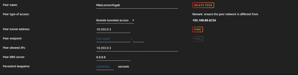

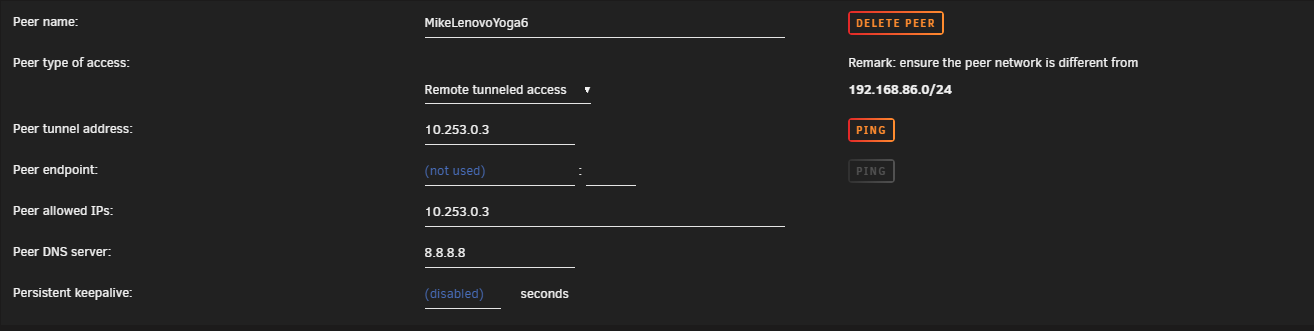

Once again, I fear I am out of my depth.  However, maybe you can help me to configure WIreguard as I need. I have followed some of the tutorials, and I can connect without issue. But I have some limitations that I think amount to my configuration abilities.
My goal is use my personal laptop while at work use Wireguard via my Unraid server. I would like to be able to use my laptop as if I was on my local LAN (my NAT/Router is a GoogleWifi/Nest. I previously had success with OpenVPN-AS docker. But I am less successful after starting with Wireguard. In particular, my local SMB shares, and access to locally hosted sites, such as a different Unraid installation (a different one that is not hosting Wireguard). Of course, also sending all web traffic through my home network as well.
For starters, I can successfully connect from my workplace with wireguard both with my cellphone (Android) and my laptop (window11).  My router has UDP 51820 forward to the Unraid Server with the Wireguard installation.
Perhaps I just don't understand the correct use case of some of the options/setting.
From watching a number of videos and the info graphic, I think I am correctly setting PEER TYPE OF ACCESS to "remote tunneled access".
My internal network is using 192.168.86.x if that helps.
As a for instance, when I am connect on my laptop from work, I cannot see any of my SMB network shares.  Also, my Plex server (running on the same machine as Wireguard) seems to be very flaky.  Sometimes working, sometimes not.  I cannot make a secure connection to my PlexServer without Wireguard.
Sorry if I am babbling.  Here are some pics of the Wireguard settings.
Wireguard.thumb.png.b45605036e8bbf139f0f7692eb667f78.pngWireguardPeer.thumb.PNG.daf23e0f7dd4ce9d3219ddeba689a9c5.PNG

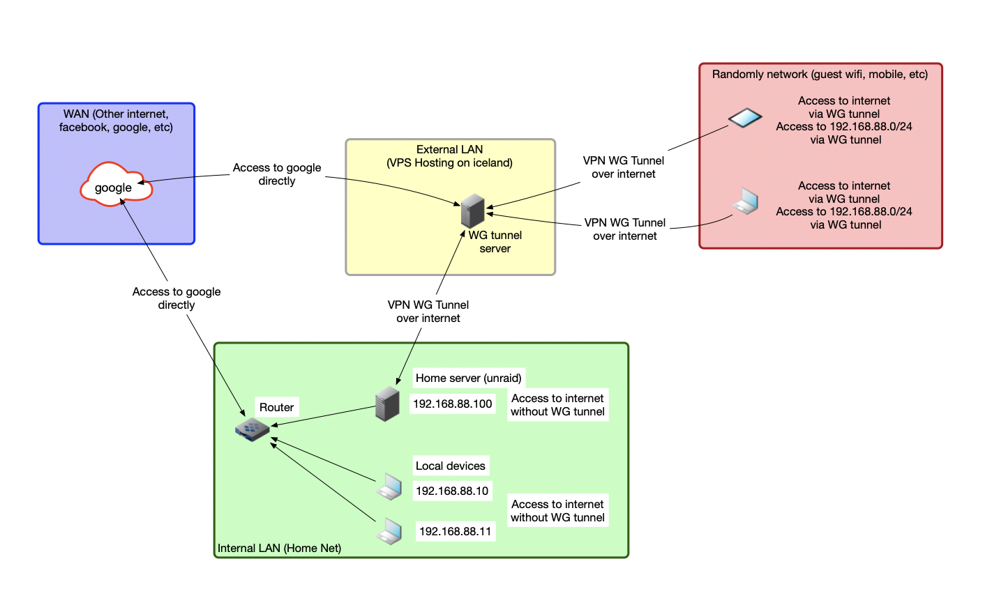

Good afternoon!
I want to implement a somewhat complicated scheme that is beyond my understanding.
I drew it in this picture (above).
I have:
1)Home network (green) with an unraid server, several devices on the LAN (pictured as laptops, although they are other servers and a bit IoT, lol) and a router that they are all connected to.
2)A server on a hosted VPS (yellow) outside my city and country, which is used to protect traffic from mobile devices (red) that can (and constantly do) end up on untrusted networks.
3)Mobile devices (which I mentioned above) (red) - laptop, phone, tablet that access the internet via guest wifi or mobile network.
4)And external internet resources (blue) - any websites. I drew google there, but it's not necessarily him. These are all things I access through my ISP.
Now I want to configure the VPN on Unraid so that the traffic flows like this:
The mobile devices still access the Internet via a VPN that is on an external server. But at the same time, they access the home network 192.186.88.0/24, the server and the local devices.
To do this, I need to make a connection where the server on the UNRAID connects to the front-end server via wireguard. (Or vice versa, the external server connects to unraid (it has a white address)).
But I don't understand how I can set up a connection through the Unraid GUI that would connect it as a client to an external server. I see the server-to-server and lan-to-lan options, but I always get "Data received: 0 B Data sent: 35.5 KB Last handshake: not received" when I try to enter the standard wg client credentials generated on the external server there. I haven't found any documentation about these functions, google didn't help.  Please help me.
