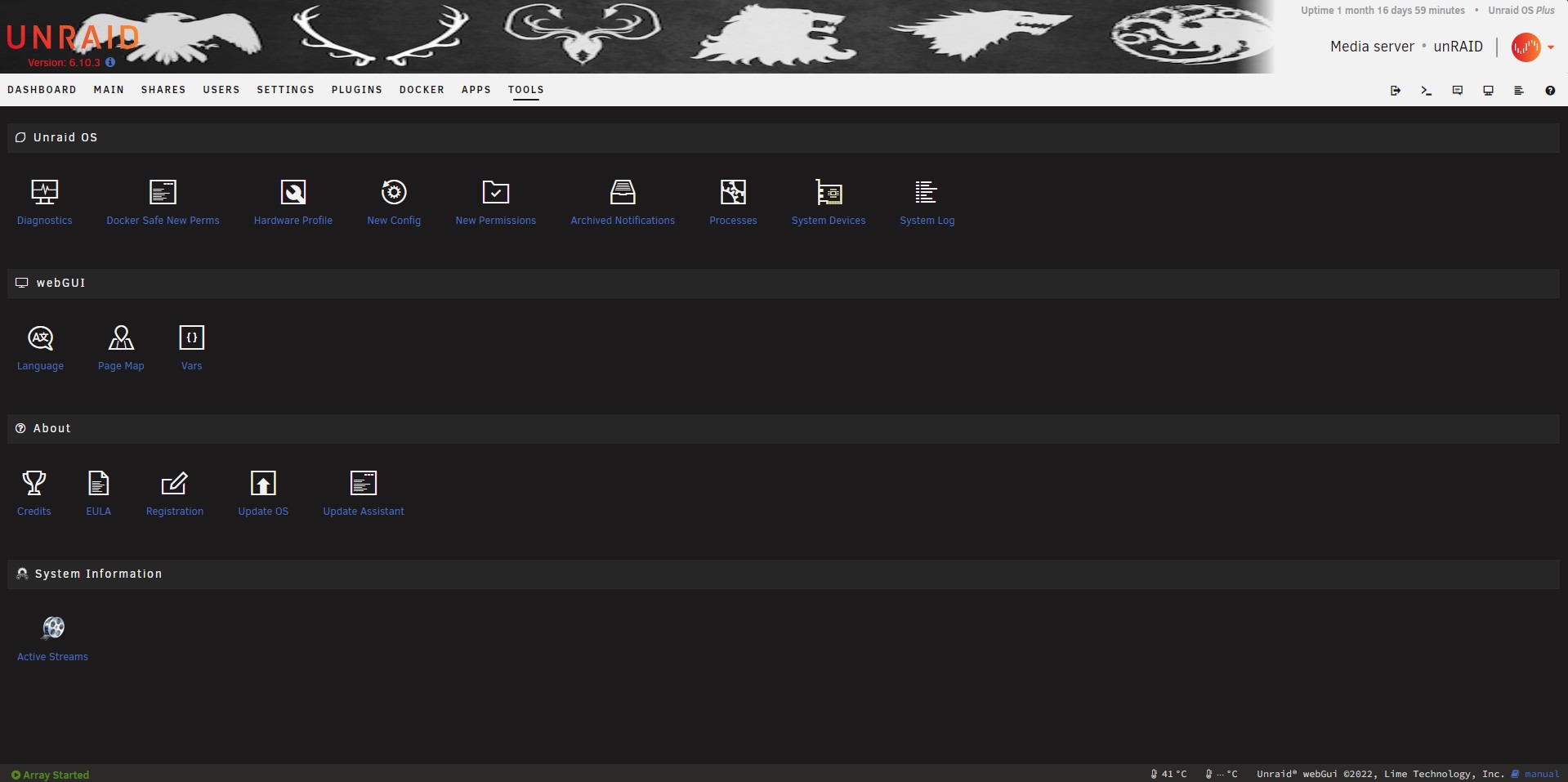

21 hours ago, itimpi said:
There is nothing to install if you are on 6.10.3 as it Wireguard is now built in so deleting the old plugin was the correct thing to do.   Are you saying that you do not have Settings->VPN Manager where you now configure Wireguard?
Well yes, unfortunately I don't have any wireguard plugin at the moment and there is no way to install it again other then reverting back to 6.9.9 installing it and then upgrading again to 6.10.3 and I believe that someone would know how to install it directly without having to do this exercise that is why I decided to ask here. Thanks for looking into it!

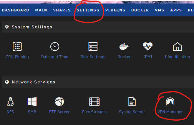

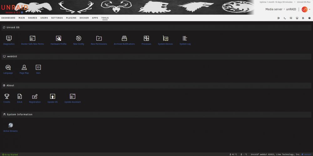

It's not under the Tools menu which you show in the screenshot.  As Itimpi mentioned, in unRAID 6.10.3, you should find it in the Settings menu as VPN Manager.
It is no longer a plugin so it is not in Plugins either.
Hi Hoopster and itimpi, then I need to apologize for wasting your time as that's true it is there and it slipped my mind to look in there.
Please take my sincere apologizes.

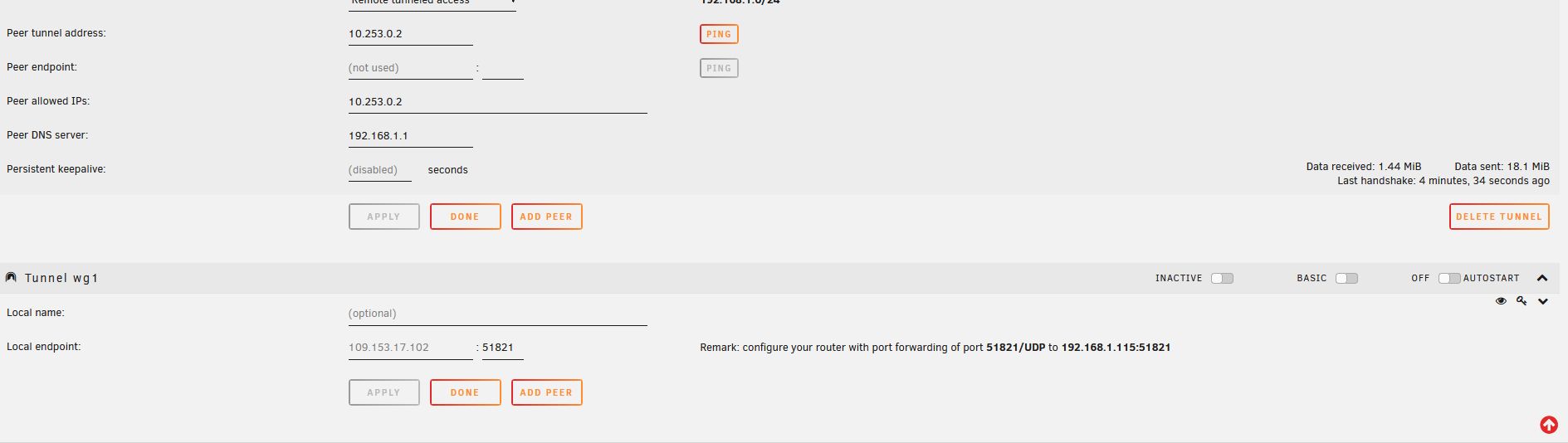

 I have Wireguard setup and have an "extra" tunnel. It shows in the VPN s ettings and Dashboard. I want to delete it.
I have advanced on. I can see a delete button for WG0 but it is for the tunnel I want.
There is no delete button for the other tunnel, WG1? I am trying to delete WG1. Ideas?
Thanks!
21 minutes ago, bonienl said:
Switch to “advanced view” for tunnel WG1
THANKS! Feel like an idiot - did not realzie there were multiple "Advanced Views" - Thanks!
OK - so have Wireguard working when I use my external IP (explicitly) in the configuration.
When I replace the IP with my duck DNS domain, it does not work.
I get the message to the side:
"Remark: The Local endpoint resolves to 31.53.XXX.XXX. In most cases, this should be your public WAN IPv4 instead: 109.153.XXX.XX"
Again - works fine if I use the 109.153.XXX.XX in the Wireguard setup. but not fine when I use mydomaninname.duckdns.org.
Ideas on what the issue might be?
Based on what you've written it sounds like your duckdns domain does not resolve to the correct IP address.
Agree 100%. I eventually installed "Wireguard Easy" and that seemed to fix it. No clue why.
