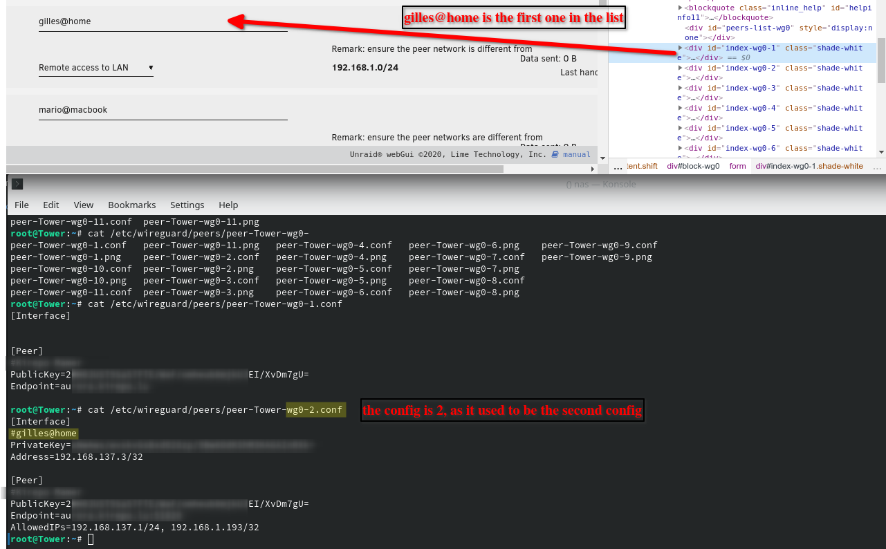

Hey all, sorry if this has already been reported, don't know how to search for this.
I have the issue that the wrong config is displayed for each peer. This happened when I deleted the peer before the one i am trying to view. The web page uses the list position in the web page to get the config. If you then delete the first one for example, the index of the second one becomes the first. And when I open this one, it shows the config for peer-Tower-wg0-1.conf  when in reality it should be peer-Tower-wg0-2.conf.
So, after deleting any one but the last peer, i can't use the gui any more as it's mismatched.

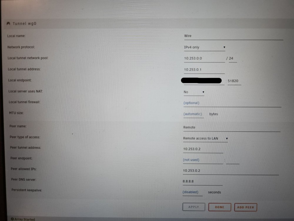

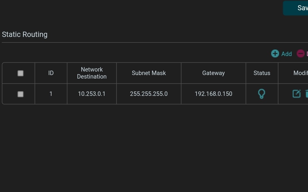

Can i have my settings checked please - Had to change router to setup static routing have been able to handshake and connect to unraid gui - but i am unable to access LAN
It looks like you setup a static route just to 10.253.0.1, this should cover the entire 10.253.0.0/24 subnet
There are also some tips in the second post here, such as making sure you have bridging enabled:
Having said that, there are a lot of people having issues accessing their LAN currently. I'd recommend reading the last few pages of this thread and the quickstart thread.
You are right!
As a workaround, after deleting a peer, make a change to any other peer and hit save. It will renumber the config files.

So once changes was made can access unraid from outside network on my work computer - but no matter what i do i cannot access from my Android phone - any ideas im lost
Update:
If i go into phone settings and add google as private dns - I can connect to unraid but loose internet access for web pages
Turn off private dns phone setting can then access web pages but cannot access unraid
Switch on wifi for work - can access web pages and unraid
