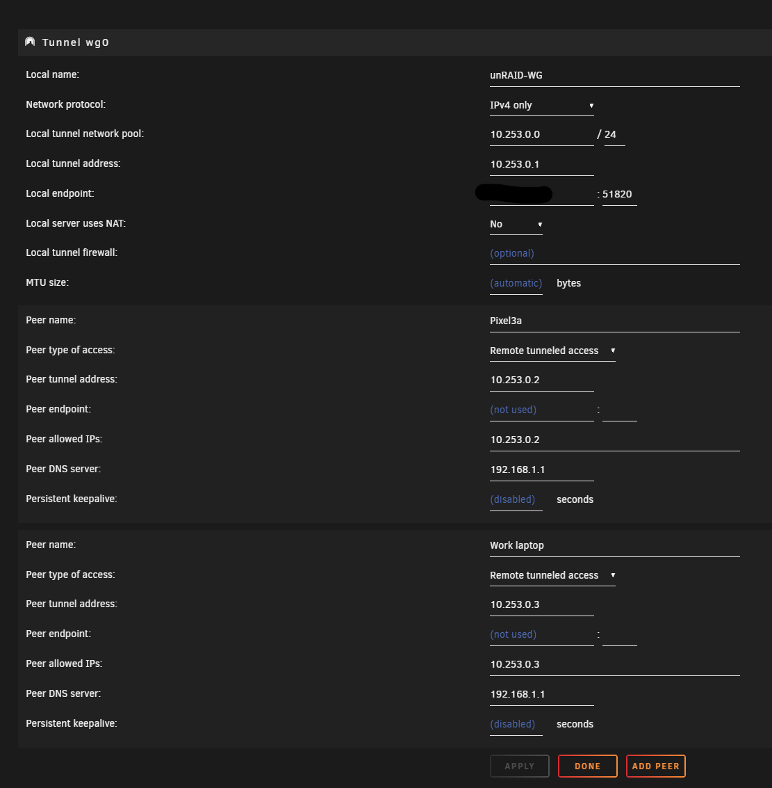

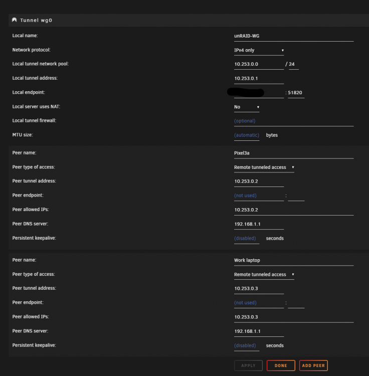

I've read this thread and some others with Wireguard topic and still searching for solution.
I have port forwarding and static route all setup on the router (Untangle).
I can successfully connect with my Pixel3a mobile phone to the internet and I can also reach all devices on 192.168.1.0/24 network and unRAID docker containers.
When I connect with my Work laptop I have internet access but no access to devices on 192.168.1.0/24 network and unRAID docker containers.
Both devices are on the same "at work" network when establishing VPN connection. What am I missing here. It doesn't make any sense to me.

2 hours ago, ljm42 said:
Just a guess, but perhaps your work laptop has software that prevents WireGuard from changing the DNS Server?
I don't think so. No special software and / or settings on that laptop. It's actually my laptop used also at work.
You might try accessing your home network by IP address rather than by DNS name.
I did.
UPDATE to my previous post
On my "Work laptop" I now tried to establish a connection with Access to LAN peer type of access and could connect to all devices in my 192.168.1.0/24 network including Pi-hole (192.168.1.15) which is on br0. In other words Access to LAN works OK but Remote tunneled access only works partially (I get my "home" WAN IP but couldn't connect to any devices in my 192.168.1.0/24 LAN).
Any thoughts or suggestions?

On 11/6/2020 at 8:24 PM, yogy said:
The strange thing is that with exactly the same configuration it works on my mobile phone but not on the laptop accessing unRAID server from the same "work" network.
Static route is set, also port forwarding. If it wasn't the connection on my mobile phone wouldn't work.
I appreciate your help though. Seems like I'll have to dig deeper.
I FOUND A SOLUTION!
yes, I'm answering to myself but hopefully others will find this useful.
If you are using Wireguard VPN app for Windows OS and try to connect to unRAID using Remote tunneled access here is a solution
This issue of broken local network routing appears to only happen in WireGuard for Windows.
On 11/10/2020 at 6:11 PM, yogy said:
I FOUND A SOLUTION!

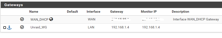

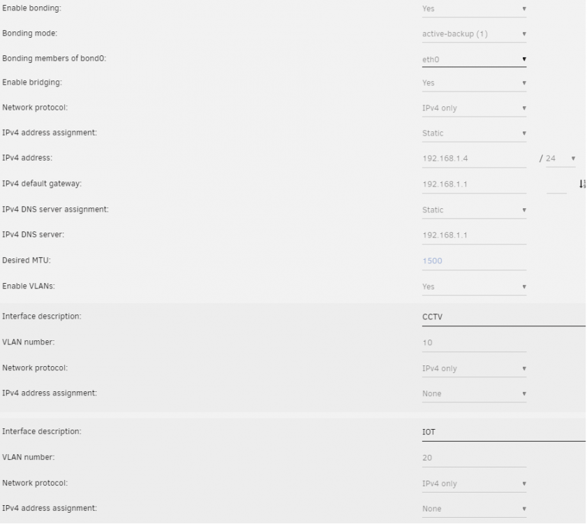

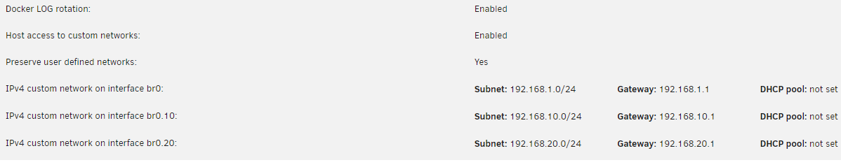

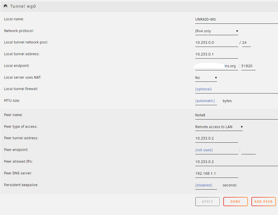

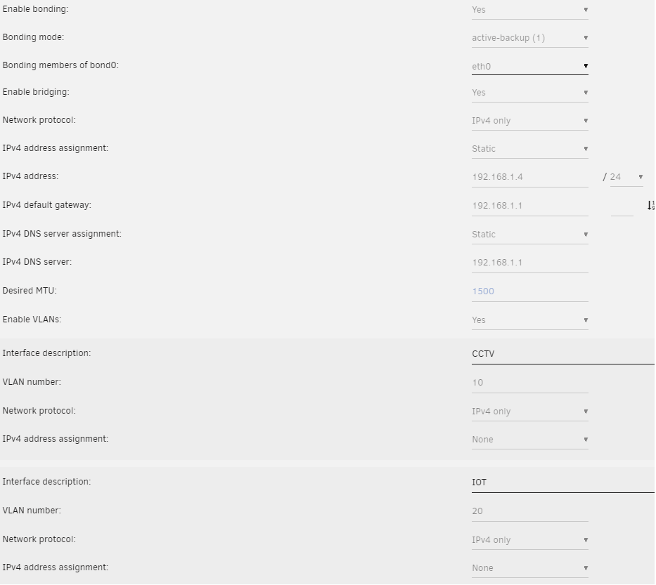

I have been trying for ages now to setup WG to access my dockers on my VLAN
Local access works fine!
I suspect it is something i'm missing in pfSense!
Here are my unraid settings:
And pfSense setting:
Anyone see anything obvious i have missed? I've read thru a number of threads and just cant pin point my issue
Thanks
