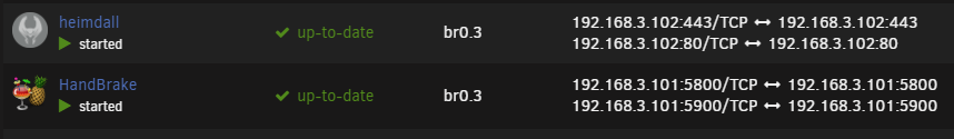

My docker containers with custom IP addresses are on br0.3 (192.168.3.x subnet).  None are on br0 (if you recall, br0 custom IP addresses caused call traces with my hardware).
A couple of examples

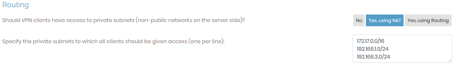

The WireGuard peer configuration shows the following Allowed IPs:  AllowedIPs=192.168.1.0/24, 192.168.3.0/24, 10.253.0.1/32

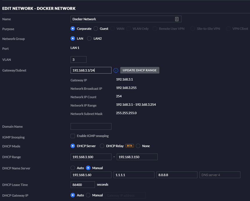

Local server uses NAT (new wording) is set to No.  There is a static route in my USG router from 10.253.0.0/24 to 192.168.1.10 (unRAID server IP)
Note: in your example earlier in this thread you had the Netmask as /16. I oirginally set it this way in the route.  The updated plugin prompt reads: "Remark: configure your router with a static route of 10.253.0.0/24 to 192.168.1.10" so I have now changed it to /24.

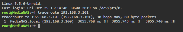

I have reapplied existing configuration.  I have rebooted the server.
I still have no access to docker container UIs on the .3.x VLAN.
Traceroute on 192.168.3.101 (HandBrake container)
 Issue here?
Docker VLAN configuration
Did I miss something or do I have something improperly configured?
