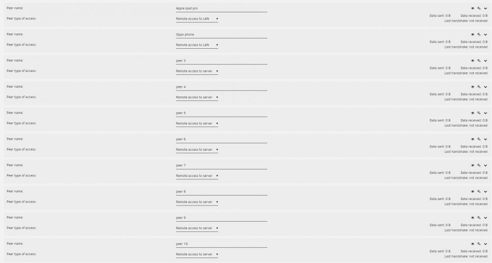

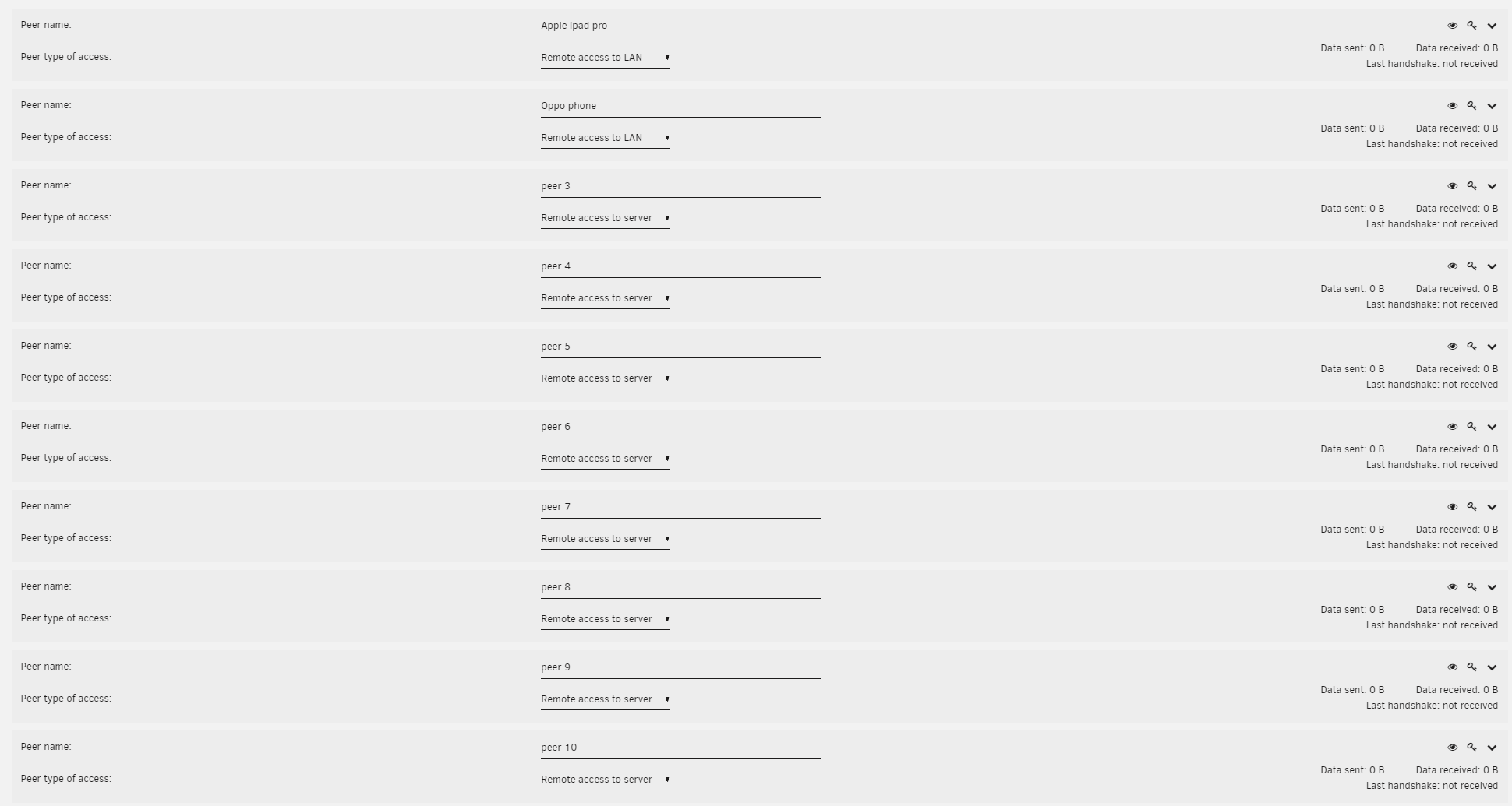

Hey I have a problem...
Wireguard randomly stops working (disables itself) and I have to manually enable it. And one additional problem is that when adding multiple (8 users) seems to crash the VPN itself. I just get a blank screen. And this screen doesn't change as well as the tunnel which doesn't ever start again. I can connect but handshake fails and keeps failing.
I have attached a screenshot.
kodeljevo-diagnostics-20200108-0910.zip

As a test I created 10 peers on the same tunnel, which works fine for me.
In your case are all peers active at the same time?

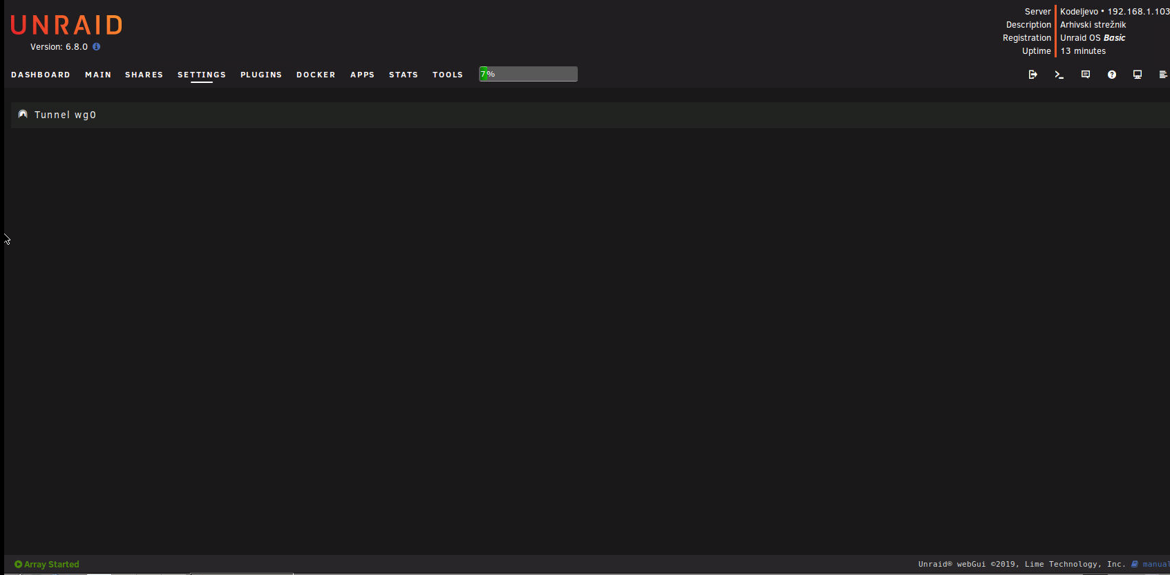

The screenshot is from after the reboot. But I have found out that the no tunnels showing problem is because of a VM not showing it so it's not a bug with Wireguard.
Only one user is active (me) and the rest were just created. Even if I change just the Peer name the software disables itself.
I have changed the IP address to another subnet and I'll see if it helps although this subnet should be perfectly fine.
