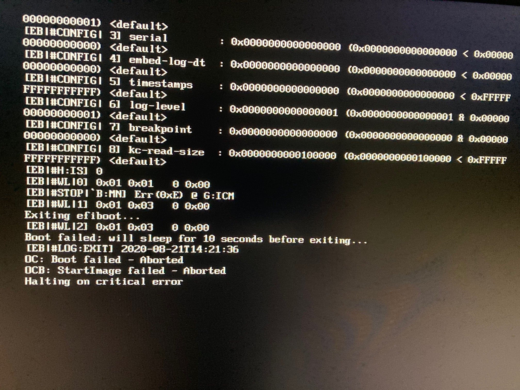

OK so I decided to take the plunge after reading all 21 pages. My assumption was that I could take a perfectly working Catalina vm made with macinabox, mount the clover qcow2 image, trash the clover efi folder, replace with the one from @Leoyzen's github and stand a decent chance of it booting, even with no alternations to the xml. Well that didn't happen.
I am able to get to the oc boot selector, but regardless of what is selected, the result is the same. This happens almost instantaneously after the boot selector. I also tried another OC.qcow2 image that was uploaded in this thread and the result was the same.  Not sure where to go from here. Maybe I'm missing something obvious? Anything I can provide to help in troubleshooting?
Edited by 1812
Yes, are you able to mount the qcow2 image in unraid, modify the config.plist and set target to 83? Shutdown the vm first, mount the qcow2, set target in EFI/OC/config.plist, unmount the qcow2 start the vm (it will give the same error), force shutdown the vm, mount again the qcow2 and you will find the bootloader log in the root of the EFI folder. That should help a bit to understand.
Or use the clover qcow2, boot the vm, mount the EFI folder in the vm, replace with opencore and set in the config.plist target=83 (maybe this is faster).
Ops, one important thing, you need opencore DEBUG version (not the RELEASE version), do you know if you have it?
Edited by ghost82
I only have what was pulled of of Leoyzen's GitHub page. Just now I attempted to locate it on the web but apparently my google-fu is a bit weak today...
Tomorrow I will try to pack a qcow2 image for you; in the meantime you could pm me sensitive data of your system, serial number, smbios data, uuid, etc. so that I can pack properly the image.
Config.plist of clover should be enough to have all the data including all customizations.
Otherwise I could pack a general image with the latest versions of oc and kexts.
Please paste also the xml of the vm.
Which version of Catalina are you running?
Edited by ghost82
xml (had to copy from the running vm)

Thanks, no luck, I was hoping in an issue of the vm layout, but even with your layout still that damn messages of stall :(
On 9/4/2020 at 1:53 PM, ghost82 said:
IOKit Daemon (kernelmanagerd) stall[0], (60s): 'ISA'
Yess! I found the culprit!
Big Sur >= beta 5 doesn't like my AppleLPCInjector kext.
By disabling it no more stall messages and boot and shutdown a lot faster.
Update: My injector kext was injecting pci8086,2918; to load again AppleLPC without stall messages now I'm injecting without any injector kext but simply in opencore pci8086,2916.

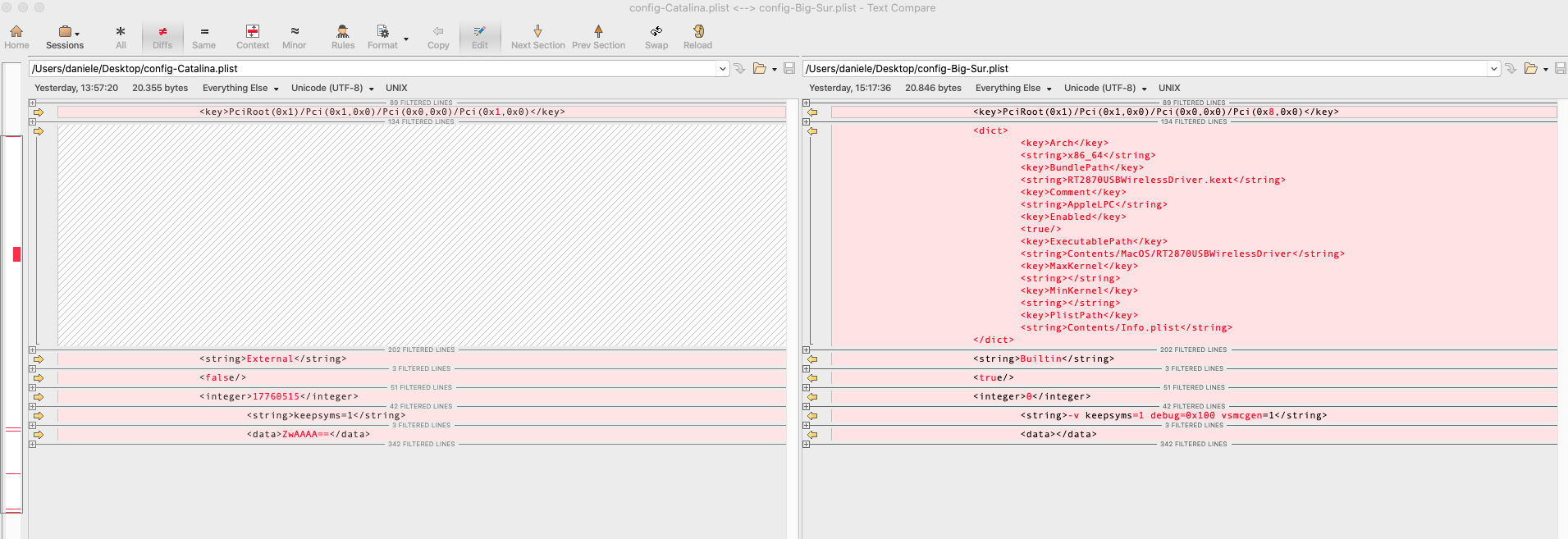

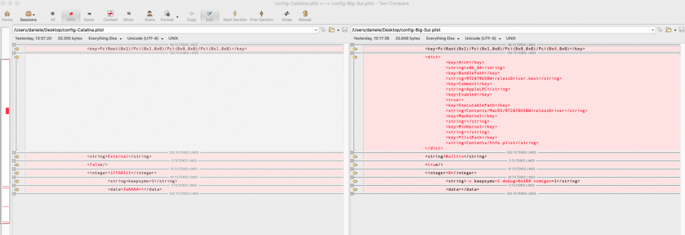

BTW when you said the two EFI are compatible, which did you mean? The one in the Github link on the first page? If so, you should be able to upgrade to Big Sur without any EFI change?
My EFI is heavily customized because of different injected device properties, network, audio, custom smbios data, lpc,.., I started to use opencore before that github page.
However, I'm quite sure the actual efi to boot catalina will work for big sur, opencore team is adjusting things and I'm sure it will be ready for the official stable release.
My efi to boot Catalina is working to boot big sur (I'm speaking about general quirks, not customized ones).
As you can see differences are:
1- different address to specify en0 built-in (not critical to boot)
2- added injected kext for my usb wifi (not critical to boot)
3- different bootpicker (not critical to boot)
4- different scan policy (not critical to boot)
5- different boot args (vsmcgen=1 needed in my case to install)
6- different specification for csr-active-config (not critical to boot)
