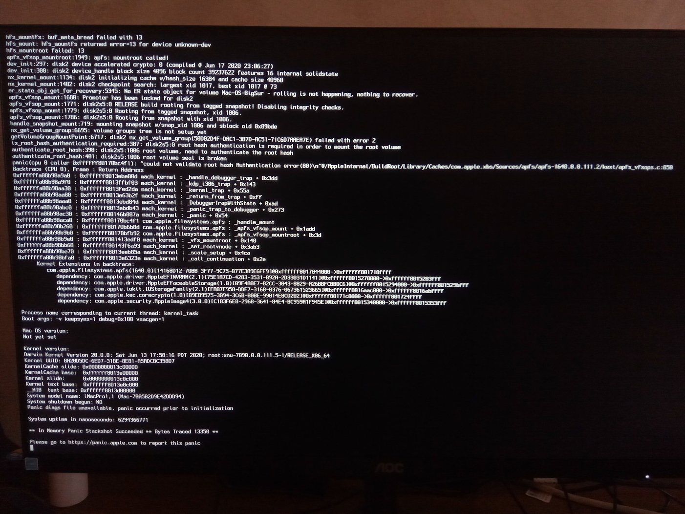

Here issues start again: I followed 2 guides:
First one:
- generate and tag a new snapshot:
sudo /System/Library/Filesystems/apfs.fs/Contents/Resources/apfs_systemsnapshot -s "Mysnapshot" -v /Volumes/MacOsVolumeName
sudo /System/Library/Filesystems/apfs.fs/Contents/Resources/apfs_systemsnapshot -r "Mysnapshot" -v /Volumes/MacOsVolumeName
- Reboot
However after a reboot all I have is a kernel panic complaining about that the filesystem seal is broken
Second one:
After modification, I run this command (from recovery):
bless --folder /Volumes/MacOsVolumeName/System/Library/CoreServices --bootefi --create-snapshot
But again same kernel panic about broken seal.
Another guide added some more steps for guide 1:
- installing kext after the copy (from recovery):
kmutil install --update-all --volume-root /Volumes/MacOsVolumeName
Again generate and tag a new snapshot:
- Copying updated BootKernelExtensions to the Preboot:
Mount Preboot:
diskutil mount diskZsX
Copy BootKernelExtensions to Preboot:
cp /Volumes/MacOsVolumeName/System/Library/KernelCollections/BootKernelExtensions.kc /Volumes/Preboot/<UUID>/boot/System/Library/KernelCollections
cp /Volumes/MacOsVolumeName/System/Library/KernelCollections/BootKernelExtensions.kc.elides /Volumes/Preboot/<UUID>/boot/System/Library/KernelCollections
- Reboot
And again same kernel panic...
I'm running out of ideas...it seems I'm missing the last step, like seal again the volume or disable the seal check (I was thinking that SSV is disabled by authenticated-root....).
Anyone with ideas?
Edited by ghost82
Further progress on this, now able to mount in read and write, do modifications and boot without kernel panic.
Steps:
1- Enable JumpstartHotPlug in opencore config.plist (needed to boot into recovery)
2- Delete any data in csr-active-config field in open core plist (add section of NVRAM)
<key>csr-active-config</key>
<data></data>
3- Boot into recovery, disable SIP and Authenticated-root (update: 2 reboots into recovery maybe required, csrutil is not disabled if the following 2 commands are given during the same boot, if this is the case reboot into recovery and disable csrutil again)
csrutil disable
csrutil authenticated-root disable
4- Reboot and boot again into recovery, verify SIP and authenticated-root are disabled
csrutil status
csrutil authenticated-root status
5- List disks, unmount Mac OS, identify Mac OS disk and mount it in r/w
diskutil list
diskutil umount /Volumes/MacOsVolumeName
diskutil mount diskXsY (replace X and Y)
mount -uw /Volumes/MacOsVolumeName
6- Tag an empty string snapshot to boot from the live disk
/System/Library/Filesystems/apfs.fs/Contents/Resources/apfs_systemsnapshot -v /Volumes/MacOsVolumeName -r ""
7- List and delete all other snapshots
diskutil apfs listSnapshots diskXsY (replace X and Y)
diskutil apfs deleteSnapshot diskXsY -uuid UUIDHERE (Replace X, Y and UUIDHERE)
8- Reboot to Mac OS and mount / in r/w
sudo mount -uw /
Now instead of failed with 66 you can mount / in r/w and do your modifications and reboot without kernel panic.
Now the missing step is how to seal again everything? Because now every time you boot into Mac OS you can mount / in r/w (in other words, once I finished I'd want back the failed with 66!!)
Edited by ghost82
