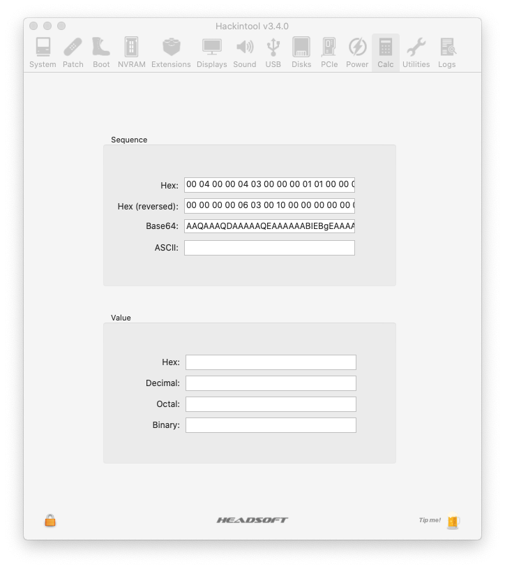

For framebuffer I think you have a clover patch?Just convert to be used with opencore: take the following as an example for Orinoco framebuffer patch:
		<key>Patch</key>
		<array>
			<dict>
				<key>Base</key>
				<string></string>
				<key>Comment</key>
				<string>Orinoco Patch for RX 580</string>
				<key>Count</key>
				<integer>1</integer>
				<key>Enabled</key>
				<true/>
				<key>Find</key>
				<data>
				AAQAAAQDAAAAAQEBAAAAABIEBgEAAAAAAAQAAAQDAAAA
				AQIBAAAAACIFBAMAAAAAAAgAAAQCAAAAAQMAAAAAABEC
				AQIAAAAAAAgAAAQCAAAAAQQAAAAAACEDBQQAAAAABAAA
				AAQAAAAAAQUAAAAAAAAAAwYAAAAA
				</data>
				<key>Identifier</key>
				<string>com.apple.kext.AMD9500Controller</string>
				<key>Limit</key>
				<integer>0</integer>
				<key>Mask</key>
				<data>
				</data>
				<key>MatchKernel</key>
				<string></string>
				<key>Replace</key>
				<data>
				AAQAAAQDAAAAAQEAAAAAABIEBgEAAAAAAAQAAAQDAAAA
				AQIAAAAAACIFBAMAAAAAAAgAAAQCAAAAAQMAAAAAABEC
				ABQCAAAAAQUAAAAAABAAAwYAAAAA
				</data>
				<key>ReplaceMask</key>
				<data>
				</data>
				<key>Skip</key>
			</dict>
You can use Hackintool to convert hex from clover to Base64 for opencore:
And use lilu+whatevergreen.
