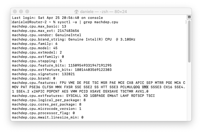

I tried with my 2x e5-2687w and the following steps should enable nested virtualization (I checked only for the vmx flag, I didn't try to install any docker or vm in vm):
1- in your mac os vm type into terminal "sysctl -a | grep machdep.cpu" and check that the vmx flag is not there

8- start your mac os vm and check from the terminal for the vmx flag: "sysctl -a | grep machdep.cpu"

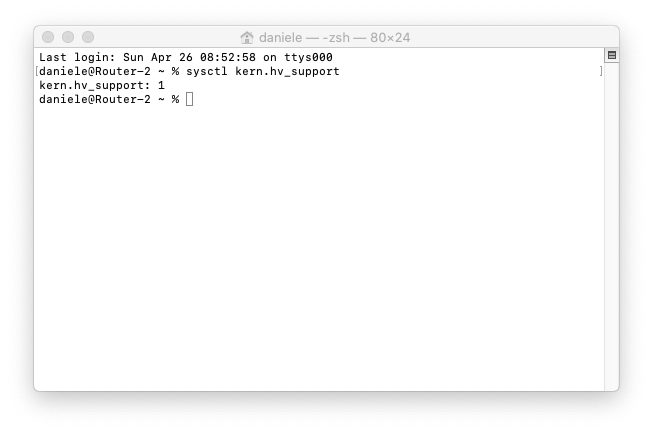

Check also in the mac os vm with the command "sysctl kern.hv_support" that the cpu complies with all the Hypervisor.framework requirements : output should be "kern.hv_support: 1"
Docker will not work with "kern.hv_support: 0"

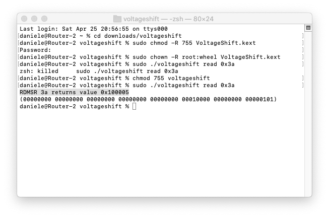

Then,you need to check for the bios and you can use voltageshift (attached version for 10.15) and read the cpu register 0x3a: it should return 0x5 or 0x100005
Extract voltageshift, give proper permissions to the kext:
sudo chmod -R 755 VoltageShift.kext
sudo chown -R root:wheel VoltageShift.kext
cd to the folder and run in terminal:
sudo ./voltageshift read 0x3a
Let us know

daniel@daniels-iMac voltageshift-10 % sudo chmod -R 755 VoltageShift.kext
Password:
daniel@daniels-iMac voltageshift-10 % sudo chown -R root:wheel VoltageShift.kext
daniel@daniels-iMac voltageshift-10 % sudo ./voltageshift read 0x3a
RDMSR 3a returns value 0x5
(00000000 00000000 00000000 00000000 00000000 00000000 00000000 00000101)
daniel@daniels-iMac ~ % sysctl -a | grep machdep.cpu
machdep.cpu.max_basic: 13
machdep.cpu.max_ext: 2147483656
machdep.cpu.vendor: GenuineIntel
machdep.cpu.brand_string: Intel Core 2 Duo P9xxx (Penryn Class Core 2)
machdep.cpu.family: 6
machdep.cpu.model: 23
machdep.cpu.extmodel: 1
machdep.cpu.extfamily: 0
machdep.cpu.stepping: 3
machdep.cpu.feature_bits: 11437491729185111039
machdep.cpu.extfeature_bits: 4967106816
machdep.cpu.signature: 67187
machdep.cpu.brand: 0
machdep.cpu.features: FPU VME DE PSE TSC MSR PAE MCE CX8 APIC SEP MTRR PGE MCA CMOV PAT PSE36 CLFSH MMX FXSR SSE SSE2 HTT SSE3 VMX SSSE3 CX16 SSE4.1 SSE4.2 x2APIC POPCNT AES VMM PCID XSAVE OSXSAVE AVX1.0
machdep.cpu.extfeatures: SYSCALL XD EM64T LAHF RDTSCP TSCI

daniel@daniels-iMac voltageshift-10 % sysctl kern.hv_support
kern.hv_support: 0
I did all steps you wrote.
Still have hv_support 0.
Does hv_support return 1 at your environment?
mmm, yes it returns 1, if it is 0 docker will not work..can you delete the line in the xml for vmx in the cpu section (no need for it if cpu supports vm-x and it is passed through), what is your cpu and what mac (smbios) are you virtualizing?
