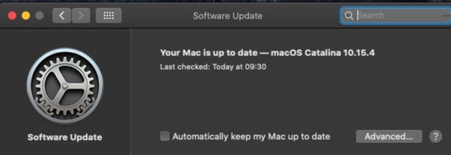

10.15.4 is out. Backup your VMs and give it a go.
Unfortunately this update probably broke the x86_validate_topology patch: I have a kernel panic related to it if booted with smp argument (equivalent to topology in xml).
I just updated and everything went well. I don't use the topology patch and using 0.5.7. I did see this this on reddit, so it may help with the patch.

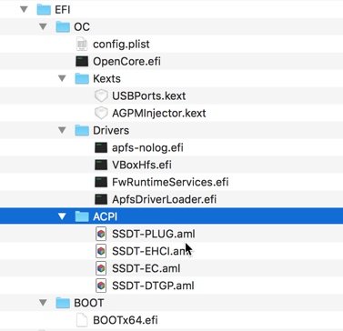

00:000 00:000 OC: Failed to find ACPI SSDT-DTGP.aml
00:021 00:021 OC: Failed to find ACPI SSDT-EC.aml
00:026 00:005 OC: Failed to find ACPI SSDT-EHCI.aml
00:031 00:005 OC: Failed to find ACPI SSDT-PLUG.aml
00:067 00:035 OCB: Failed to fix the default boot Device Path
edit/correction :  these messages i also get with a succefull boot in 10.15.3 so likely not the cause
p.s. No screen attached , nothing passed thru, zero non apple kexts, just a clean catalina vm with vnc display btw.
Any ideas top of your head ?

@fr05ty @glennv
I update the git repo(add MCEDisabler) and tested it in 10.15.4, it's all fine.
Did you add Lilu/WEG/AppleALC to your kexts folder and enable it in config.plist?
Did you put all others things under repo EFI to your EFI folder?(Because from your logging, the ACPI staffs is missing)
Tnx, will try your new repo. I did not put Lilu/WEG/AppleALC yet in there as it all worked fine without it in 10.15.3, but was on my list to test.
For the rest i just cloned your whole EFI folder so its there.
update: With your new EFI and latest WEG/Lilu, it seem to pass this freeze point now and is upgrading. Just see Japanese text instead of english that its upgrading and a counter. Saw that also yesterday in recovery partition hahaha. No idea why. Lets see if it finishes, but probably it will be fine now.
Edited by glennv
Done. Tnx for the help and the nice start in the OC world. HAve to start doing some reading i guess ;-)
