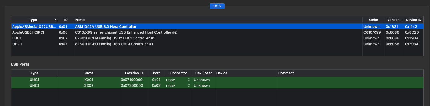

I am currently trying to passthrough my entire Intel USB controller, but macOS does not seem to recognize the devices connected to it, it shows as an USB controller but is not named correctly. I have tried with USBInjectAll.kext and XHCI-unsupported.kext without luck. Do I need to rename the device under DeviceProperties? 244192357_ScreenShot2020-03-31at1_25_01AM.thumb.png.34d2fd095403c106ed7680bedbb0b5a1.png2021241368_ScreenShot2020-03-31at1_25_11AM.thumb.png.f7cced99a67871d34d2f33da494eb865.png1530262788_ScreenShot2020-03-31at1_25_26AM.png.388b5751c79ce1f1f154caaab724fcbb.png
@chalbolyDid you passthrough your usb controller using bus 0x0/slot 0xy instead of bus0xy/slot 0x0?
@Leoyzen I just changed the bus to 0x00 and changed the slot, I can see the controller type is now named S30. I know it must be renamed properly so it can be recognized by the USBInjectAll.kext. How can you rename the device in the config.plist?
Edited by chalboly
@chalbolyNo, it not related to ACPI name. USBInjectAll find the device by vendor_id and device_id.You should check whether your usb controller (8086_8d2d)  is supported by USBInjectAll.kext.
@Leoyzen Unfortunately it does not seem to be supported by USBInjectAll.kext.
What is strange is that I can see the controller and the devices connected, this controller is internal and the only device is the Bluetooth, but this is not detected at boot but rather later when in macOS and when I open the IOregister app. Of course Bluetooth does not work because it can't be patched by BrcmPatchRAM at boot.
@Leoyzen I decided to just pass through a different USB controller (ASM1042A) and is working fine. Bluetooth is internal USB on my motherboard so I'm just passing through the USB device, works without any patches except that I am having issues with connected devices. If I use AirPods they disconnect after a while or have audio dropouts. Apple Watch unlock works for a moment and then disconnects. Handoff is also intermittent, so something seems off.  Do you know if SSDT patching is required? Map the virtual USB ports correctly depending on the SMBios?
Edited by chalboly
@chalbolyWe can't map virtual usb ports now.(I can't find a way to do that like standard usb3 ways).So the bluetooth we passthrough is not recoginized as internal which may cause problem.Try using usb bluetooth instead.

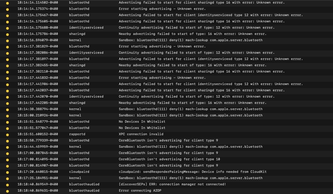

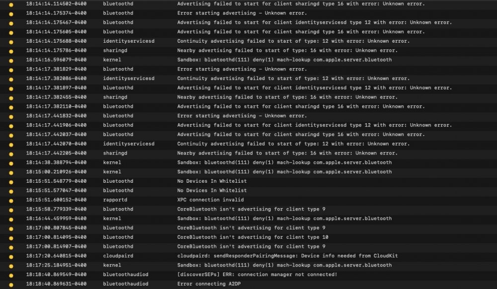

@Leoyzen Thanks, I just tested with a USB Bluetooth device, based on the same chipset BCM920702 which is supported without additional kexts, but the same issue persists. There is audio dropouts when connected to Bluetooth headphones, Continuity works sporadic and Apple Watch unlock does not stay connected to the watch. There are a lot of errors in the logs about this. My Wi-Fi is natively supported (BCM4360). I also moved the USB Bluetooth right next to my devices using an extension. The signal did not improve much (checking with Bluetooth Explorer), and had the same issues, so not sure what else to try.
