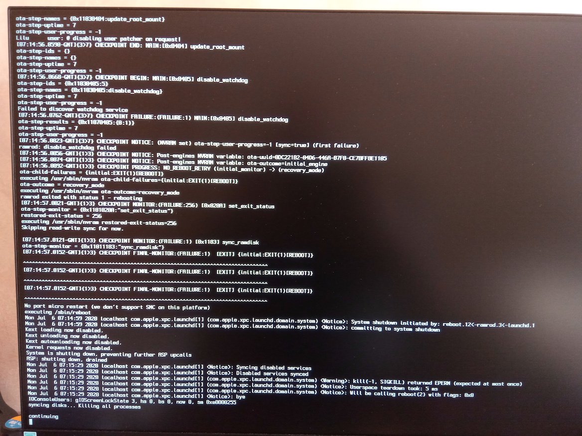

Same here, but partially success..It hangs after the second reboot, after booting from Preboot; latest error is: No port micro restart (we don't support SMC on this platform)
After this it reboots and loops.
It seems the same issue reported here:
http://bbs.pcbeta.com/forum.php?mod=viewthread&tid=1861942
And by translating the content they said they copy another clover efi, boot from oc, pointing to clover, pointing to mac os, but I don't like it at all.
Things are moving faster now!
Edited by ghost82
Adding vsmcgen=1 (virtualsmc) to boot-args solved the issue and the installation seems to proceed, I will update later.

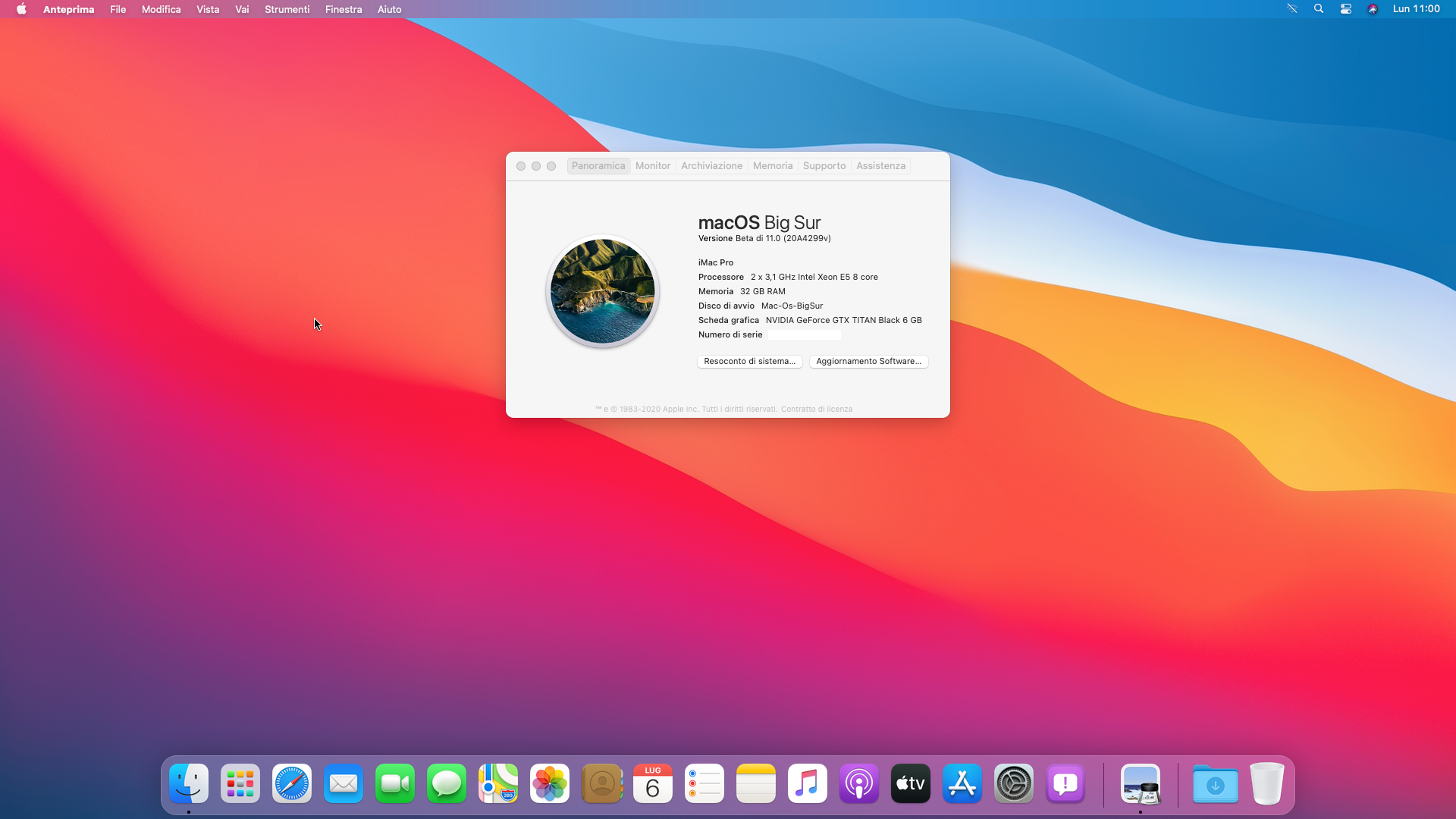

UPDATE: after solving the above issue it was stuck at "Forcing CS_RUNTIME for entitlement: com.apple.rootless.restricted-block-devices": I needed a forced shutdown and a new boot pointing at the new partition (Mac-Os-Big-Sur) or whatever you named the hd.
SUCCESS (installation, not restore)
Kext injection and kernel patching work, audio works, gpu passthrough works, cpu passthrough works! All seems to work quite well for this dev beta.
