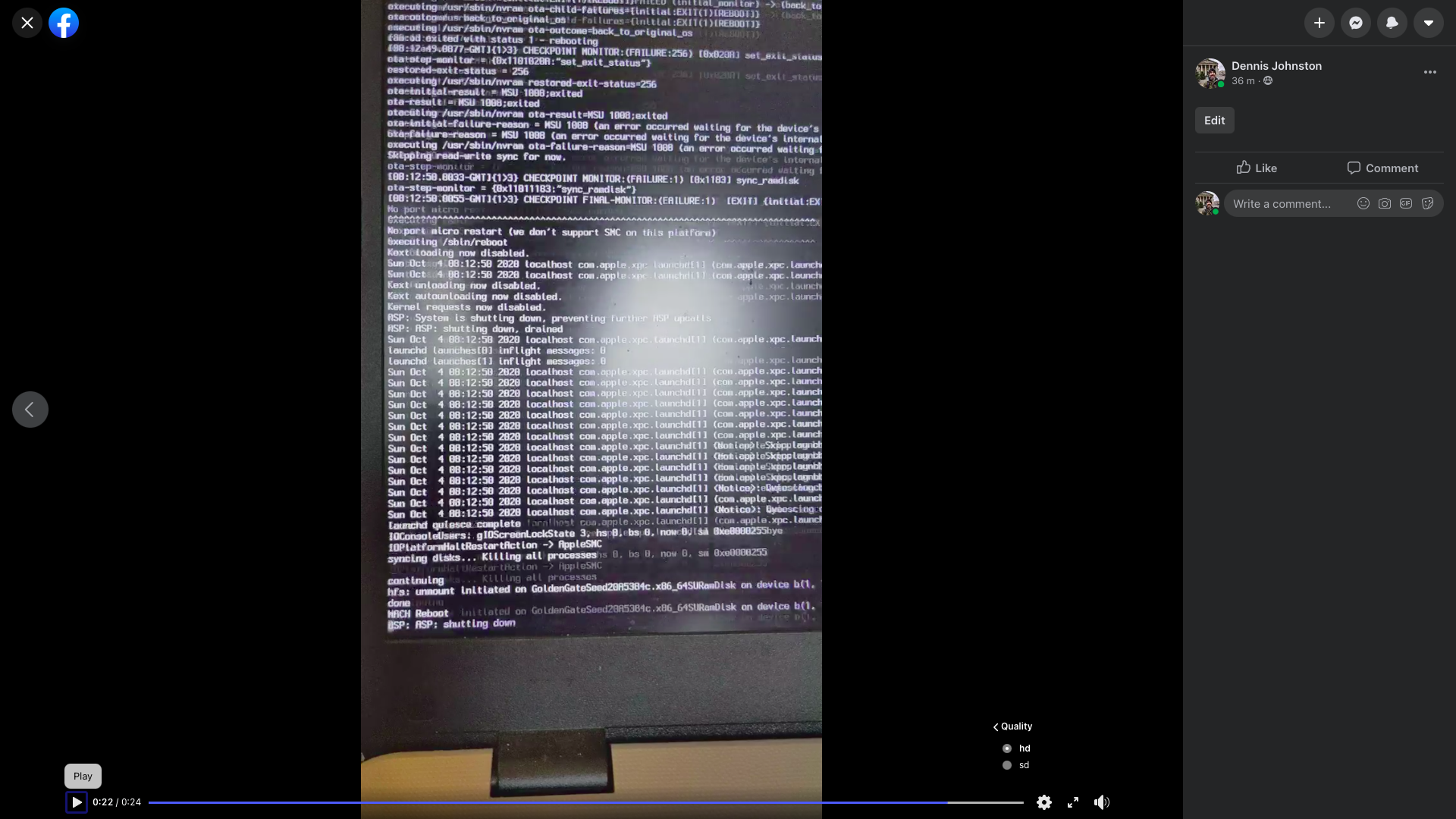

Hi folks...
I am trying to get to beta 9 , have configured open core 0.6.1 with config.plist, drivers, kexts, etc but am getting stuck at
no port micro restart  we dont support smc on this platform
Any suggestions?
Are you using virtualsmc?
If not use it, and update it to the latest version, older versions need the boot arg vsmcgen=1
It's also a good idea to use the latest master version of opencore and of all the kexts you are using.
I thought I was, yes. Ill try the zip . Thanks!
Checked my oc version,
I have 0.6.1 from sept 7 release
Updated kexts accordingly
1952847334_Screenshot2020-10-04at10_53_30.thumb.png.048c9ae346befd1c1df9880e73b9ebad.png
Got rid of virtualsmc bootleg and WE bootlegs. Booted my other ssd fine with beta 4.
When trying to update again, I am getting stuck here right before a forced reboot(see screen shot, albeit it is a bit hard to make it out-starts at "IOconsoleusers" on bottom but can't quite make it out)
Edited by Xdevillived666
