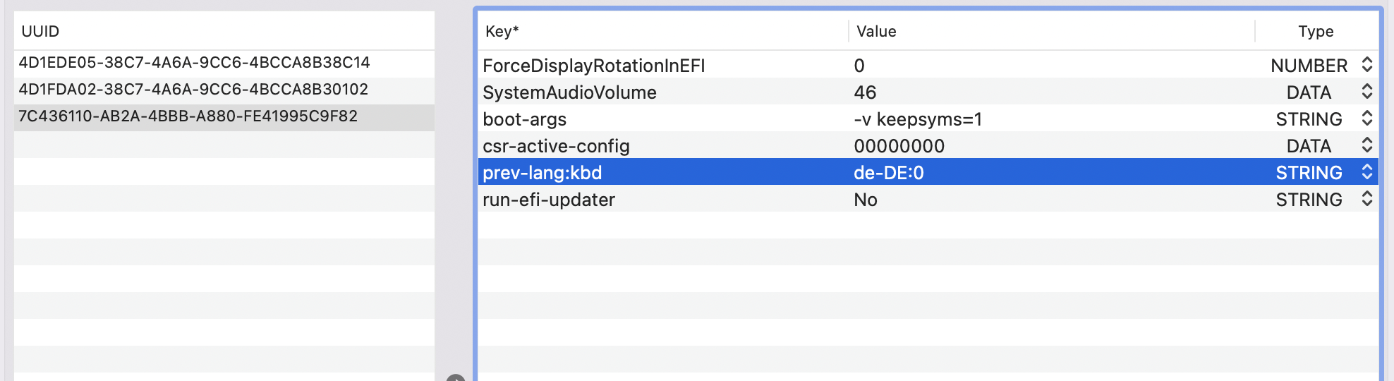

I am getting there, slowly.
Using a BigSur Recovery Image which I build, based on Opencore 075. GPU and M.2 Passthrough seem to work well.
However, seems like I cannot get the Installation language to switch to ENG or German, even though I changed the String (Which is the right one I think).
Check in config.plist prev-lang:kbd nvram argument.
Opencore developers set it by default to ru-RU:252.
For en-US:0 set it to <data>ZW4tVVM6MA==</data>
or use a text to base64 converter to input your value.
Uh sorry, I saw that you changed it..try only de-DE
Edited by ghost82
Thought I did that, changed value to German.
Will check with Propertree in the morning.
yes sorry I saw now..try with de:0 only as "string", or ZGUtREU6MA== as "data".
Reset nvram if it still doesn't work.
Edited by ghost82

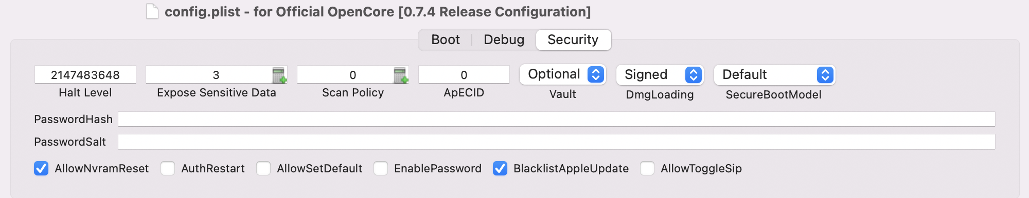

How do I do that? Within OC or within the Boatmenu? With other VMs I have seen a boot menu entry to reset the NVRAM but this one does not show this option, even though I set the flag in OC (the right one?)
1071329816_Bildschirmfoto2021-11-03um08_31_49.thumb.png.8664d7dc8104ee58d5c7f8ebab8c6610.png

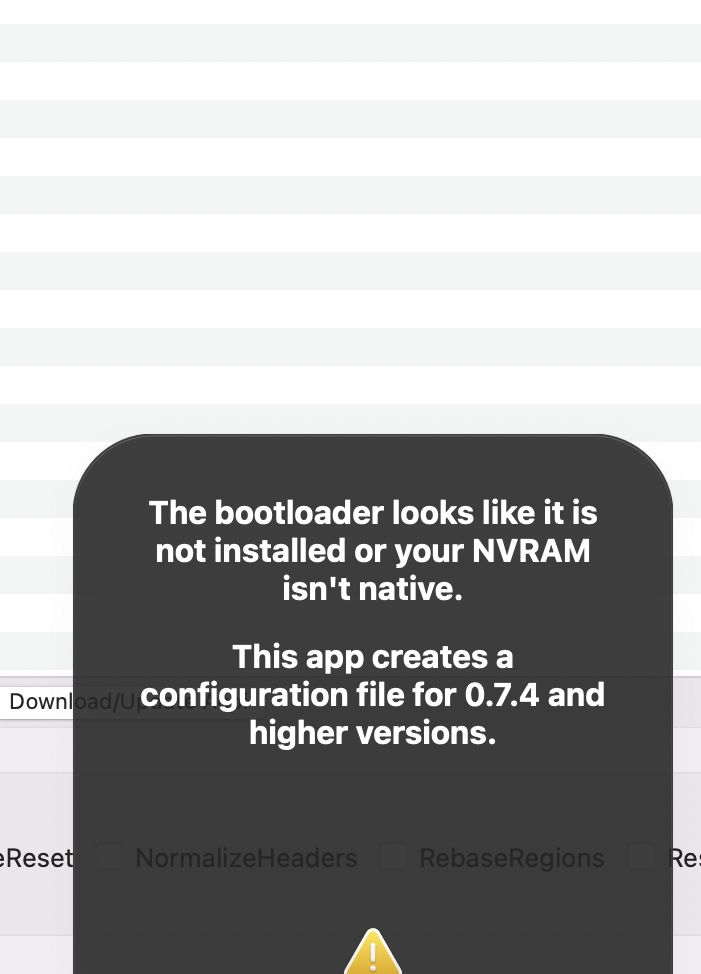

OC also throws this error when I start it and load the config I am using. Is this connected to the issue above? I am using OC 2.52.0.1
503609099_Bildschirmfoto2021-11-03um08_28_39.thumb.png.75c20964b9bb5a6180a0619275519a3d.png
Within the boot menu: either change in your config.plist showpicker from false to true, or press '0' and let it pressed once you start the vm and the boot menu should appear.
However, are you able to see the boot menu but there's no entry for nvram reset? if so share the efi, because from that 2 errors it seems you are not opening the right config.plist..
About the error I don't know, if you can share the efi folder or image in private I can try to replicate it.
