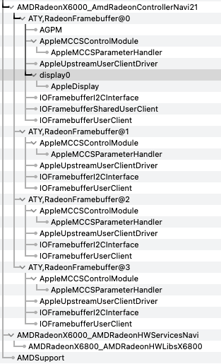

On 11/28/2021 at 3:01 AM, pavo said:
All display ports work without WEG.
New monitor arrived and at least I don't have to send it back, it just works with its dp cable.
I want to report that for my gpu (6900 xt sapphire nitro+ SE) without whatevergreen I have the hdmi and only one displayport working out of the box. I need whatevergreen to enable all displayports.
This gpu has 1 hdmi + 3 dp
Edited by ghost82

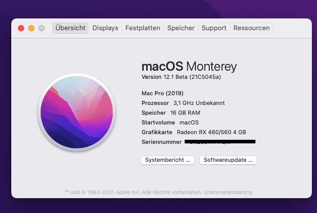

I started to play around with a RX460 and RX560. Got the 460 passed through and wanted to change the screen hz from 37,5hz to 60hz (3440x1440), which resulted in a black screen. Since rebooting etc. didnt help I had to reinstall.
Could the HDMI over IP Extender be the issue here? Is there a way to reset the GPU settings from cmdline/recovery, without reinstalling OS?
A fresh install with BigSur on a vdisk works fine. Could also upgrade to Monterey 12.1 Beta.
GPU: Gigabyte RX460
Airdrop / Wifi works fine
1286309461_Bildschirmfoto2021-12-12um00_07_30.png.4b2d0d2fdf9463d367ec8d18984b78ec.png
Next step - fresh install on new NVME.
Edited by doesntaffect
Finally, Installation on passed through Seagate Firecuda 520 went fine. Started with BigSur and updated to Monterey. A few restarts and forced restarts after two update stages later the Mac VM is running fine.
Few details of the VM:
  • 8 virtual CPU Cores, Penryn
  • 16GB Memory
  • Firecuda 520 M.2 500GB PCIe 4 NVME disk for OS & apps (Passed through)
  • Gigabyte RX460 (Passed through with dumped Bios), 3440x1440 via HDMI over Ethernet extender
  • Fenvi T919 for Wifi and Bluetooth (Passed through); internally connected via USB-Header-to-USB 2.0-A-cable with controller
  • Inateck RedComets U26 USB Controller for Mouse and Keyboard (Passed through)
To get the Bluetooth for Airdrop working: Since the RomeD8-2T has no USB 2.0 Header I had to find a solution with the USB header to USB 2.0 cable. Works fine.
iCloud, Appstore, Wifi, Bluetooth, Airdrop, Airplay all work fine. More details on hardware here.

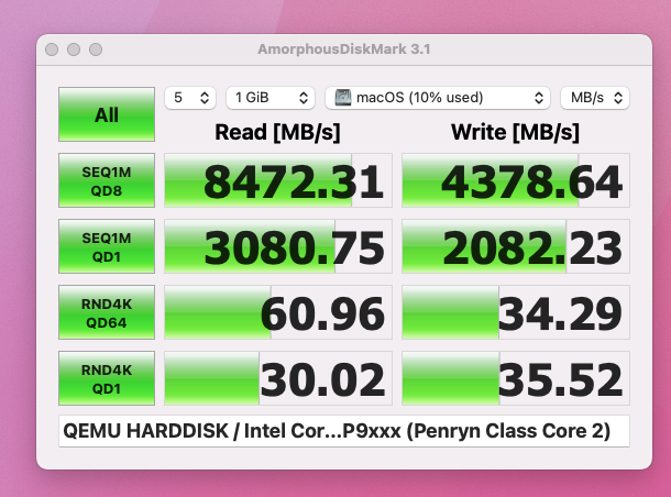

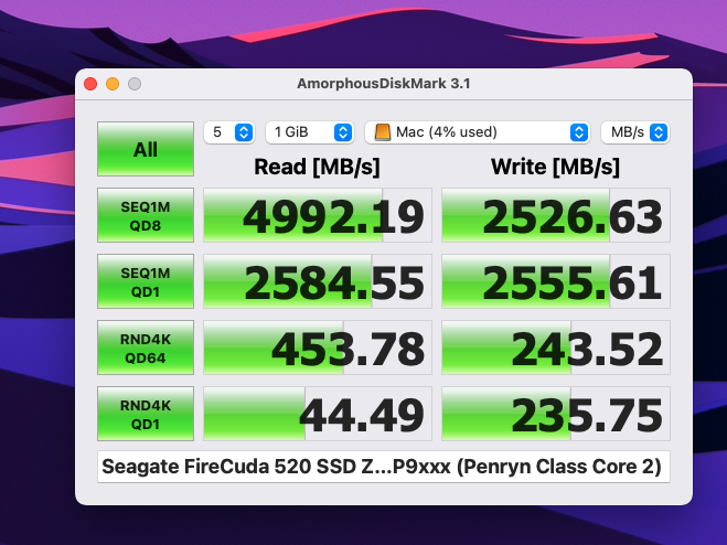

Disk performance is good and according to specs:
Comparison with vdisk on Raid0+1 (4x 960GB Corsair MP510 M.2 SSDs):
Great read and write, but random access to small files is much slower than through native SSD access.
1504370622_Bildschirmfoto2021-12-12um22_53_41.png.b137cd9b5a88e83210c0ebc921af0cdd.png
